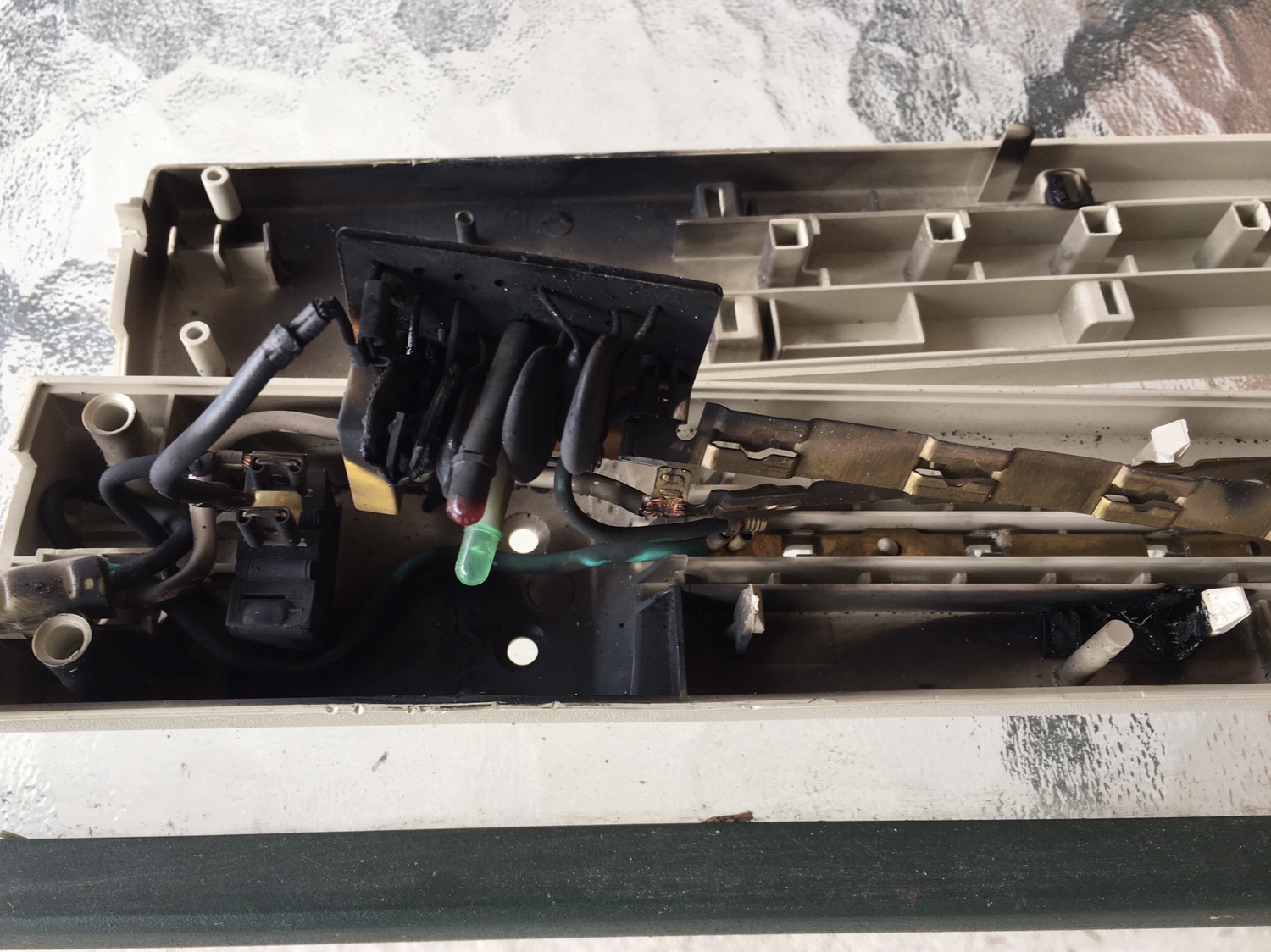

Quite the show Alan.... but not the one you wanted to see :eek: !
More proof these things run on Smoke !
I think it was daugen (or....) who posted some low cost plug-in Vac displays..... your pyrotechnics is a good example of why I should have them here by now....... good to have one sitting in the front of the generator, circumventing the need to get a DMM out....
Rgds, D.
Thats what happens when ya assume that all is ok. Never again.
Will check the generator next week to find the problem.
In the meantime I opened the surge suppressor to see what happened.
Think it will be ok if I blow it out and oil it.

The older .. pre 2008.... GENERAC whole house generators could have a failure on the voltage regulator and the gen will output 350 VAC.... and NOT turn the generator off. All whole house units after 2008 have prevention from excess or under voltage. It rarely happens, but can. When someone asks me if its worth fixing an older unit, this is the main reason I won’t do it.
Don’t want the liability. I am sure most if not every portable generator would not shut down on over voltage. I really doubt the circuitry is there. Ive seen my share of generators (mostly predators) that fail with one side of 240 circuit giving something like 200 volts and the other side giving 40 volts. Not sure what is occurring, and I never tore into one to find out. They make great boat anchors.
you let the magic smoke out

The older .. pre 2008.... GENERAC whole house generators could have a failure on the voltage regulator and the gen will output 350 VAC.... and NOT turn the generator off. All units after 2008 have prevention from excess or under voltage. It rarely happens, but can. When someone asks me if its worth fixing an older unit, this is the main reason I won’t do it.
That sure sounds familiar... Though with a portable 7000exl Generac. It was supplying over 300v , but fortunately I had very little damage. HVAC transformer and (2) TripLite surge protectors were taken out.
My electrician neighbor found a bad crimp connection on a wire coming from (?) the voltage regulator. I did get 17 years of light use out of the generator.

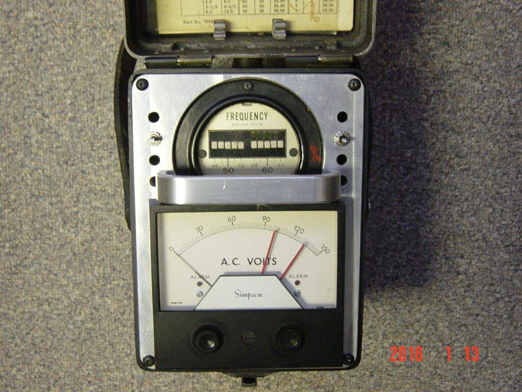

The Chinese simply Engineer a BACK DOOR into all their stuff to attack you at the worst possible moment.
I do like my home built, non-chinesium, analogue, no programming required, no batteries required voltage monitor and hi-low alarming thingie. Gives me peace of mind when running a generator, that some VR isn't having a nervous breakdown or something.
The only complaint I have is that if I tighten up the low voltage alarm setting too much, the water pump sets it off every time. Would be nice if a delay was incorporated in the meter.
