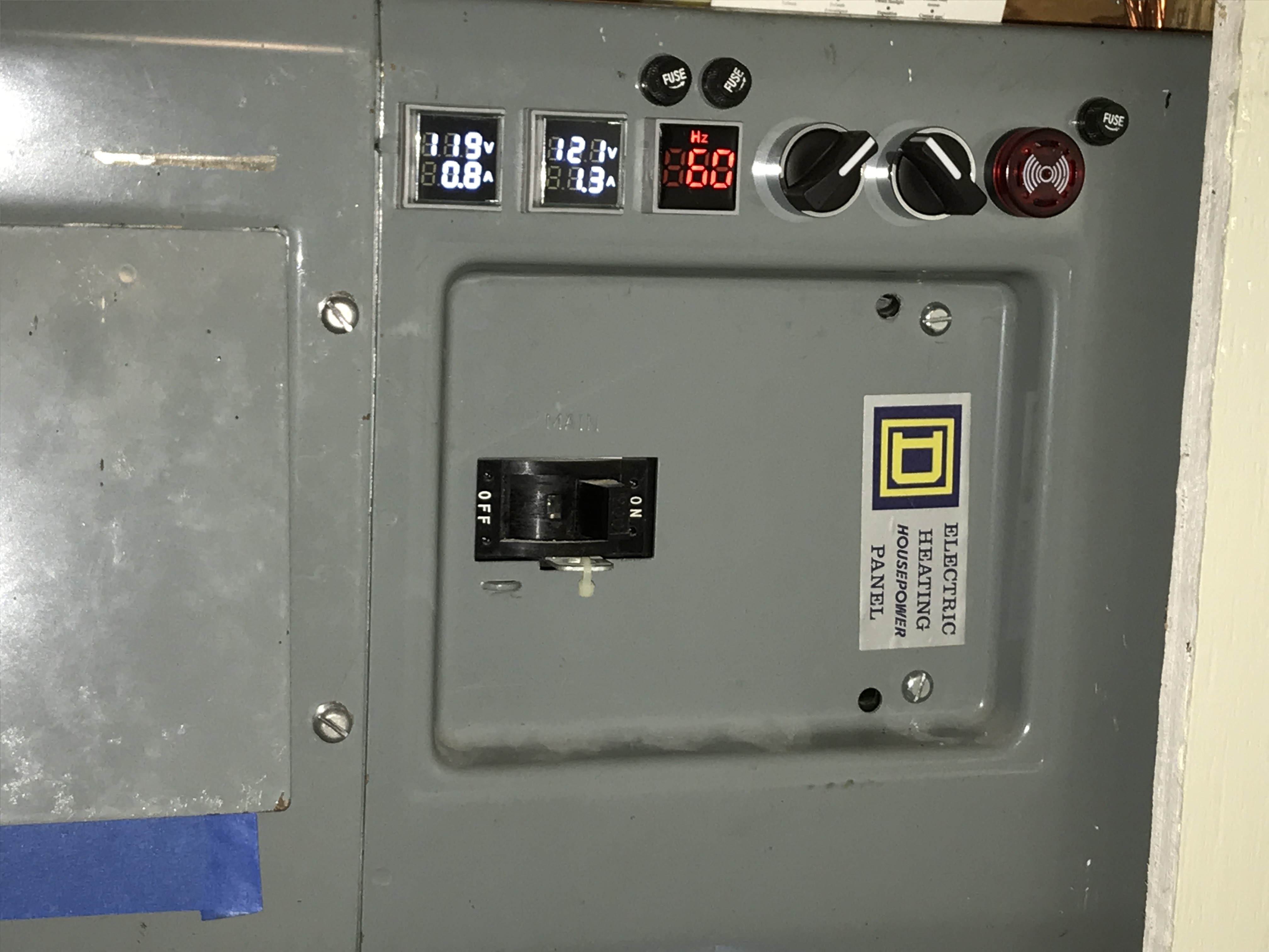

On another note... came across these mini meters on Amazon a couple weeks ago. They fit in a standard 7/8 hole and the A/V meters even came with their own current transformer. $12 for the freq meter and about $15 for the Amp/Volt meters.
Switches are to shut the voltage supply off. $15 doesn’t inspire the level of trust required to leave them on 24/7.
They came with zero instructions and a connector between the meter and CT so a word of warning for those that don’t know - never, ever pass current through a CT if it’s not connected to a meter.

There is a ton of neat, dirt cheap metering stuff available on E-Bay/China. I make sure I use appropriately low fusing on all of it. Not sure of the CT remark.
   / Your last generator Maintenance Run #5,048
CT’s will build unlimited voltage if they are open circuited with current passing though.
Most often they arc and melt but they can give you a nasty shock as the leads can easily reach thousands of volts with only a fraction of the rated current passing though them.
Ammeters are nearly zero resistance so normally no voltage is developed. These meters came with a plug in connector on the CTs which is quite unusual and may invite people to unplug them live. Also, there are no warnings whatever included with them. And yes, voltage inputs fused at 2/10 amp.
