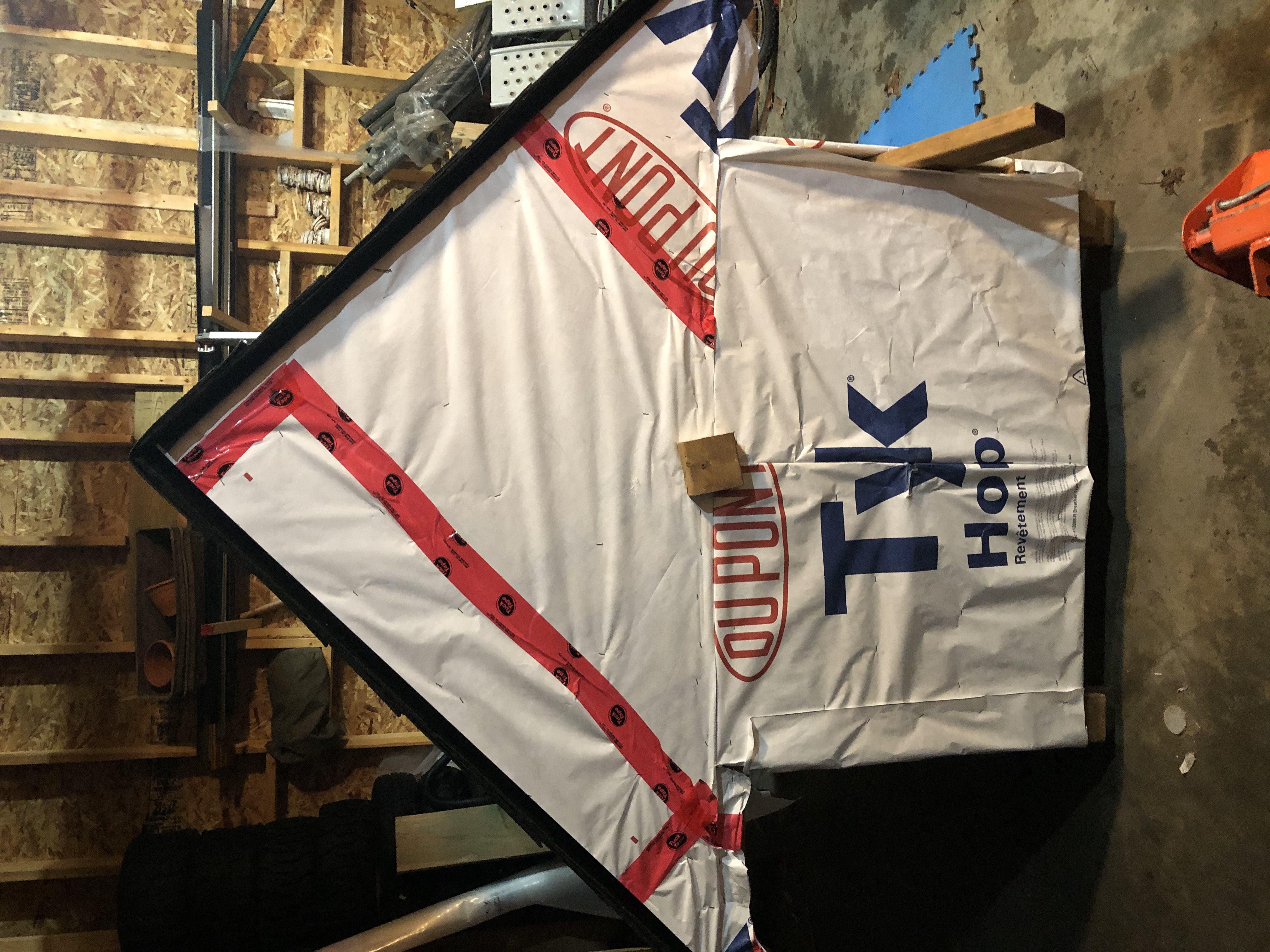

Same here. (Remember, I have the exact same generator.) Will look forward to hearing how is starts when you put gasoline in it. Meanwhile, here is another shot of the little shed we built for it.
Haven't run it on propane yet, but we did get a 100 propane bottle form Costco, and they filled it for only $40 (US)! Pretty cheap propane, and it will be good for about 40 hours of run time.
Tyvek ! There's a good northern shed for Ya ! :thumbsup:
How are you handling ventilation ? (Meaning Summer temps.....)
Rgds, D.
Ok, just kidding. Have a nice electric exhaust fan on the other end that plugs in to the generator, plus the side walls don’t go all the way up. That should be enough.
