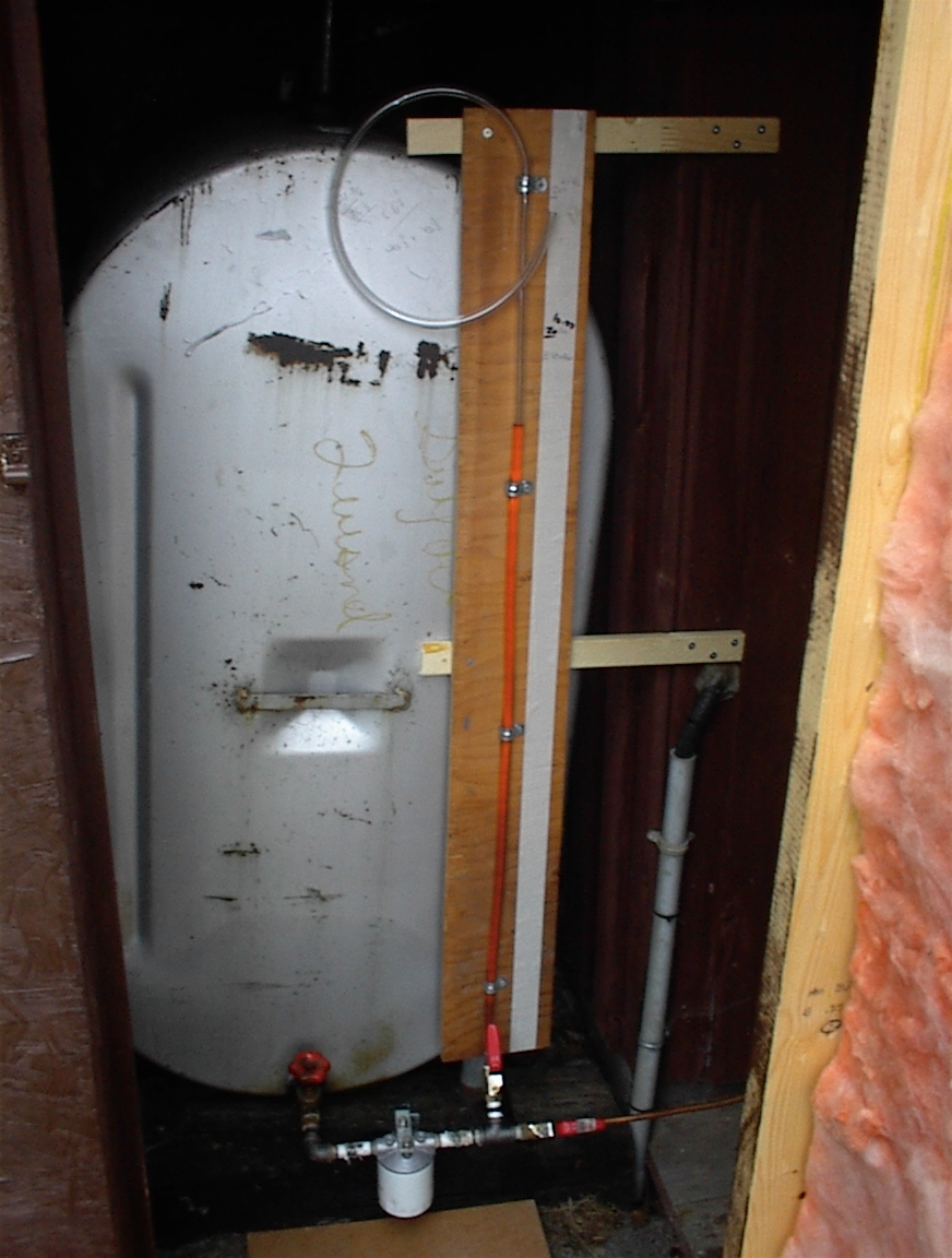

That's why I'm in a serious search for a 5KW and/or 10KW military surplus generator. Plus if I fill the two tanks on my tractor
attachment.php
I should have about 1,000 hours of run time on a 5KW :)
451536d1451004799-your-last-generator-maintenance-run-8x6sam_0422-jpg

That will make a great fuel reserve, I know doxford gets good runtime with something like one of those.
I've never been an All The Eggs in One Basket guy...... that's one of the reasons I like modern distributed power (alternative) generation - it's much harder to take down.
Post pics pls if you get either of those Mil surplus units, they'd be a nice choice.
