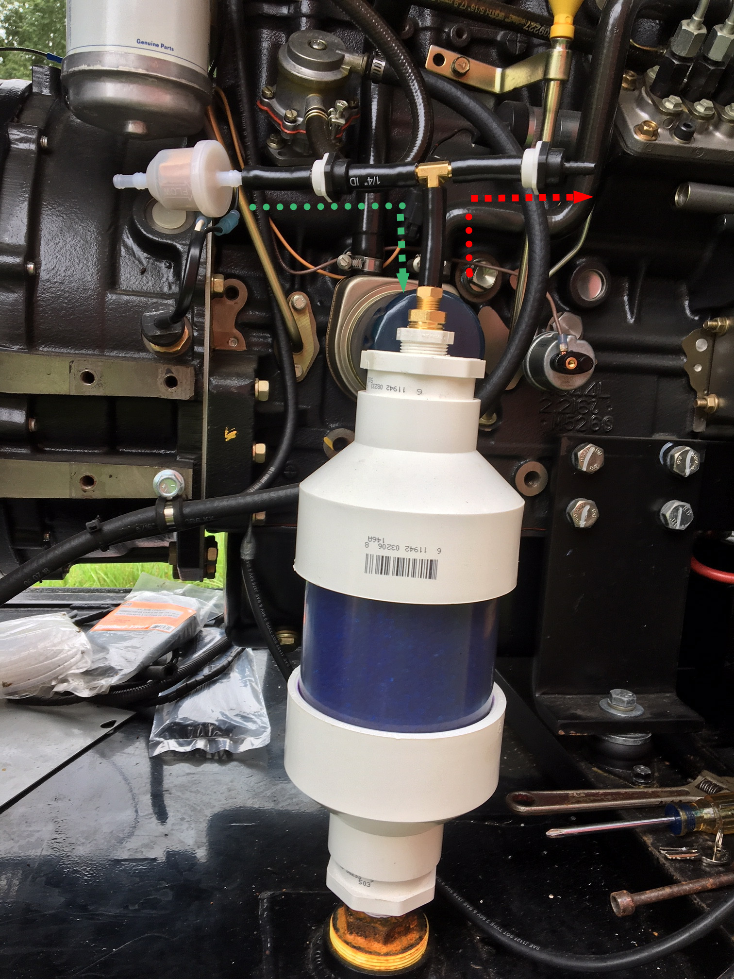

Here is Pic of a home made tank drier vent, that 2 lbs of silica gel inside that clear 4" pvc. on top are two check valves with a 1/4 lbs open rating. The top and bottom 2" reducers are not glued. Wiggle the unit out take inside remove the top pour crystal on cookie sheet heat in oven at 250 till blue again. Been on three months outside and still ok. About $70

Great design. Good value for anybody not living in Arizona or Osoyoos.
I've never bought drying crystals in bulk - where do you buy yours, and does it come in less that 50# bags ?
