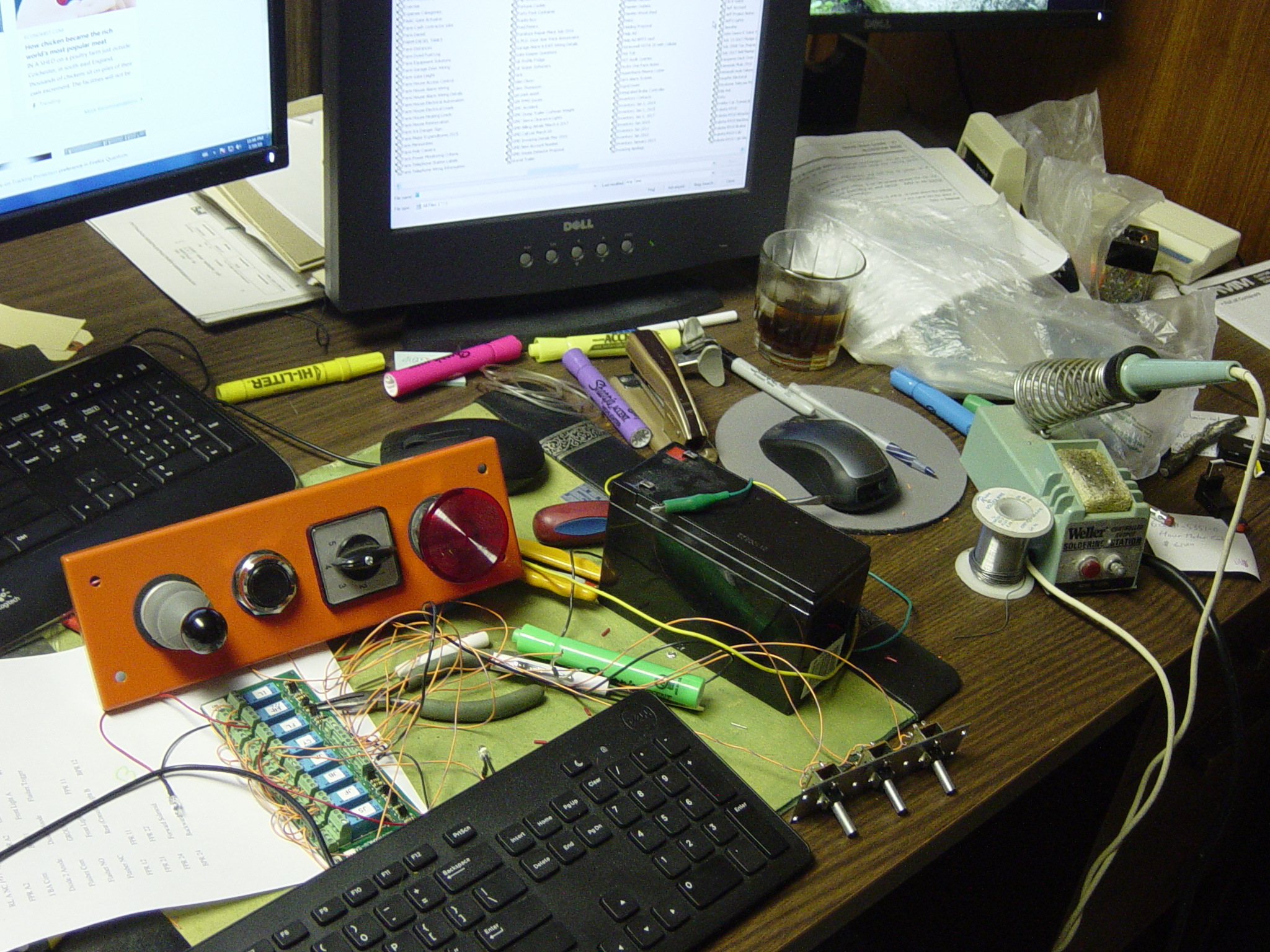

I have several WTCP stations. Used that model of iron since the 70s! I also use a Weller gun when I get lazy or work with bigger wire.
I overdo everything and probably just apply too much heat and solder, then shaking off the excess! Really no excuse, I have probably made millions of solder joints! GLAD I bought a dozen or so rolls of lead solder at Dayton years ago that should last me til I die.
Good old Weller, Station. Old style. I remember my first boss took that silicone cord and wrapped it around the HOT iron, to see my reaction. QUALITY! That thing is 40 years old!
