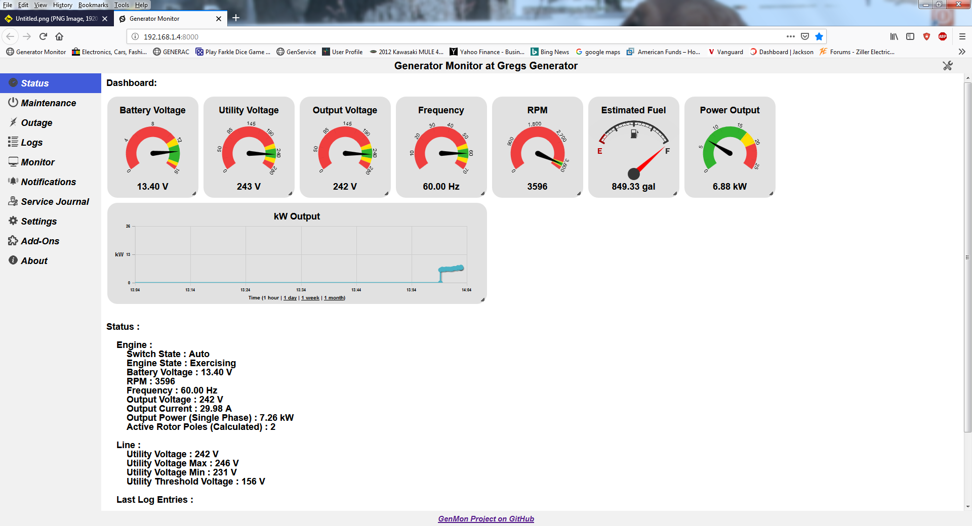

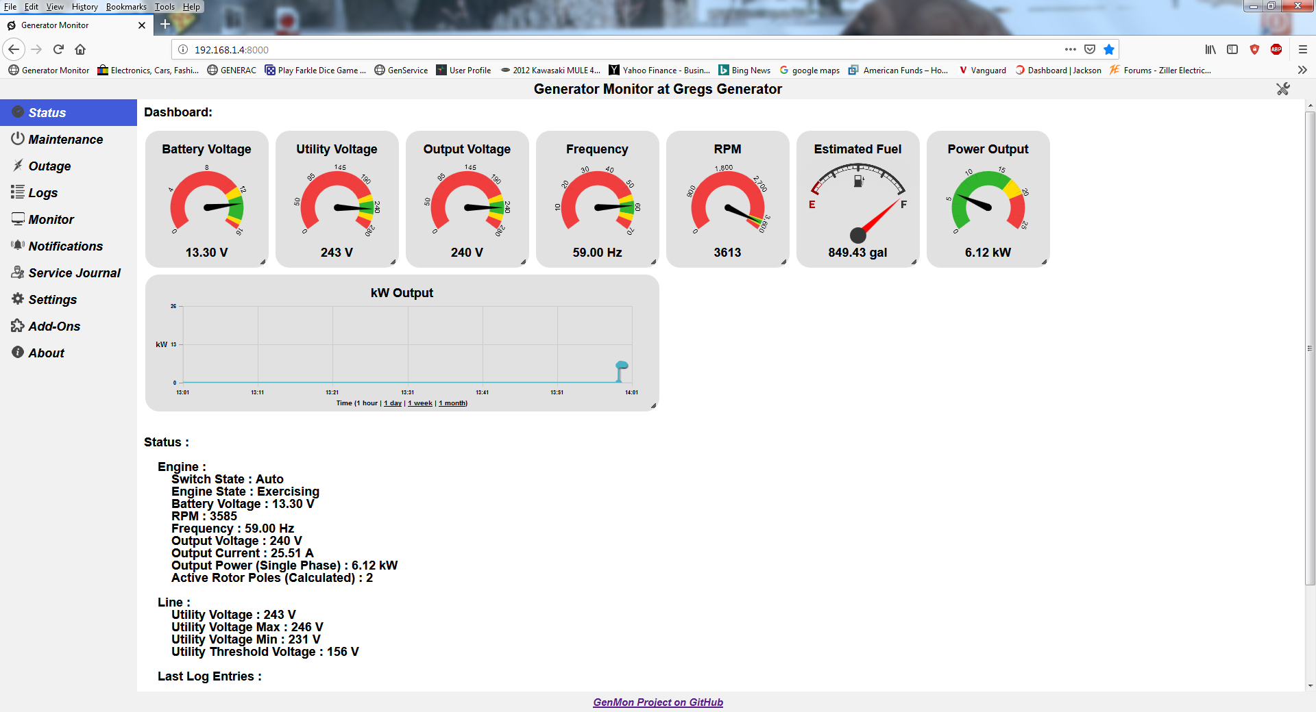

while i was typing the above, my generator started its 2pm exercise . The generator emailed me to tell me its running. I checked it on the computer Untitled.png Untitled.png

Been pre-occupied with various things this week..... came back here to find a whole slew of excellent detailed posts....... soft-start, shedding.... good stuff !
Liking those screen shots grs !
