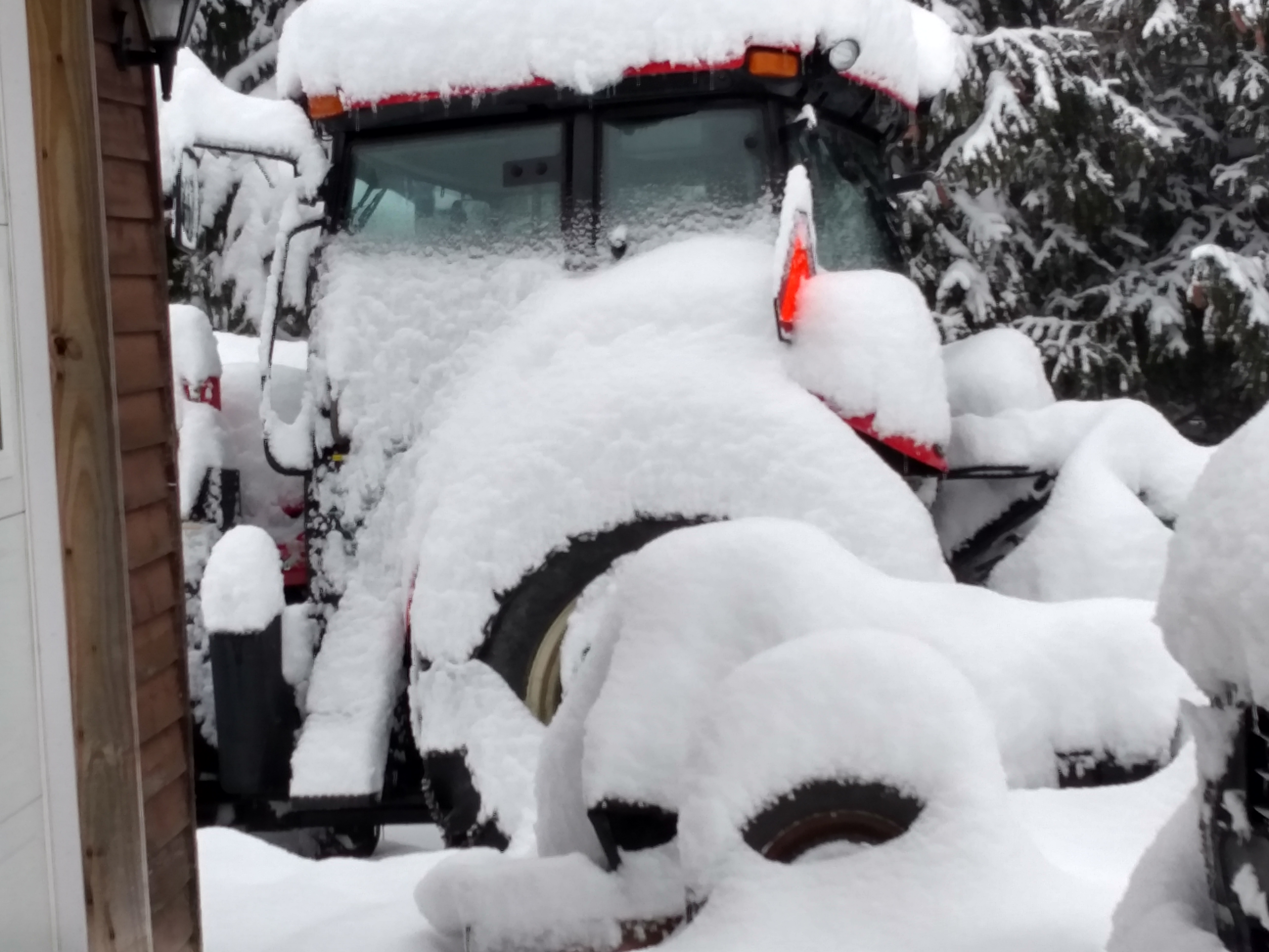

I have my pto unit mounted on a trailer setup.
During the winter it is parked right where I would need it with a piece of heavy plastic
providing weather protection.
Back up hook up the pto, hook up the power cable,
engage the pto, bring the rpm up throw the switch.
As seen and then needing to be broomed off to be used.

Isn't winter fun?
I have never seen tire chains that perfect.

Lou, nice setup. I could not hook up that pto shaft in cold weather, no way it would go on for me...
Everything seems harder in the cold and ice.

I pull the pto shaft apart and clean the grease off in the fall,
and lube it with various spray lubes makes the shaft much easier to
extend and retract, doose the coupler with the same.
Then repeat in the spring with grease.
Those chains go on quite well and I have had some practice putting them on,
2 to 6 sets once or twice a year, a couple of sets several times a year.
