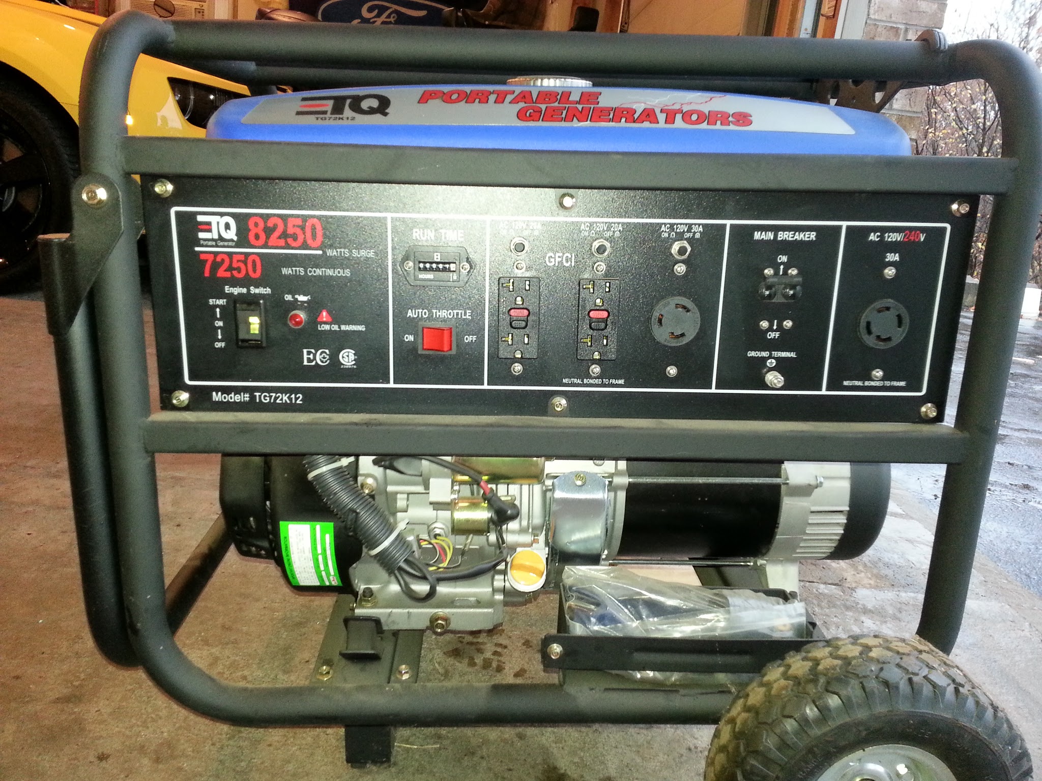

I have an old Northern Tool or Sportsmans Guide sourced ETQ 7250/8250 generator. I did let it rest a couple years and lost the carb, I could not clean it and get it going again so I bought a reasonable copy carburetor from Amazon and that did the trick. It does now run as expected.
So, while it is 10 years or so old with 5 hours of run time on it, should I take a look at the engine valve clearances? Issue being... what should they be clearanced to? It's not like I have a Honda, Kohler or other engine that I can look up specs on.
I also do have Amsoil in the crank case, but I bet that oil is also 10 years old. The generator sits in my heated/cooled shop, so it doesn't ever see hot cold variations, but even at that I think it may finally be time to spend $10 on an oil change.
So the question in my ramblings... WTF clearances do I check/adjust the engine valves for being that I do not have any sort of service manual for a machine that was discontinued years and years ago?
I did have an electrician create a 40' long cord to tie this in to my panel after I cut the main breaker, and he made a pass through to the outside garage wall that has a weather tight box that I would open and plug this generator in to with his cable, so in the winter if I were to drop power from the street service, I could run all essential household services with this.... as long as I keep the rug rats away from TV's and video games.
