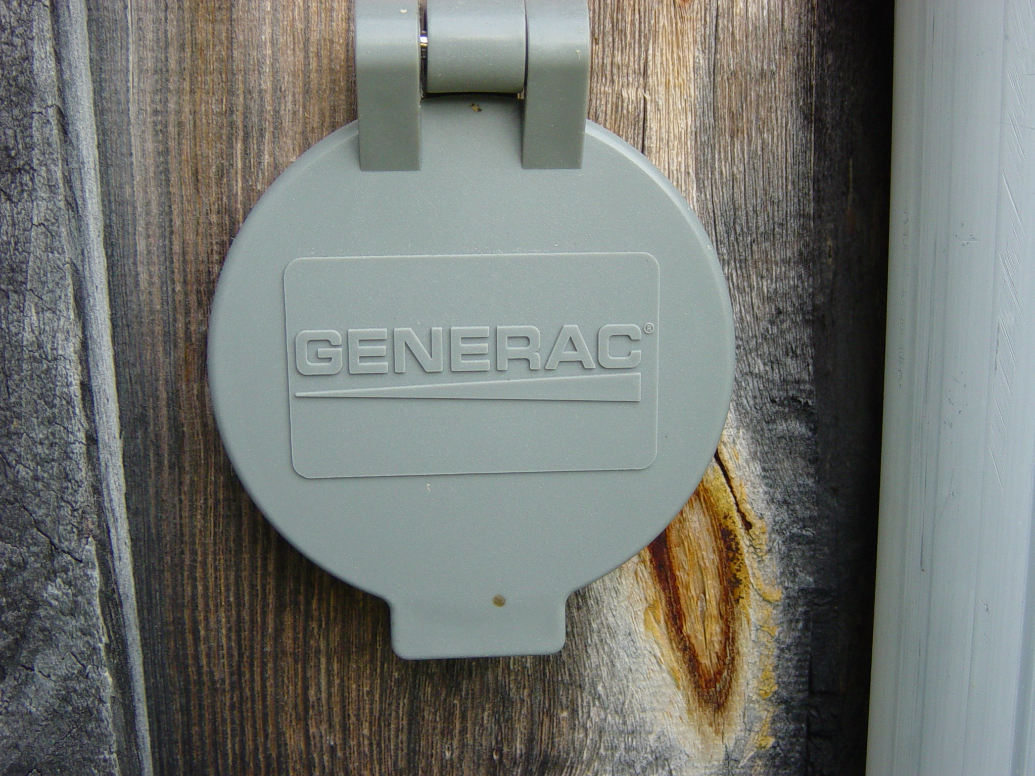

I guss you've probably seen these before.
Amazon.com: JR Products 541-2-A Polar White Deluxe Round Electric Cable Hatch with Back: Automotive
   / Your last generator Maintenance Run #1,698
   / Your last generator Maintenance Run #1,699

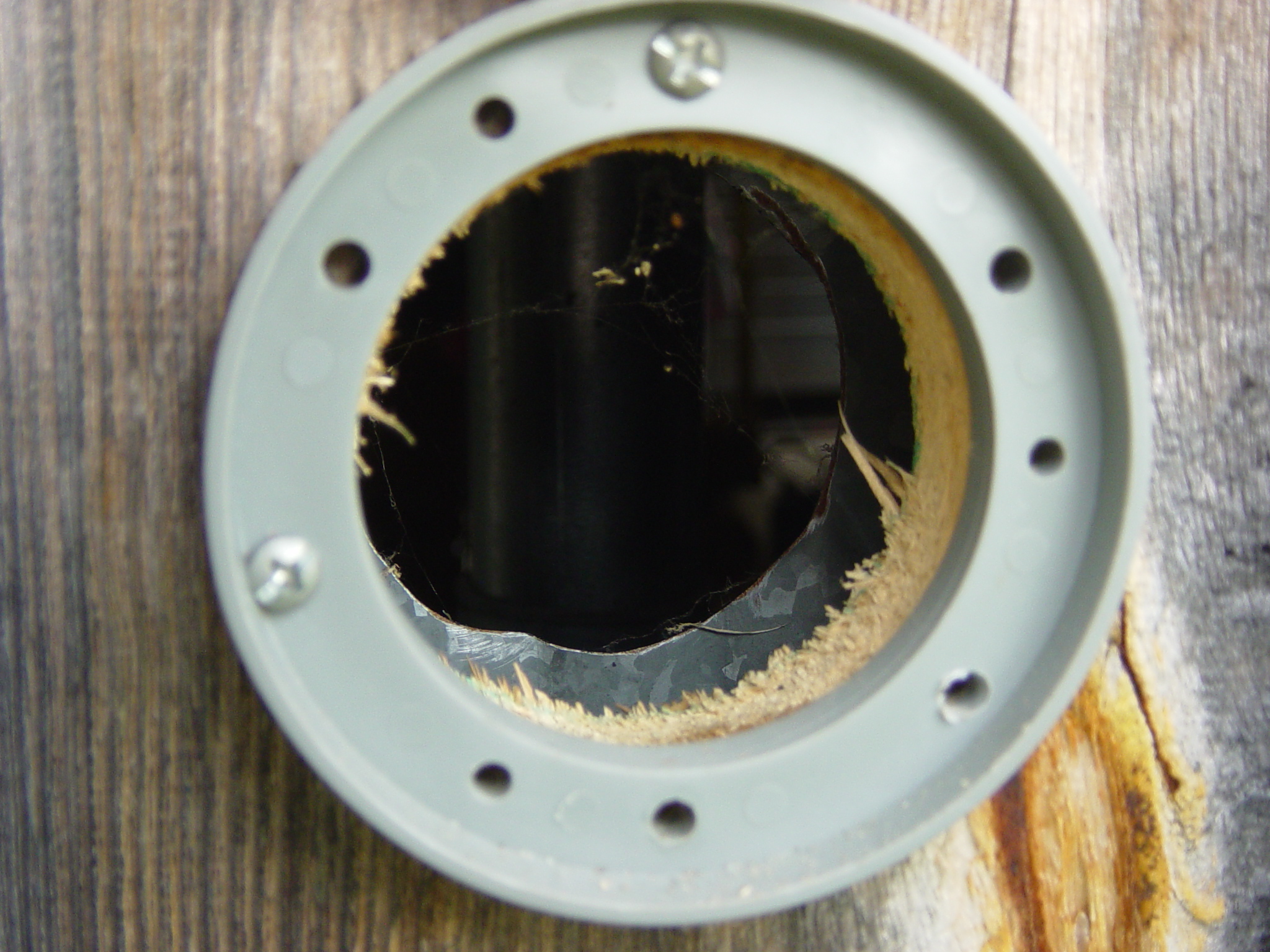

I could not resist buying a few of these from the RESTORE for a buck or two. Home Depot Returns.
They can accomodate a twist lock plug. They are great for a generator, block heater, battery charger, or X-MAS lights. No need to have an outlet outside and you can have control modules safely inside.
They are compact and attractive (I think).
I have not used them on an insulated wall but you could put one on each side and put a pvc pipe between them. Fill it with insulation when not in use.
