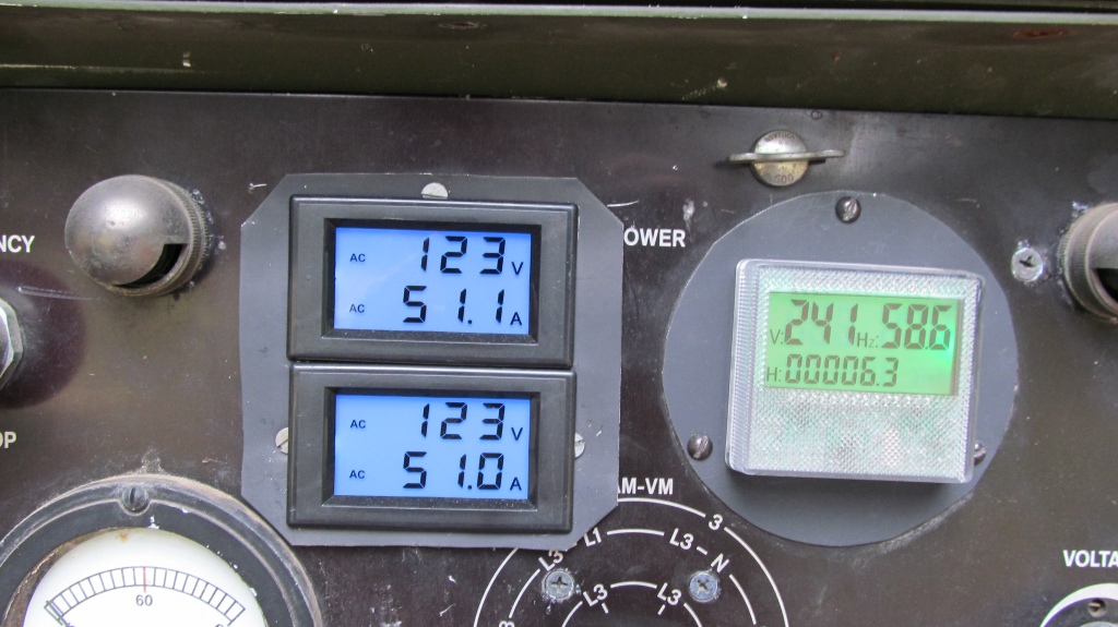

Have a reminder set in my phone calendar to check and run the generator under load and change the home AC filter on the third Sunday of every month. My test was due and done last Sunday morning then the power went off for 4 hours that afternoon. Had another power outage yesterday. Not sure how long that one lasted because we had somewhere to go. I ran the generator another 3+ hours then shut it down to go to dinner with family. Power was back on when we came home 4 hours later.
My old surplus diesel unit had a bunch of bad gauges so I replaced them with digital and added a volt/amp meter on each line. The combo generator meter I added is off a few volts on the total but the hertz is accurate which was what I needed from that one. The volt/amp meters match dead on with my Fluke.

JD855, love the gauges. Am always looking for numbers not lights.

That's a sweet diesel you have there. As much as I like analog, it's hard to beat the low-cost compact footprint of these drop in digital ones.
For indicators, as long as the offset is consistent, no harm/foul in my books...... esp. at this price level.
