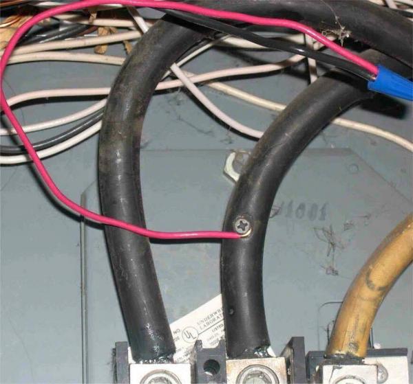

a little off subject....but one needs to admire the homeowner at work on their own electrical system. this was a photo from another website. he needed 110...i guess this is one way to do it
   / Your last generator Maintenance Run #1,517
   / Your last generator Maintenance Run #1,518
The only time I come across this is people stealing electricity...
Either from the power company bypassing the meter or from another unit in a multifamily building.
   / Your last generator Maintenance Run #1,520
that might even be called risking a catastrophe by your homeowners insurer and they would say so sorry when it all burned...
they'll cover most stupid things but this is pretty bad.
