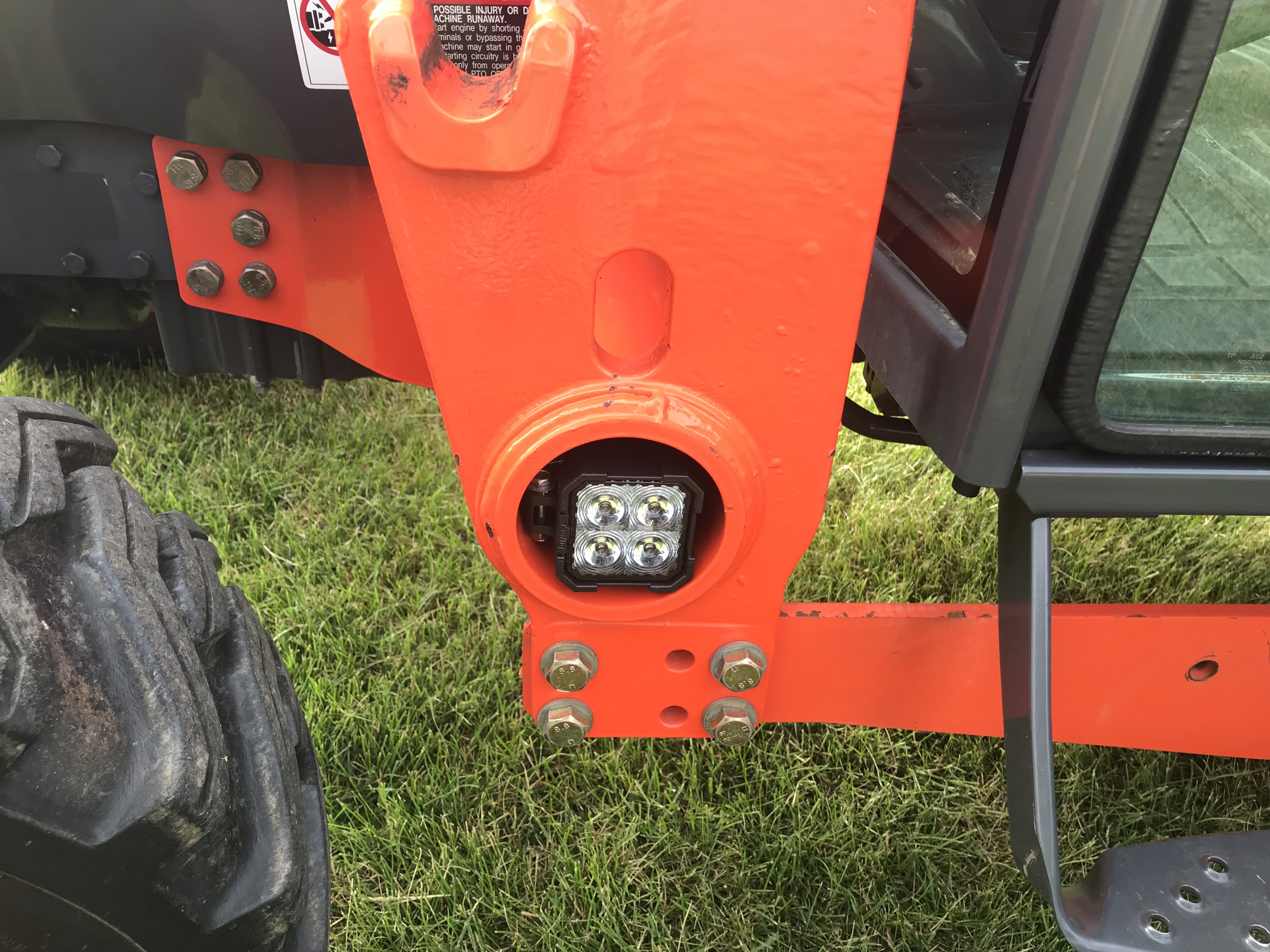

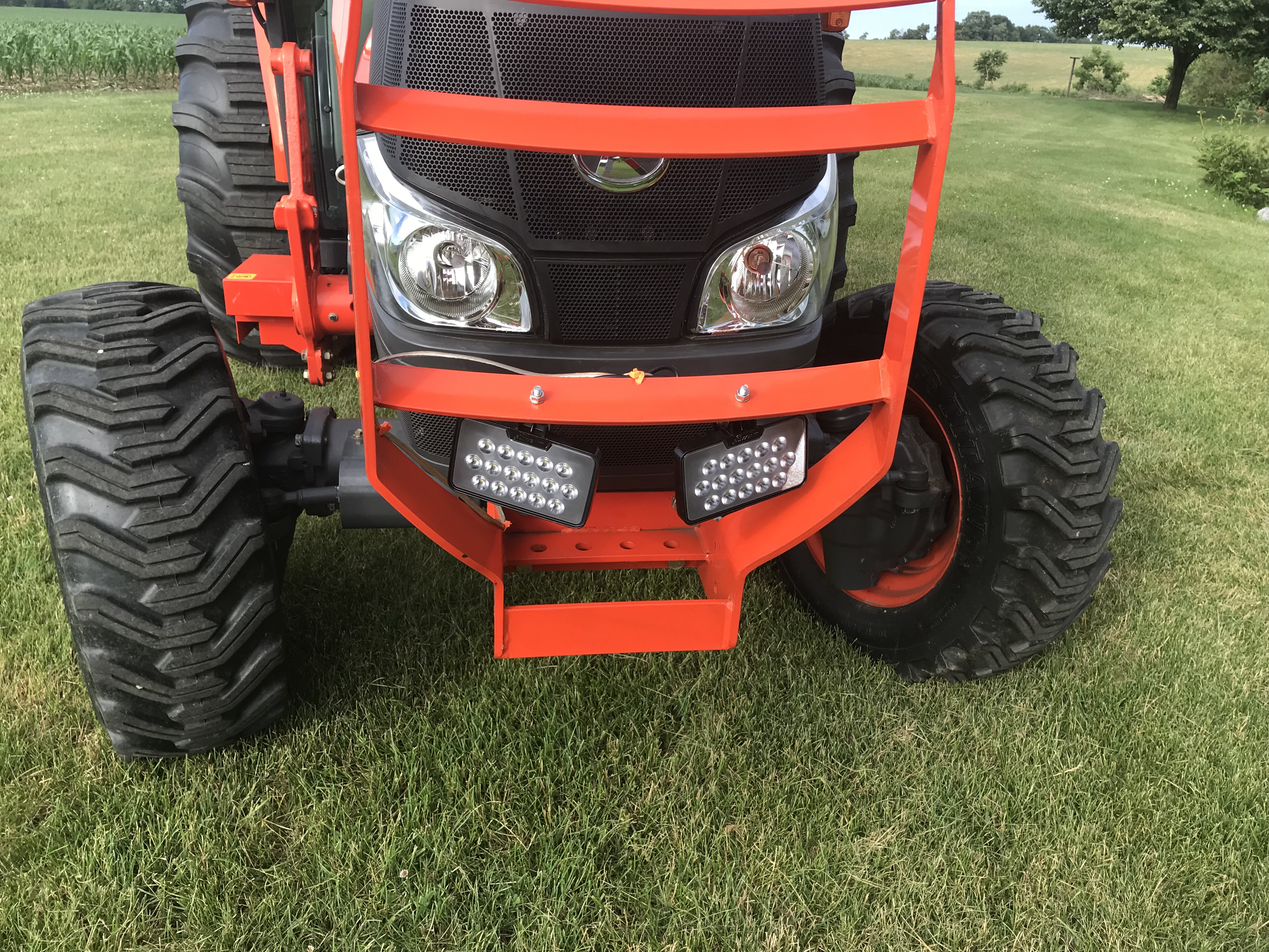

Found a fix for the problem with seeing the cut / uncut grass. I left the front factory work lights as-is for now, and mounted two Maxximas low in the grill guard. The lower mount throws the light at the grass that makes it easy to see (like wavy vinyl siding when the sun is at a certain place. Rears were mounted high where the factory rear work lights would be.
Both the front and rear lights are angled out as far as they will go and still light up the areas directly in front and behind the tractor. When I mowed Tuesday night there was an area to each side that wasn't lit enough to see where to turn into the uncut grass. One more light on each side fixed that.
I cut the wires to the high beam part of the headlights and used it for the low front and side work lights. The rear work lights use factory wiring that was in place. I did need to add the switch in one of the blank switch holes.

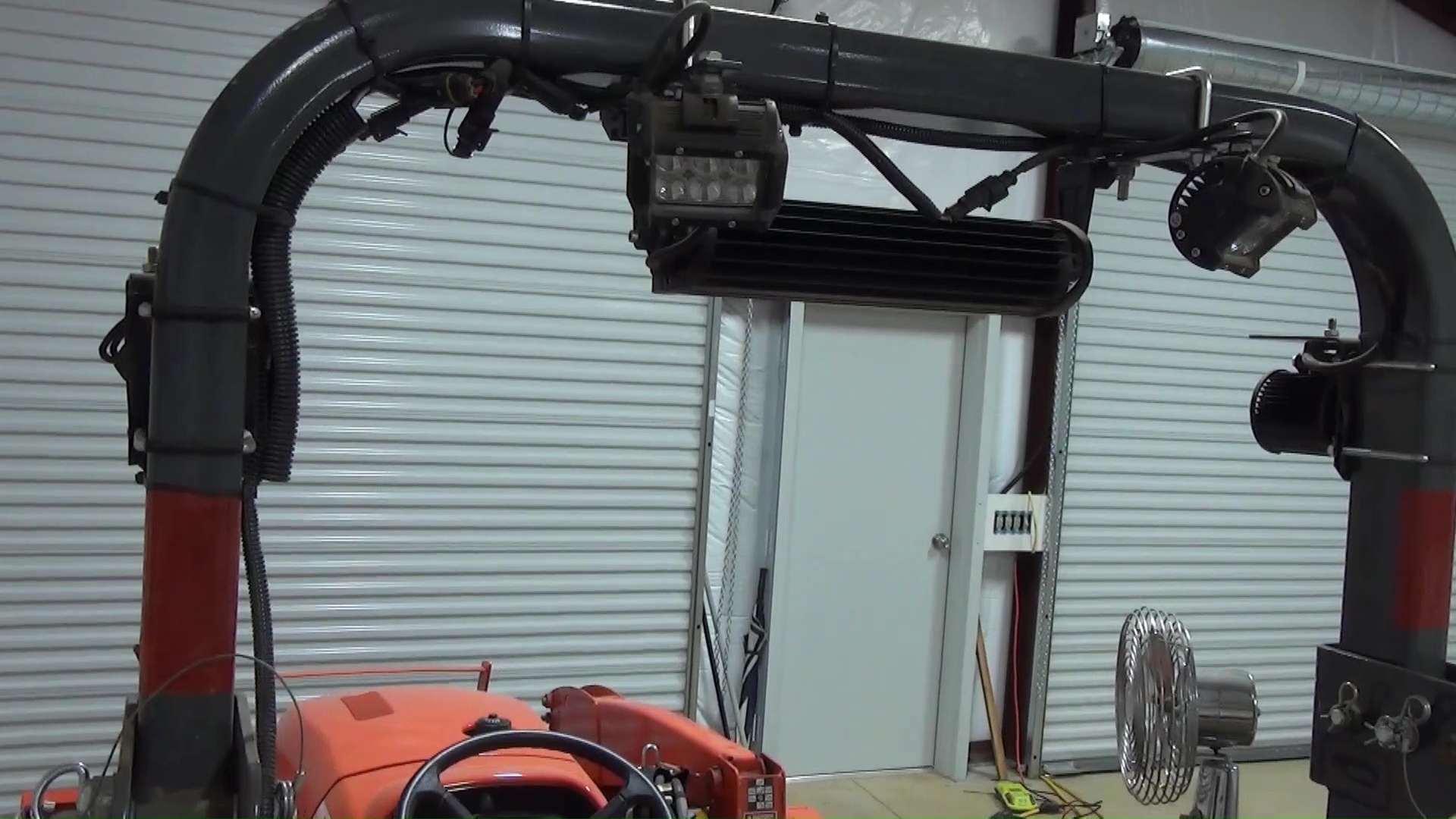

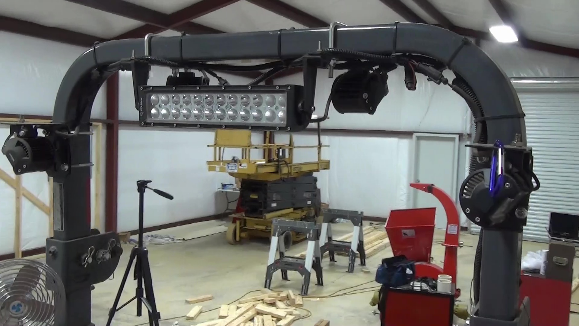

If you are looking for something to supplement your tractor headlights, I recommend you consider light bars with a mix of spot and flood. The reason is the spot light portion gives you good distance coverage while the floods illuminate a wider area. For instance, I used a combo light bar facing forward on the ROPS, plus two small flood light cubes to either side for side vision and two small flood light cubes on the rear. This combination gives me a 360 degree view when working on the tractor at night. It works really well.
Here's a couple of pictures of my setup:
And here's a video I made covering the specifics of the choice of lights, attaching to the ROPS, wiring, and a night time demo:
I like how you mounted the side lights inside the FEL tower supports! Clever! Looks like you get good light coverage.
