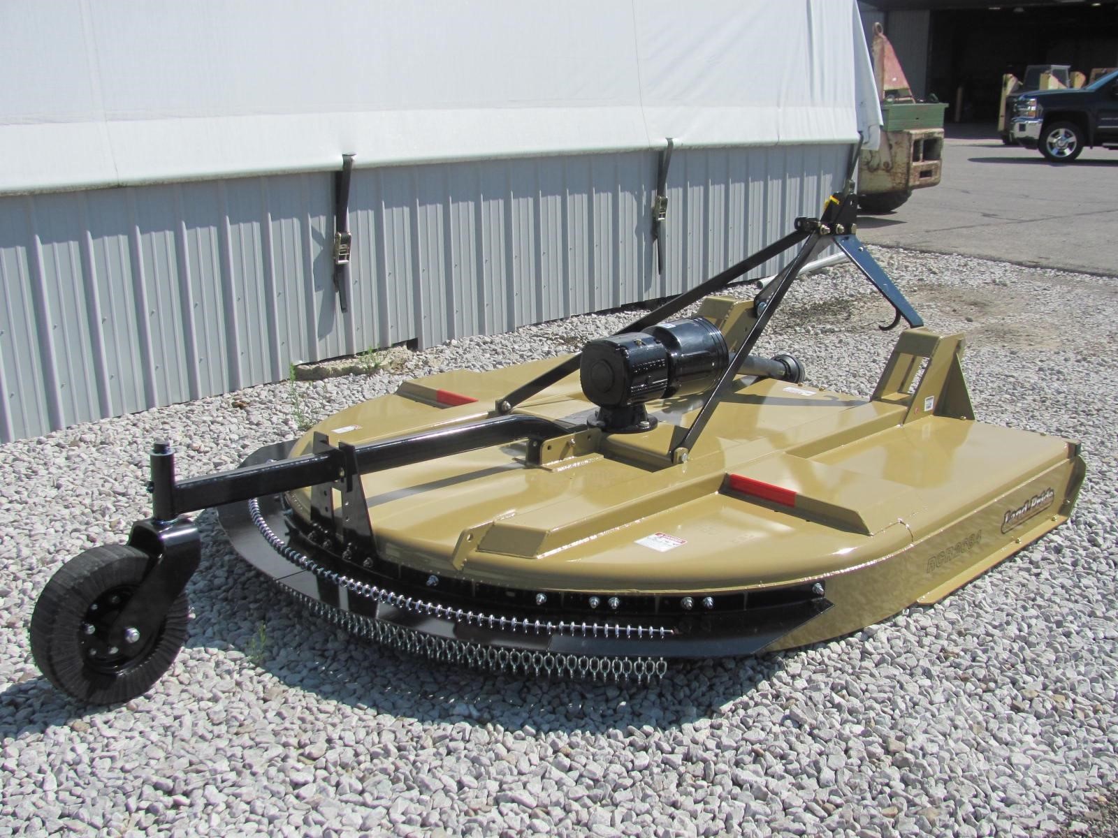

I also liked Land prides tailwheel design that they dropped like pictured. To me it held up better than the Y designed ones as it was thicker material and wouldnt bend as easily Also it let me back up very close to posts or trees to cut. RCR cutter.jpg

There are several comments about bearings on the tail wheel. I don't have a problem with the simple (no bearing) design that most have today. I think the real problem is the spindle and the wheel axle collect grass and it binds the wheel and spindle. I think the same would happen even with good bearings. How about a tail wheel design that doesn't collect grass and weeds, by shielding the axle and spindle?
