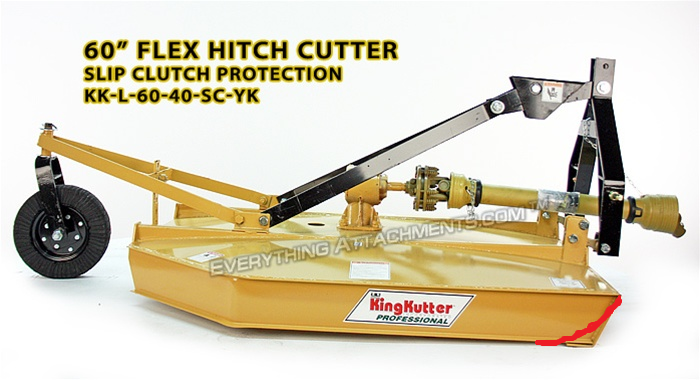

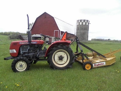

I like the new Kingkutter design that has a smooth rounded top that sheds water if stored outside. I think most rotary cutters have too steep of an angle on their front skids that dig in on uneven terrain. My first tractor had a short wheelbase, so the skids were digging in all the time. I added guide wheels and they made a huge difference. A more shallow angle to the skids would also work. Better yet if it was a radius rather than a straight angle.
Domed Top, Flex Hitch, Proposed Shallow Radius Skids (in red)

Not sure if I follow this, and I don't mean to sound argumentative. I see how the tops can get pushed aside by the round back , but isn't their stalk/trunk either in the (round) blade path or it isn't, regardless of the shape of the mower?
Not argumentative at all.
The round back pushes the long stalks sideways and down until the stalks get pinned down under the side rails. Since my plane of blade rotation is higher than the bottom rim of the cutter's shroud, the blades pass above the stalks.
