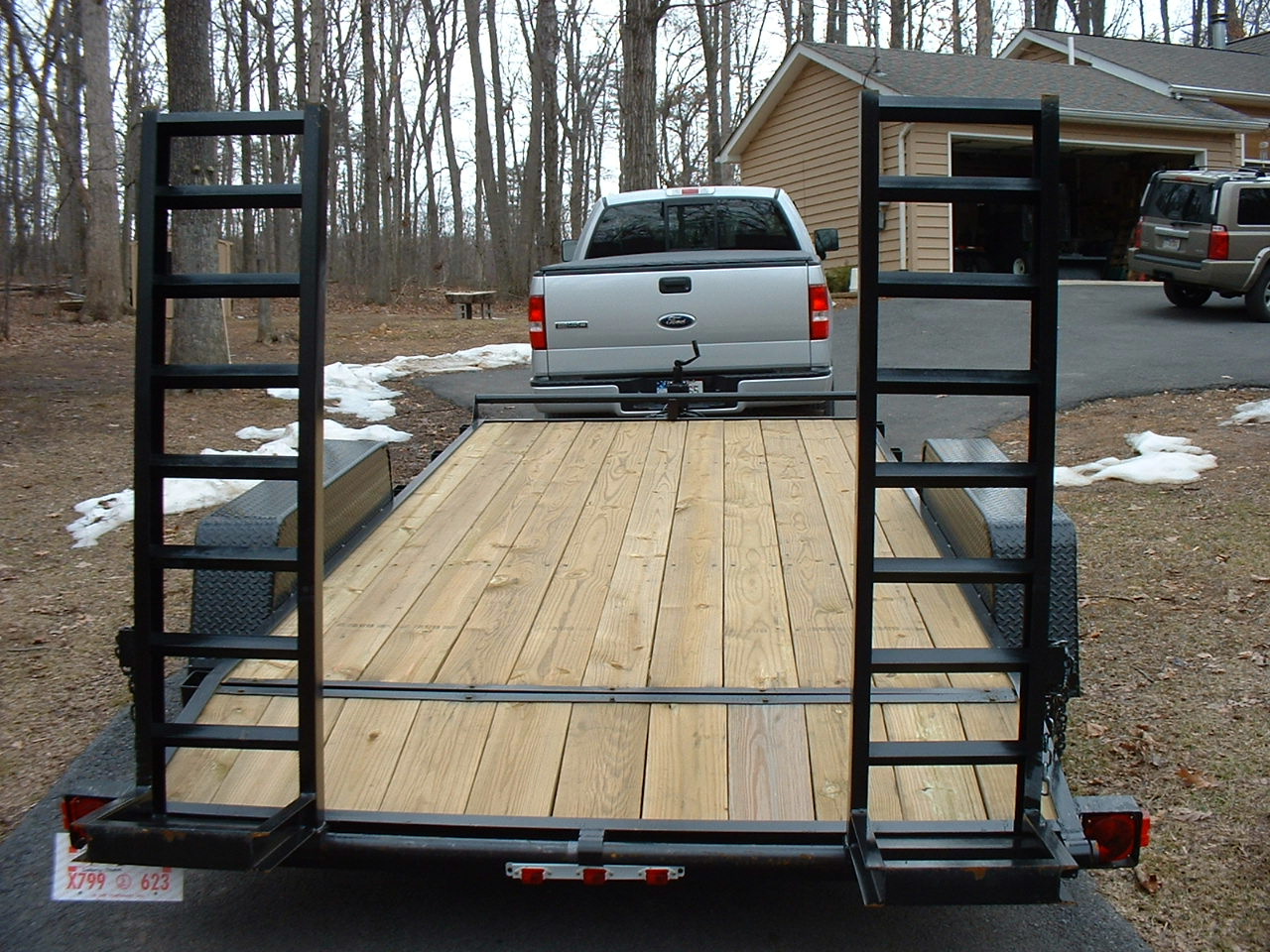

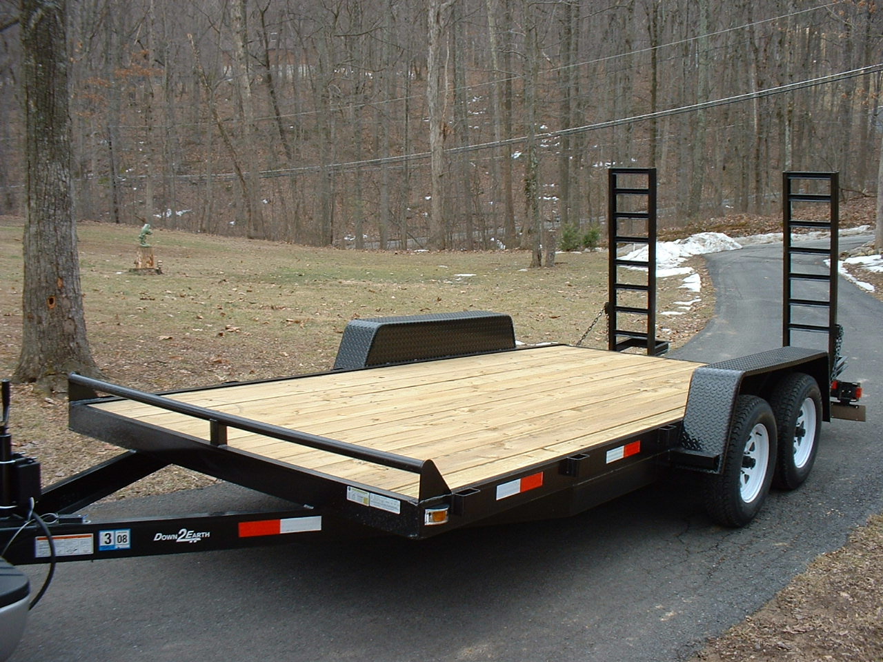

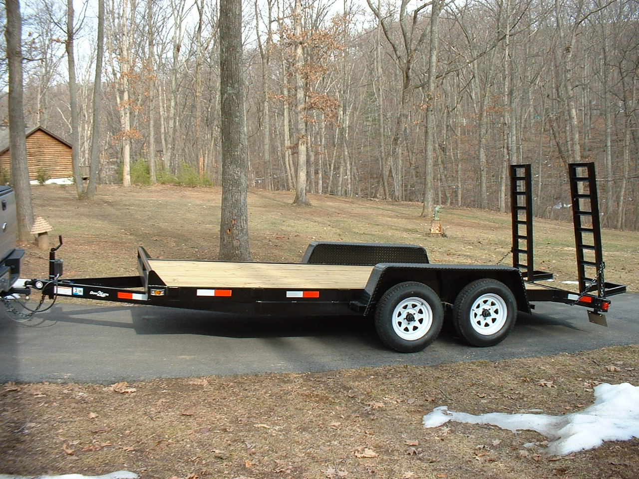

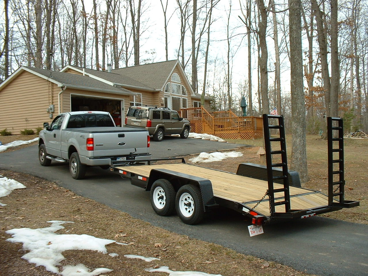

Well ended up buying the 16 Ft Car trailer. I drove it home today. Here's a few pic's along with my Very Dirty Truck, from all of the mud around here. It was very tight getting it back here.
I know I'm really going to have a hard time if I meet a large truck coming the other way. Seems the problem is going around corners the back end is still out in the road until I can straighten it out. I barley get past the cars. I don't think buying the 14 ft would have made to much difference.
I had no tracking problems even at 70 miles and hour with wheel hop or sway, but the real test will be with a load onboard. So I'll have to wait until I can load up and test it out. I May end up taking Kent’s advise always better safe than sorry. Kent what might we be talking about price wise for the Weight distributing hitch?

That's a nice looking trailer. With 12" sideboards, it should be very versatile for you, and haul everything you need to haul.
A decent weight-distributing hitch should cost you no more than $300-350... There's more expensive ones out there, but I bought the 8000 lb version of this hitch (Hidden Hitch brand, American made in Michigan) when it was on sale for $249.95 with free shipping.
