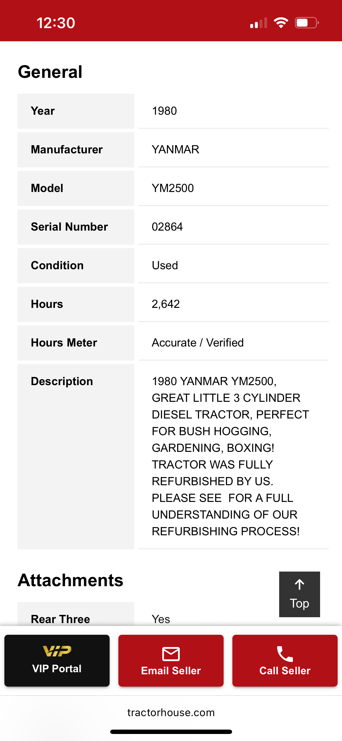

Per the Fredricks UTDA agreement with Yanmar, they serialize the tractors on an ID plate riveted to the hood. I see the auction had S/N 2642. Are you saying you now own 2642 then.
Here is mine, 3661
I now wonder even more. Your machine has a lower S/N than mine. Did Fredricks do a buy back or help a customer trade up to another machine and took the YM2500 as a trade-in?
So much speculation on this S/N 2642 . . .
2,642 is the Hours on the hour meter of the tractor at the time of the auction, not the tractor’s Serial Number.

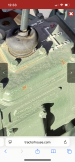

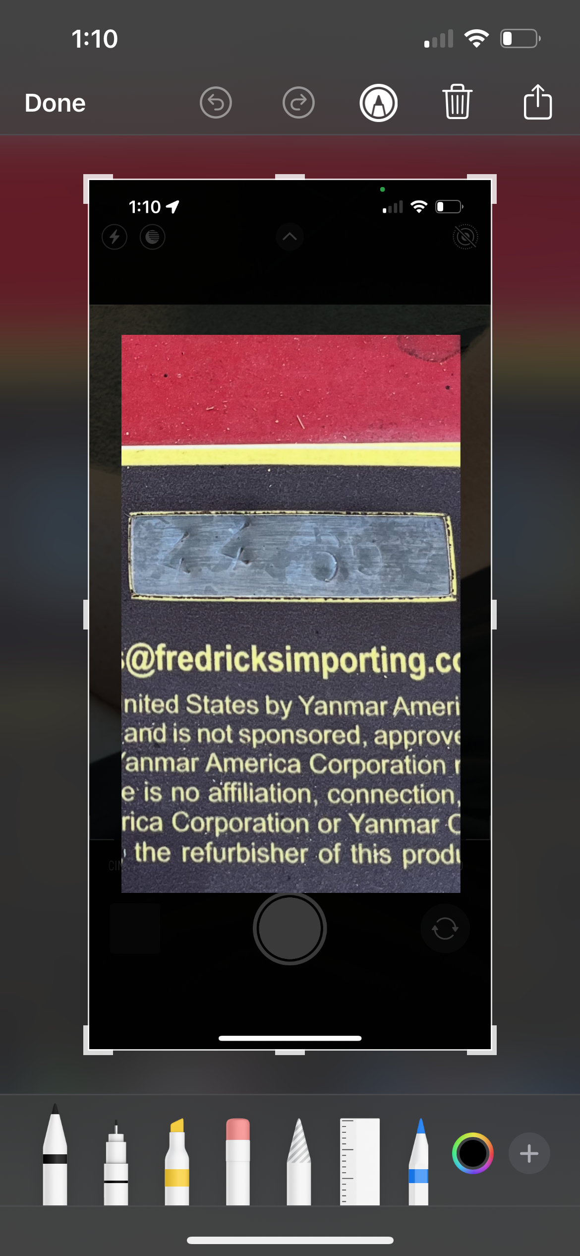

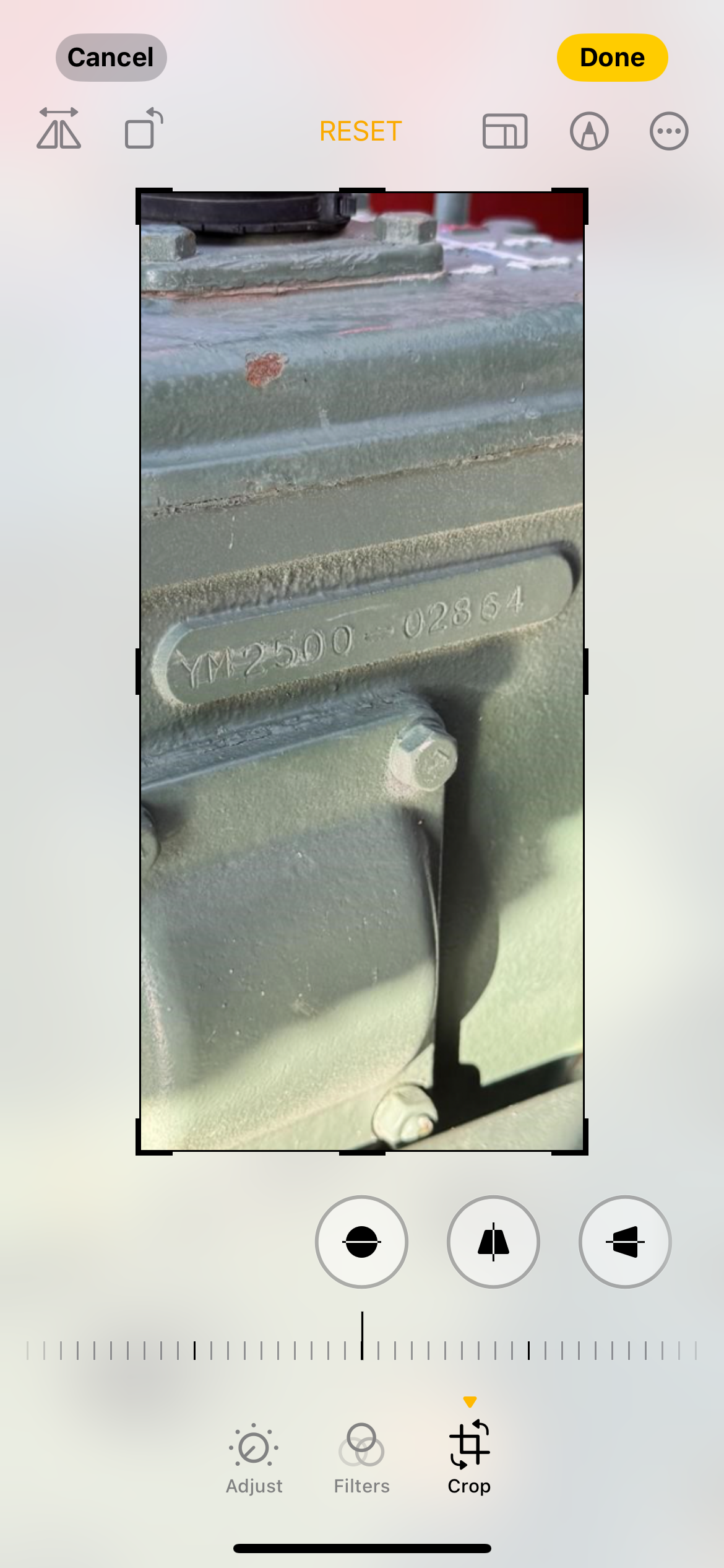

Here is a better picture of the numbers on the Transmission, and the Serial Number used in the auction on TractorHouse, which is an exact match of 02864.
The UTDA ā€œFredricks Importingā€ Tag Serial Number attached to the hood is 4465, but is difficult to see in the picture.
