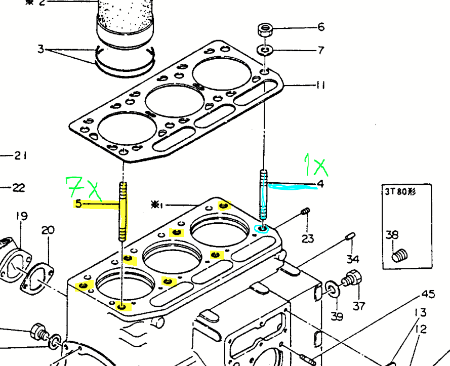

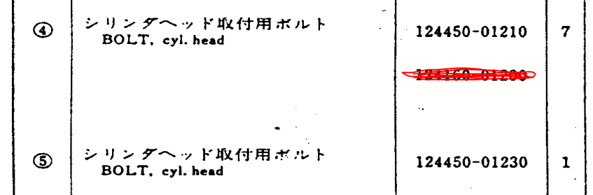

I'm showing Fredricks YM1500,2500,2610. HBN-4300 Nut, Head bolt and
HBW-3338 Washer only those 3 models also. You can see how unusual they are.

Travis, did you save the old bolts. I recall you were going to measure them for length and thread diameter awhile ago.
The reasoning was, you can nearly order these off McMaster-Carr as NEW.
124450-01230 1x
Length: 156 mm
Outer Diameter: 20 mm
Possible M20 thread ?
This might work as a new replacement. Shy of 3mm (1/8-inch) each end.
124450-01210 7x
Length: 138.50 mm
