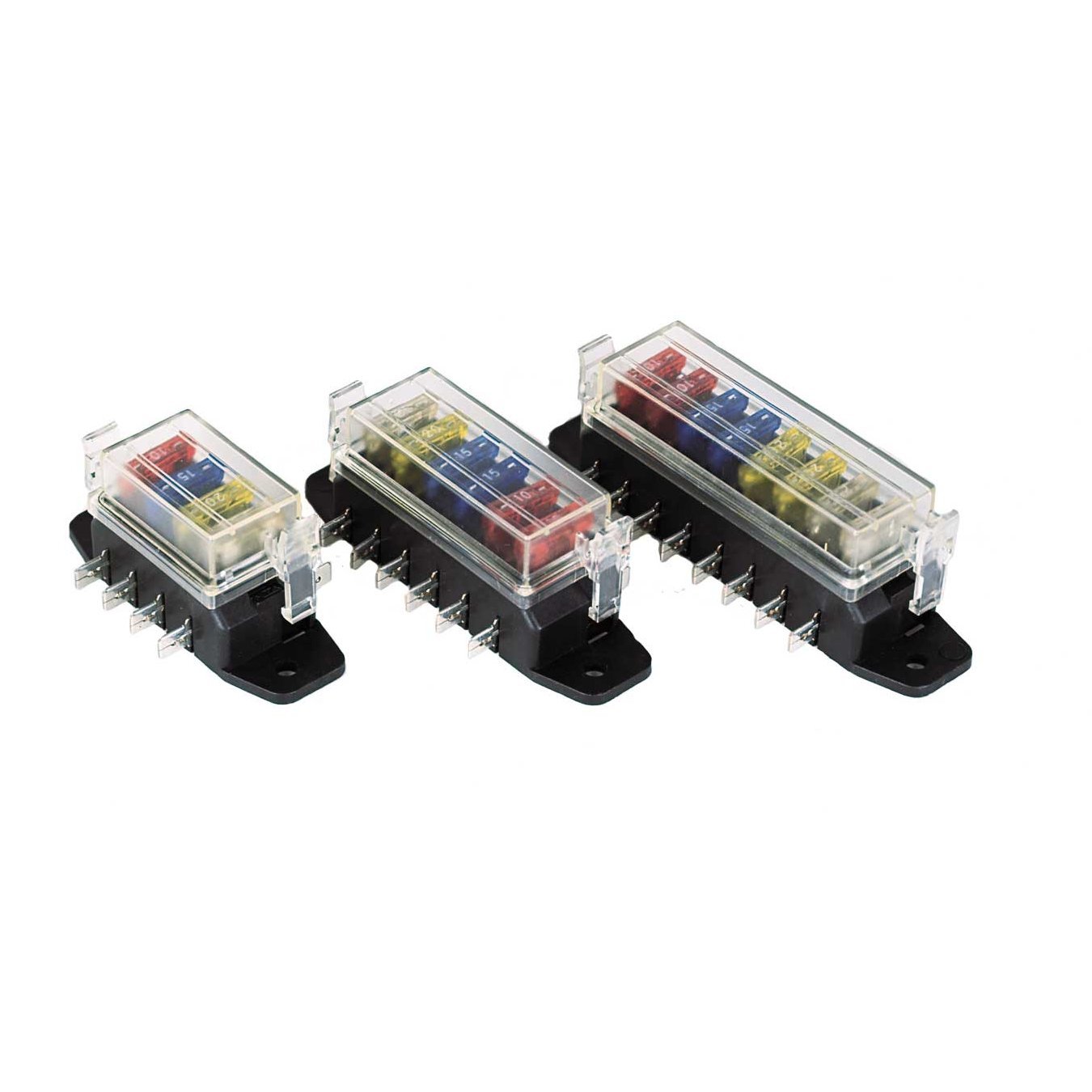

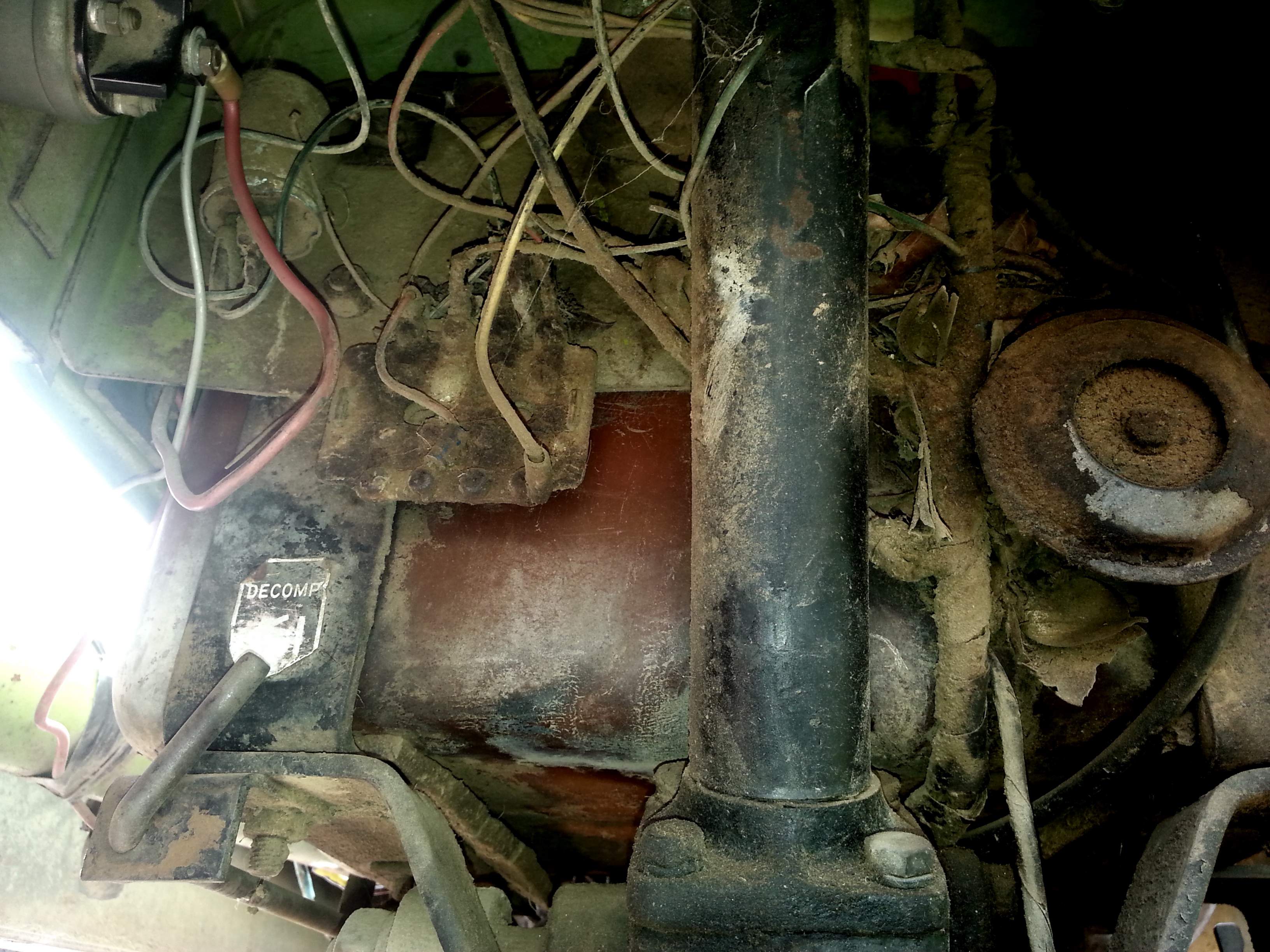

I need to redo all the electrical as none of the stuff going to the dash works and the wire junction/fuse area is a mess. View attachment 395783
I ordered one of these 6 fuse boxes to replace the existing mess. 61HEOqQ1XyL._SL1350_.jpg
I'll carefully start moving the circuits one at a time over to the new box. The old one looks unserviceable and archaic.

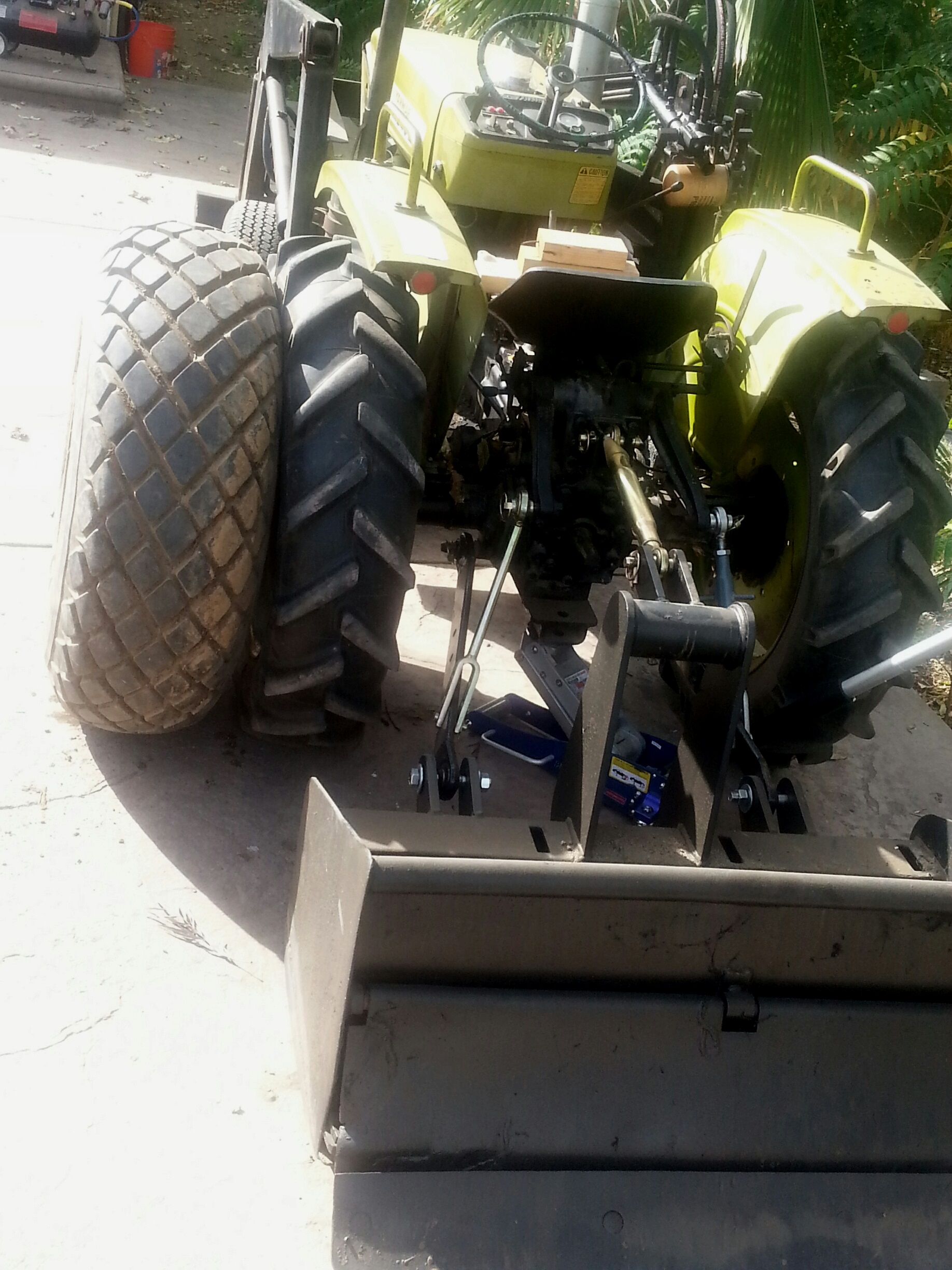

I went to put on the turf tires today and found they have leaks and wont hold air.
I'll need to find inner tubes I think for these tires labeled 13.6x16
They have and ID 16" OD 36" width 13.6". Anyone know good sources for inner tubes?
It would be great if I could mount both tires together.

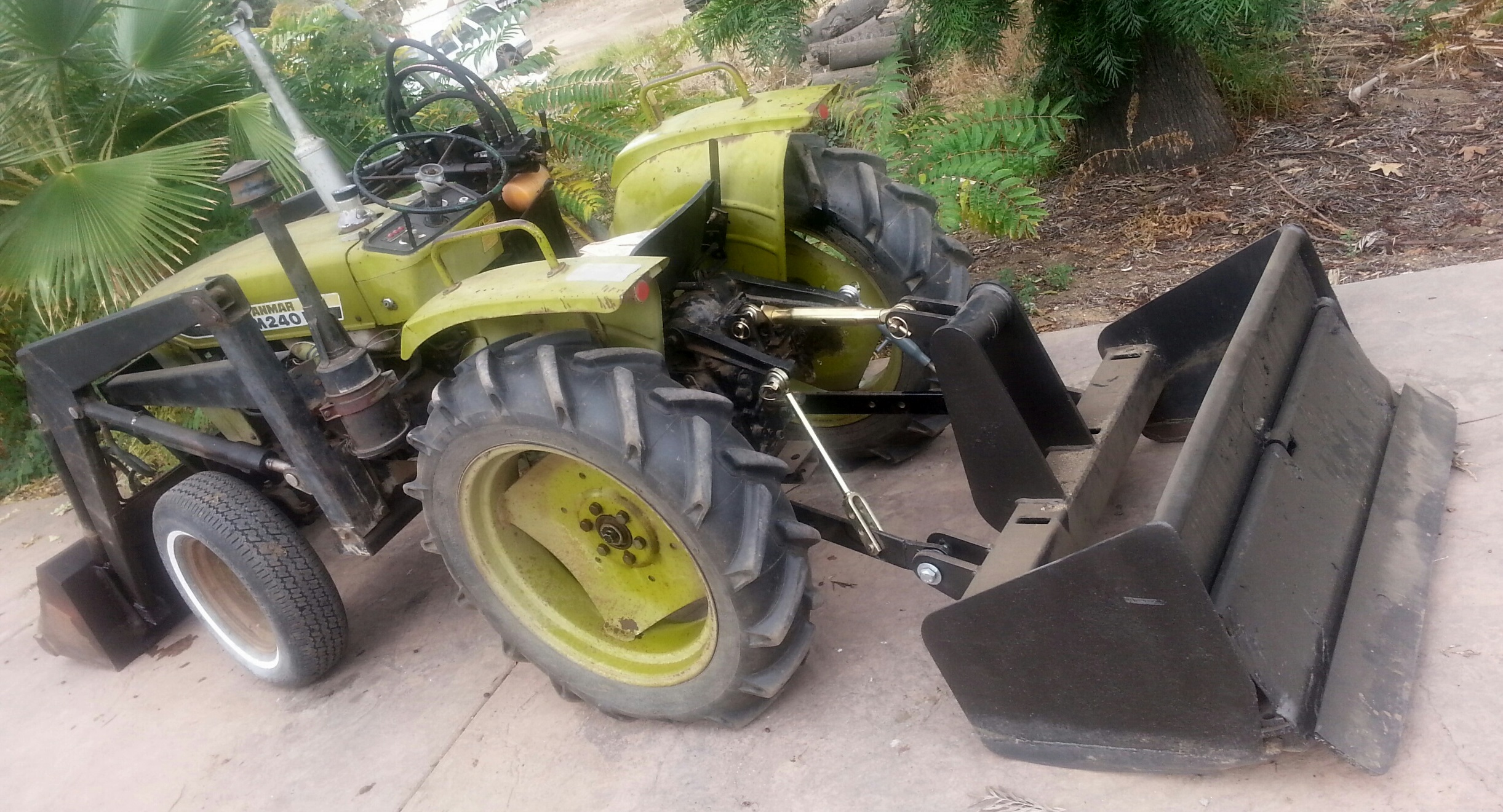

Interesting pix. I didn't know Yanmar ever used the combination of that better air cleaner with the rear-hinged hood. Maybe you have the later series engine installed? Does the engine tag say 2TR20A-X?
Also, I see the same mount for the loader's controls as my YM240 and I think the same control valve (AICO?) but with an added hydraulic filter, while mine has nothing but the screen inside the transmission. Update - I looked over in your other thread and see you have a front-mount hydraulic pump with the loader's hydraulics separate from the tractor's. That's a better design and the loader probably operates a lot faster than one driven by the tractor's hydraulics.
I think you are going to need the sway chains that should go from those rear arms, over to the mounting points at the ends of the axle housings.
And finally, if those wide tires still aren't sufficient to avoid bogging down I think it would be a great idea to have axle extenders fabricated, to run duals. It would be unstoppable.

The turf tires may already have tubes in those tires... Then all you would need is a patch... I would check them out before spending money for tubes...
/ YM240 New Owner #39
yea i would patch them. Tubes that size are $30. You can easily tell if its a tube by looking at the valve stem
