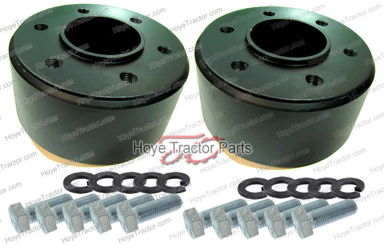

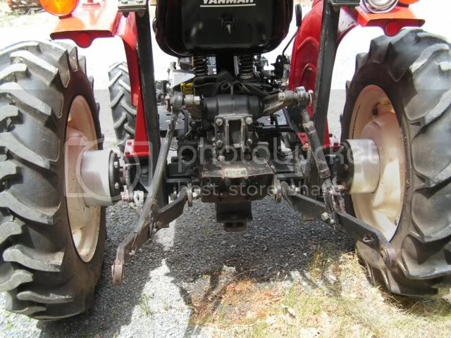

Spacers update...I canceled my order with UTV. They did not know the bolt pattern or specs for my YM2210. They wanted that info from me. I did not have it. I went with Bora. Everywhere I looked, all good things about Bora. They were $395 for aluminum 4" spacers. But another $55 bucks shipping. That was steep. Taking 4 weeks. I am still at $450 for the set. Waiting for them to come. I did get the specs from them if anyone needs to know. For a YM2210. 95mm hub, 140mm x 6 bolt pattern and the bolts are 16-2 standard thread. I will post a pic once I get them on. Did fill the tires with beet juice. Did it myself, took about 4 hours but I was busy with other stuff so it was pretty easy and well worth it. I saw somewhere a post about putting a valve stem on a jug. I used a laundry soap plastic bottle. Cut most of the top off except for the handle. Drilled a 1/2" hole in the bottom and pulled a valve stem through the hole. 1/4" clear plastic tubing to both valve stems. Bottle to wheel. . Clamped the bottle to my ROPS and just kept filling it. Had to pull the tubing off the tire stem after every gallon to let it burp. Worked like a charm. I got the Beet juice at Les Schwab. I brought two empty 55 gallon drums and had them put about 20 gallons in each drum so I could move them around by myself once I got home. Probably should have waited on the beet juice until after I got the spacers. I had put beet juice in about a week before I ordered the spacers. We will see how hard it is to move a 275 LB tire by myself ;)
