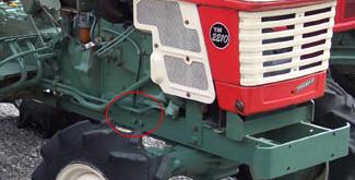

Ok, I am not sure what this tube is called, I have some oil/wet stuff that sometimes comes out this tube, but not always, seems to do it when I have to turn it over more then a few times to crank it. Its minimal but I think this is called blow by? How much is to much and is it normal to occasionally get this?
I also have a YM2001 but the tube is extended down far enough to where as if it has it it spits it on the ground, so I can't compare.
Second, is it normally harder to start a 2 cylinder vs. a 3 cylinder yanmar? my YM2001 cranks right up first turn no matter temp, the YM2210 takes a few turns on a cold morning, and puffs out white smoke while its trying to start, after it starts the smok clears and I can shut down and crank back with 1 turn.
All this normal?
SEE pic for the tube im referring to, this is a picture I got off the internet so its not my actual tractor. The "red circle" is to show where the nasty stuff blows out onto the tractor frame.
Thanks

it is a crankcase vent to prevent Crankcase pressure buildup, just as your pistons build compression in the cylinders they also can build up pressure on the down stroke in the crankcase, usually you wouldn't notice any oil coming from the vent tube, it is design to relief vapor pressure do to windage of the internal engine components and the pressure of return stroke from the pistons, when the engine is cold your oil level builds higher in the oil pan and the rotation of the crank will pickup the oil and disperting it creating windage/ pressure, as the engine warms the oil thins and can move thru the engine more freely, usually when you start seeing oil around the vent tube would be a good time to change the oil, if the oil gets too thick it will not move thru the engine freely causing the oil returns to clog and then build excessive crankcase pressure,

The vent tube is operating normally, ignore it. Cars used to vent to the ground like that. Then smog rules required retrofitting PCV's (Positive Crankcase Vent plumbing) which route that smog back into the intake so you don't see it.
As the pistons go down the air in the crankcase gets compressed, and that tube lets the crankcase 'breathe' to outside. Of course a worn engine will have more pressure in the crankcase, and coming out that tube, due to compression that got past the rings.
2 cyl vs 3 cyl starting. I was amazed that the 3 cyl YM186D I bought recently starts instantly. Even faster than any gas engine. My 2 cylinder YM240 used to fire on the first compression stroke but take a couple of revolutions to smooth out. Now running B90 biodiesel it doesn't start as readily and can take 5-10 seconds of smoky cranking before it fires off. I topped up the YM186D with B100, about B50 blend in it now, and it still starts instantly. I suppose improved starting was one of the reasons for upgrades beyond 1970's technology. I still prefer the 2 cylinder engine's torque however!

Ideally your crankcase should have a vacuum, as measured by a "manometer". If there is pressure instead, could be a bad vent, (PCV), should only let air out, not in, bad head gasket, rings, plugged exhaust, or even bad dipstick seal. Bad HG or plugged exhaust could be a reason for your hard starting.

Shouldn't be any, if all is good, oil at correct level. My YM2000B has none. Never noticed if it blows air out. Easiest to check is plugged exhaust.

Just to make sure all is clarified, this tube does not "blow out" anything constantly, and it has only blow out a finger tip size of oil/gunky/watery substance 2 times, both times after cold starting it.
I know I said it was oil, but after inspecting its more watery, the tractor does sit outside but it always coverd with a heavy duty tarp and I have a metal can over the muffler to keep rain out.
Tractor runs great, no power loss and only smokes under a load, powershift changes with ease, no leaks on the machine. I was just curious as to why this mixture very randomly comes out the crankcase tube.
