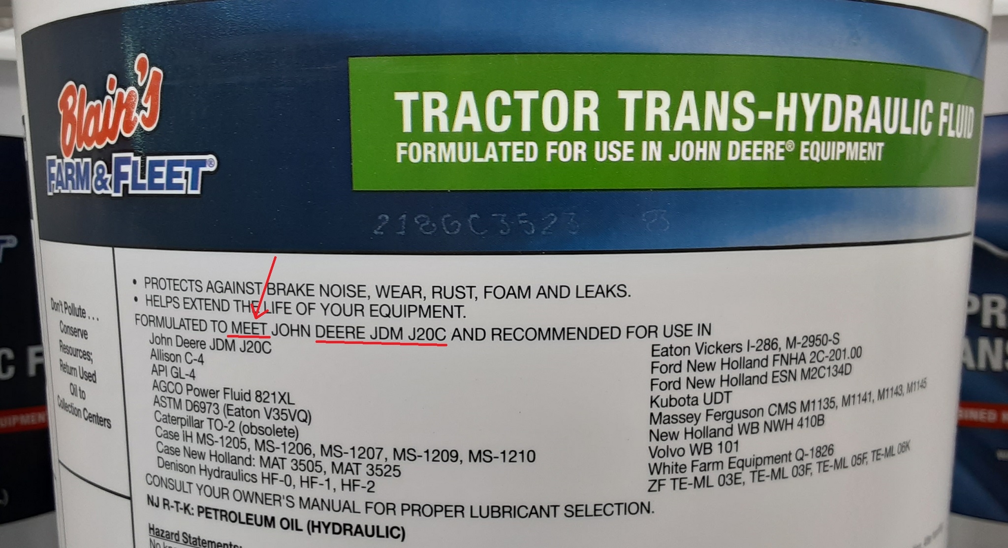

After the BLACK goo was drained, did you RINSE out the entire hydraulics with DIESEL?
With the diesel in there, work the tractor thru all gears and ranges at low idle.
Drain all the diesel out. A residue is fine inside.
Clean the hydraulic filter.
Put it all back together.
Refill with the correct fluid as mentioned below.
ONLY use hydraulic fluid that meets JDM J20C. period. Never compatible with or stating recommend.
