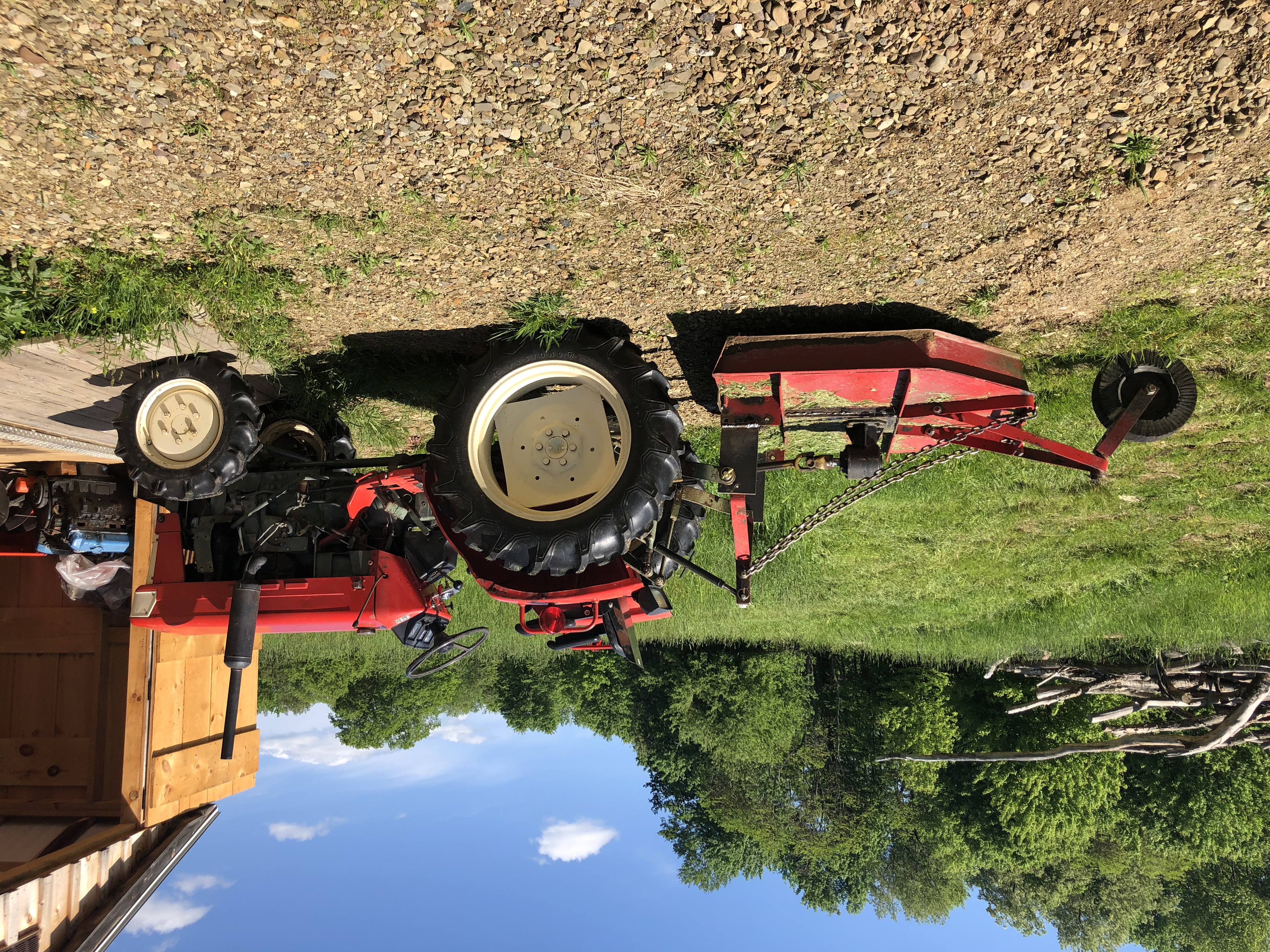

Just kidding. Here's a pic of my 2210DB as it sat last summer ready to mow. Over the winter I Had the cylinder head gone over and machined flat again to remedy a leaking head gasket. And while I was in there I honed the cylinder liners to freshen them up, put new rings, rod bearing, and small end bushings in. I also rebuild the out portions of the front drive axle since they were all floppy and loose. So it's all back together and ready to go, just need spring to catch up here so I can get out and use it. Great job on yours, you'll really like that model. They do more work that you would think for such a compact unit.
Nice!!
