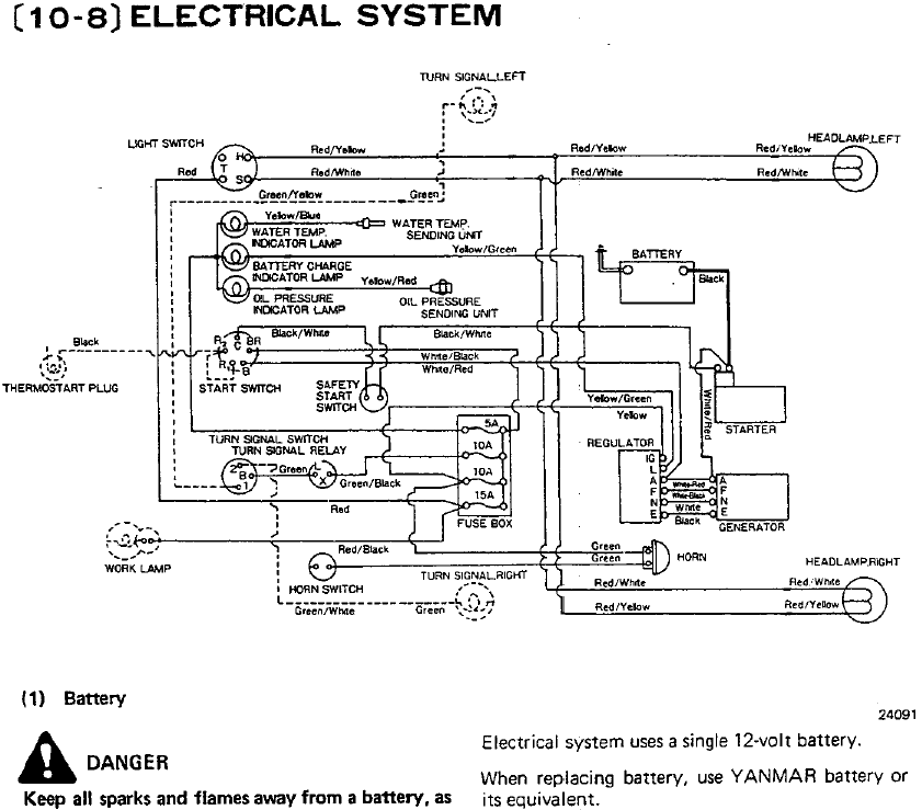

Oct 13, 2009 / YM2210 Fuse box info #1 Smoody Platinum Member Joined May 30, 2008 Messages 632 Location South Carolina Tractor YM226D Can someone tell me what each fuse in the box are for and what size fuse should be in each slot, start from left to right please. Thanks
Oct 13, 2009 / YM2210 Fuse box info #3 California Super Star Member Joined Jan 22, 2004 Messages 16,877 Location An hour north of San Francisco Tractor Yanmar YM240 Yanmar YM186D This should be similar. It's the wiring diagram for YM240/YM2000. In fact, please advise us if it is (or isn't) a perfect match for YM2210. If what you have is a 2210B with the more elaborate instrument panel, then I expect there will be some circuits not shown here.
