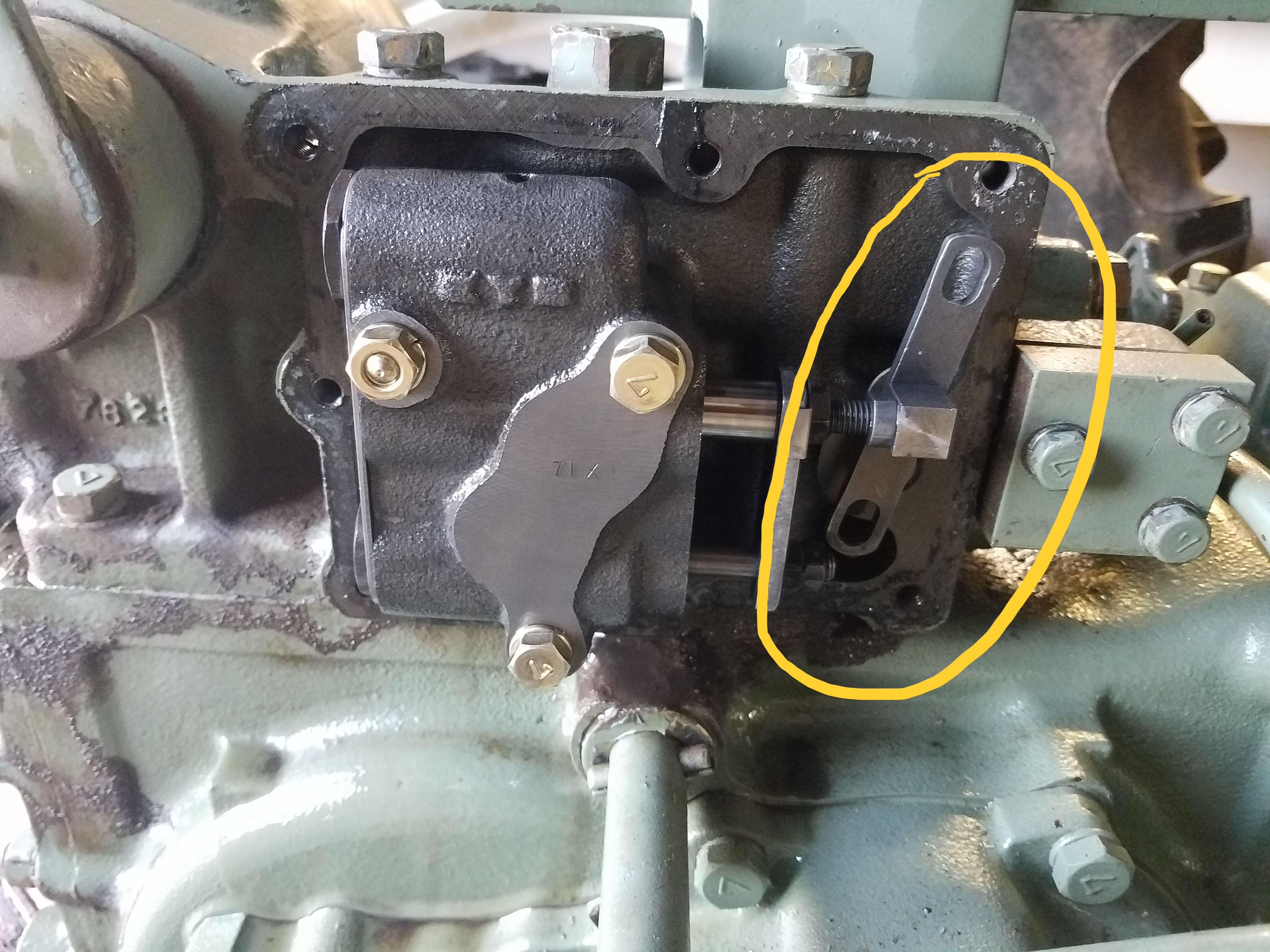

Hi Guys,

Sounds like your lift piston, control valve or something is leaking badly, therefore your lift is constantly trying to maintain the set height. If you raise your lift with a load, close the stop valve and kill the tractor, how fast does the lift fall? Or does it?

Hello, lift arms have no drift, it won’t come down unless I push the lever to make it go down, it will stay up all night with stop valve open. Thanks for your help.

Ok, another thought. There is a rod that goes from the end of the rockshaft to the control valve shaft. It is a feedback rod used to stop the lift from over extending. Is it possible yours is out of adjustment. Should be adjusted to stop lift right before lift piston bottoms out. It has a turnbuckle on it used for adjustment.

I have messed with it and “I think” I have it right . So on the control valve there is a “T” bracket that is adjustable on one of the spool valve “I think that’s what it is called “ the feedback rod goes to the bottom and the leaver that you move goes to the top. The T-bracket that is adjustable,you think this could be out of adjustment? Because if that is out of adjustment I would think that the valve would be diverting oil some place it shouldn’t and this is causing it to bounce, If that makes sense .

This is a pic of the control valve,this is on the inside of the side cover,you can see the T that I was talking about, anyone know the adjustment of this? .

I suspicion that valve is not used on any of the American sold models and therefore you will not find a service manual for it. the 220/226 models and 276 have side mounted valves but not like yours.

It seems to me, that if that rod is adjusted from the orig. start or factory. That it has to be from somewhere else, to cause this reaction. Like was mentioned, a leak down from another valve. Maybe leaking around the o-ring in main valve. I wouldn't adj. that rod(unless you mark it from where you started from. Just in case, it's not it. Make sence?

Everything that I have taken apart that had O-rings all look good ,in the main valve there痴 one small o-ring and one small nylon washer and that痴 it ,everything else is metal to metal .Someone definitely messed with this before I did, I can tell from the paint missing on the bolts, on the control valve,I took pictures with a micrometer so I would know how it went back together. I still think the T bar on valve is my problem,just wish I had an idea where to send it . Thanks for trying to help me.

Unfortunately, since you are positive someone has been in there before l, you really have no ideal what might have been done.
Might I suggest replace the O-ring and nylon washer, they could easily have wear that allows a pressure drop. I would also suggest a close examination, if you have not, for wear on the metal to metal parts. Unfortunately, specs on these is hard to come by. Again Aaron at Hoye is one of the best resources I have found.
I would also suggest the ym owners group with Hoye. Hopefully, Aaron will pickup your thread tomorrow (Tuesday after labor day) or soon thereafter.
Another suggestion would be to clean the hydraulic screen and replace the filter (if equipped) if you have not done so. A restriction on either of these could reduce your flow rate enough to cause issues. As down force is controlled more by weight, gravity, and open valve status and not pressure or flow rate, it would be not be influenced by a clogged filter/screen.
A final suggestion since you have no ideal where to go, is if you decide to adjust on your T bar is to take slow adjustments and check for changes.
