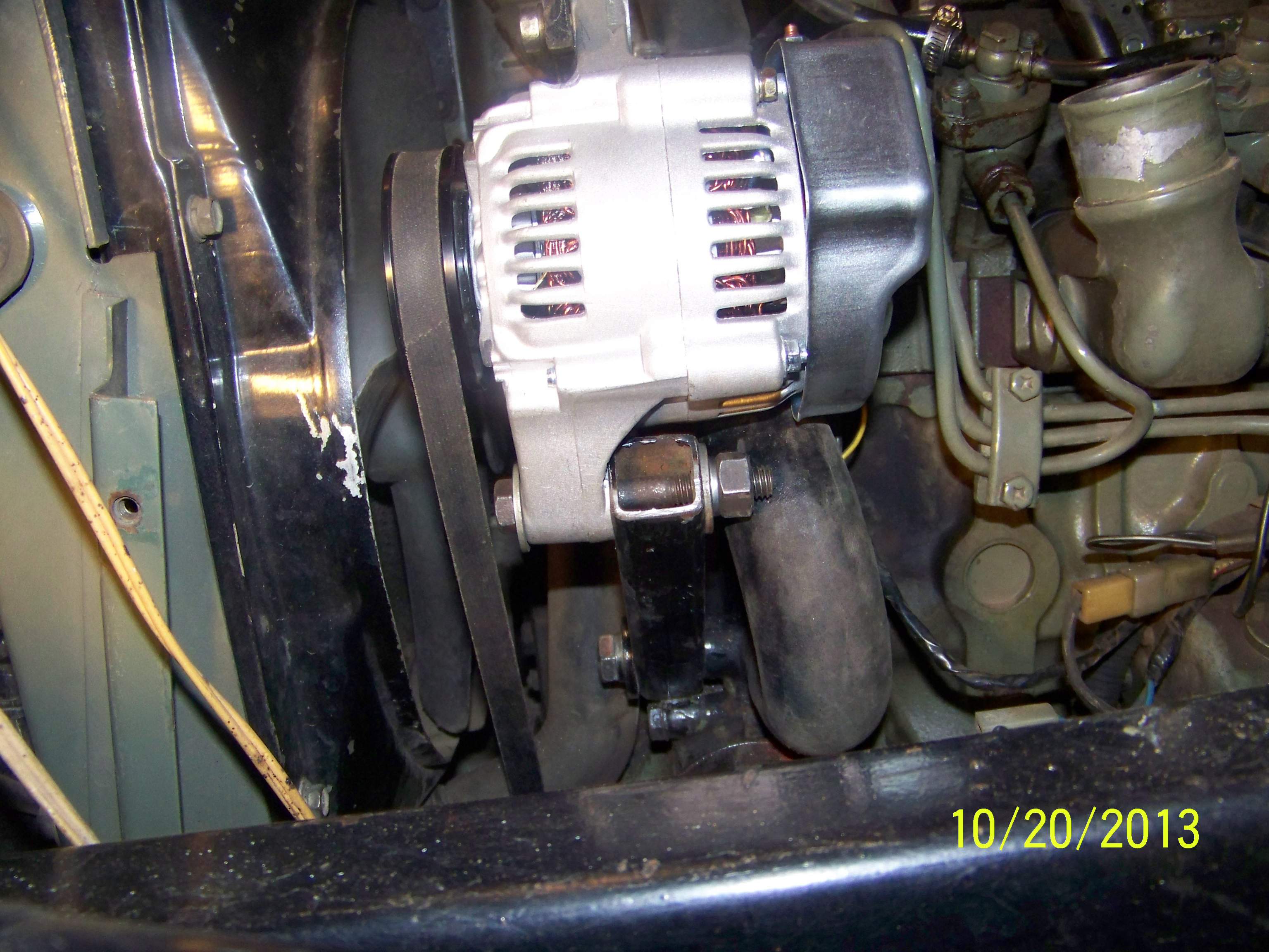

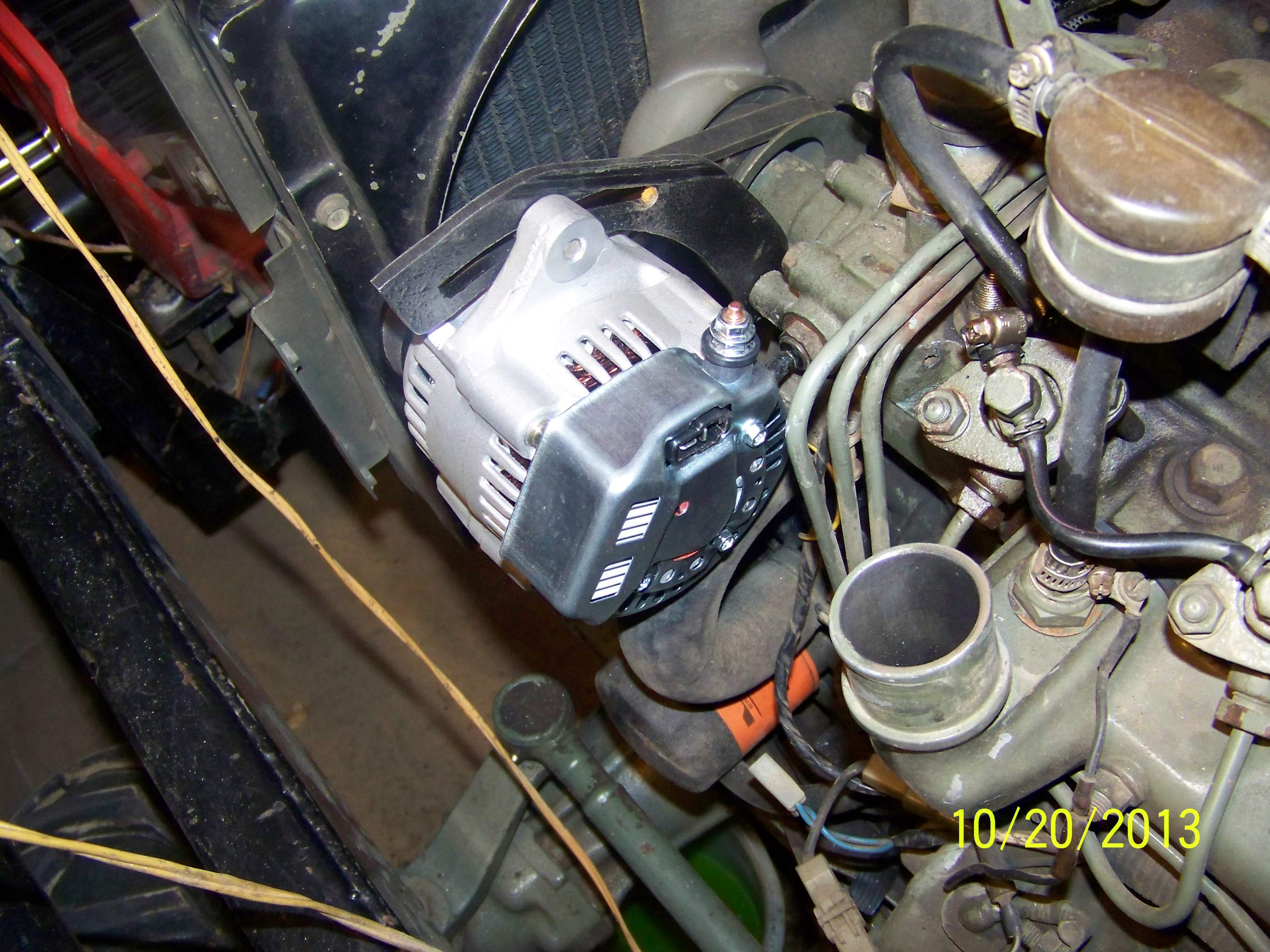

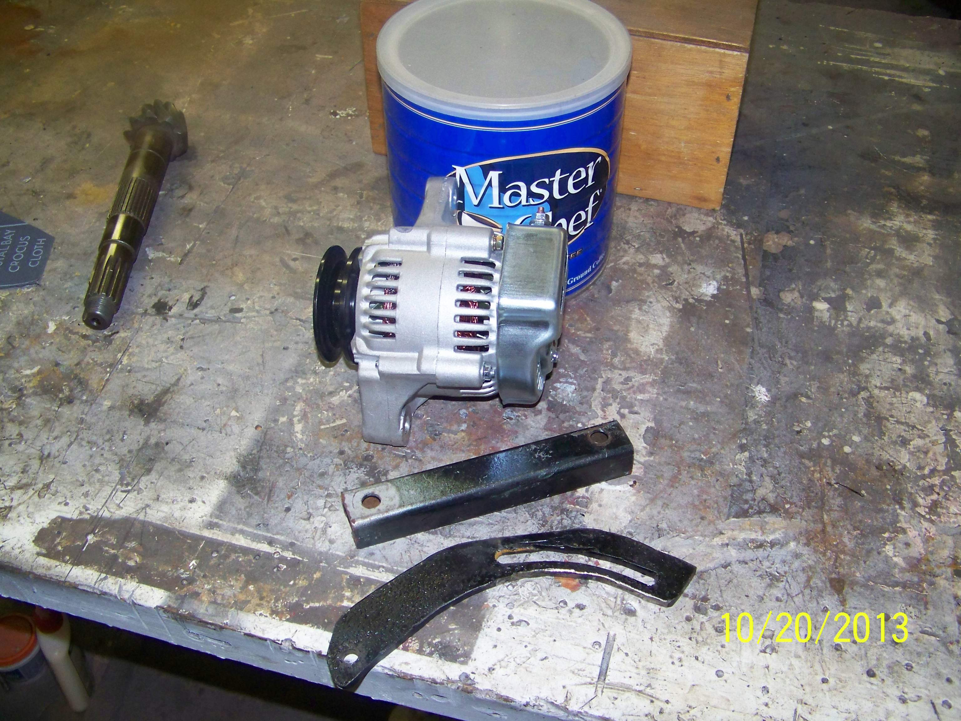

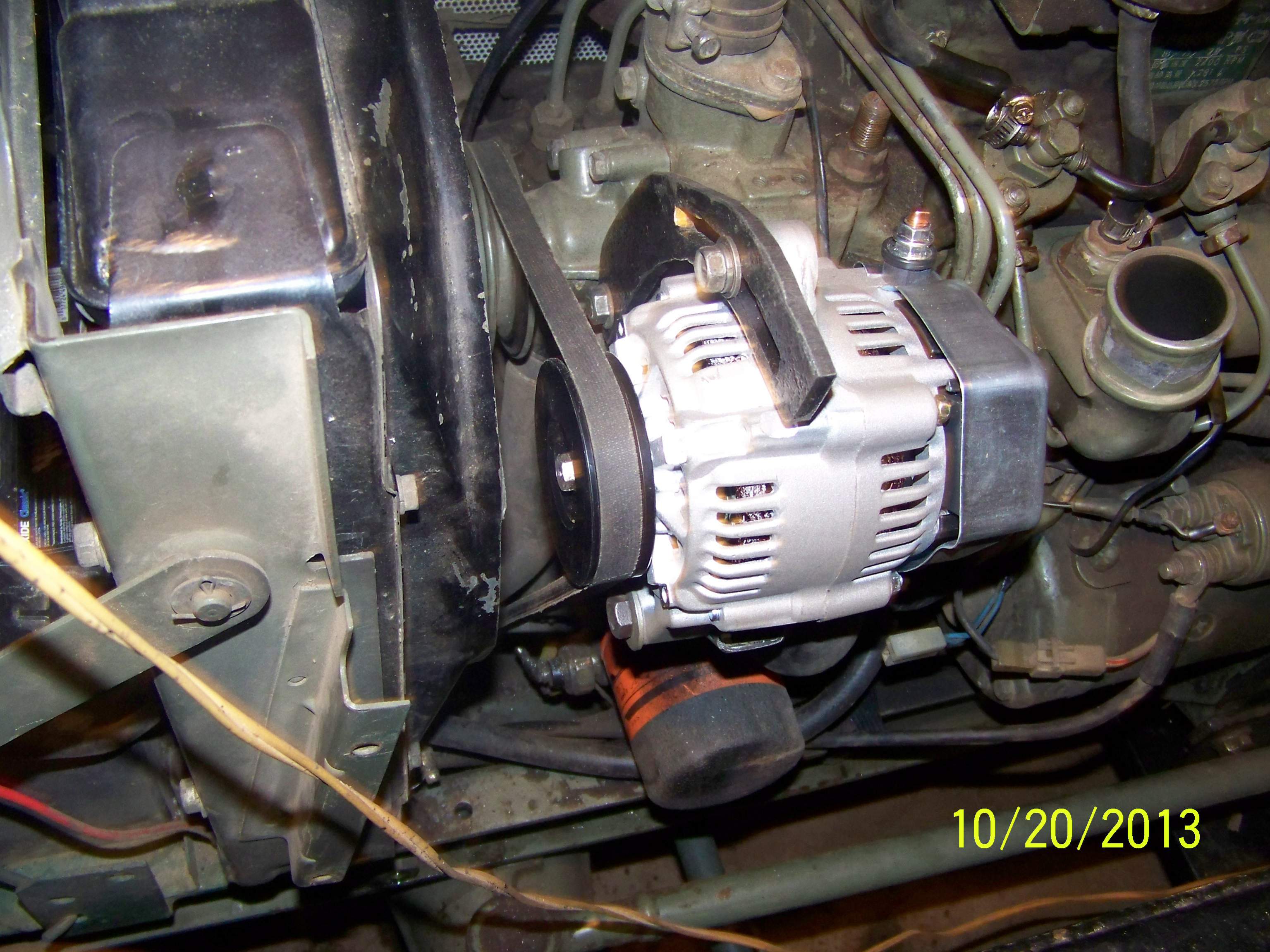

Ok, the mechanical part is complete. A few pictures to show that. I put the alternator next to a coffee can so you can get a better idea of the size of it. Used a 39" A belt.
Now the bad news. It won't charge. I first hooked it up as best I know how according to the hand made drawing Scotty Dive had attached in post #17. Nothing there with charging although all electrical worked including warning lights. I then disconnected everything except a wire from the battery to the post on the alternator. Still no charge. Showing only battery voltage. Have I got a bad alternator??? :anyone:
This is the alternator. Alternator Chevy Mini Denso Street Rod Race 1 Wire 8162 | eBay
My reading indicates this is suppose to be a self energizing alternator.
Back with an update. I have found running a hot wire to the spade terminal closest to the post terminal will excite the alternator and it puts out a solid 14.5 volts. This tells me the alternator is ok. Just need help in making proper connections. I know there is help coming so I will be waiting.

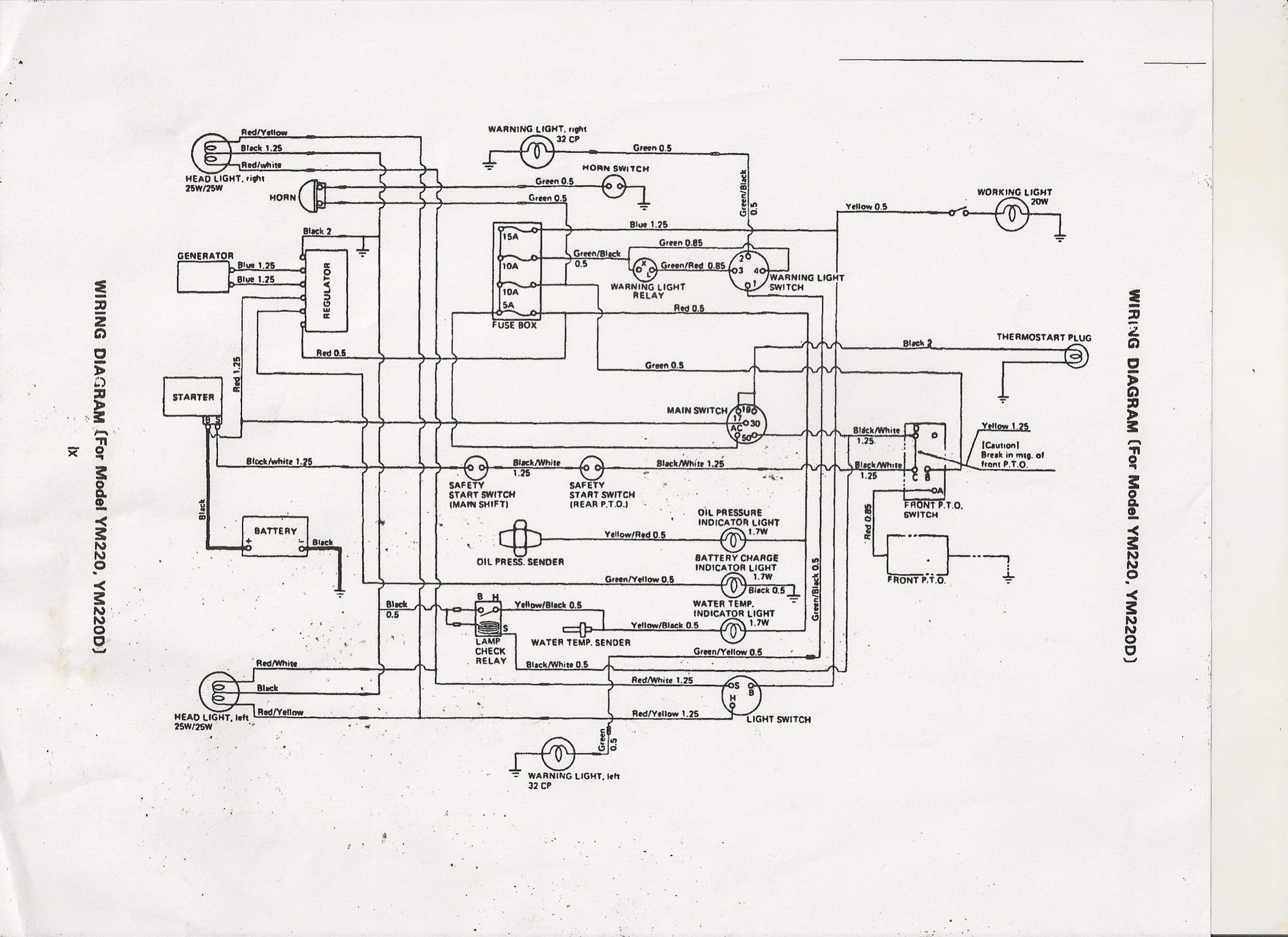

Another update. I am attaching a scan of a 226 . The plug colors of the regulator are identical to my 2002. Anybody tell me what colors go where, etc.
Well, I'm having fun talking to myself anyway. I found these instructions. I am part way there. If I can figure out the ignition light wire maybe I will get it. Going to be busy tomorrow so may not get to tinker with it. But I will be back. http://westfield-world.com/daihatsu_alternator.html

OK, i see 2 terminals and the stud. 1) Stud connected to Batt+ for charge 2) one of these spades is the charge light and the other needs a switched + wire from the ignition switch for voltage sensing. you may also have to change your charge light lamp for a 5W one if it's not already for it all to work correctly.And another thing, i told you that you were cluey enough to sort one out.....:thumbsup:
