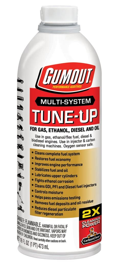

Clean the tank. inspect hoses and lines. Purge them. Replace the fuel filter, o-ring, and bowl once again. The fuel pump can be cleaned with Gumout Multi-System cleaner. 1 bottle for about 5-gallons will do the trick. This works better than Seafoam. I've used both with good success, just the Gumout does a superior job.
