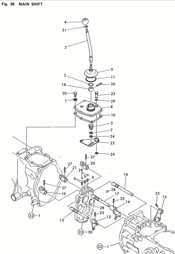

In a pickle; help! ... Clutch, manual stick shift, 4 high low + reverse, YM180D is stuck in reverse and totally binding in 2nd to 4th gears will stall tractor. no neutral; seems like the shift lever moves all shift forks into 1st but still in reverse; no neutral, stuck in reverse, tractors on a nice neighbours property behind mound of fill, in the bush; lol?; looked inside the shift cover forks look fine from the top of shift plate access, shift plate was warren peened metal back into shape, so less warren but didn't fix issue. Suggestions on way to get gears back in the field?

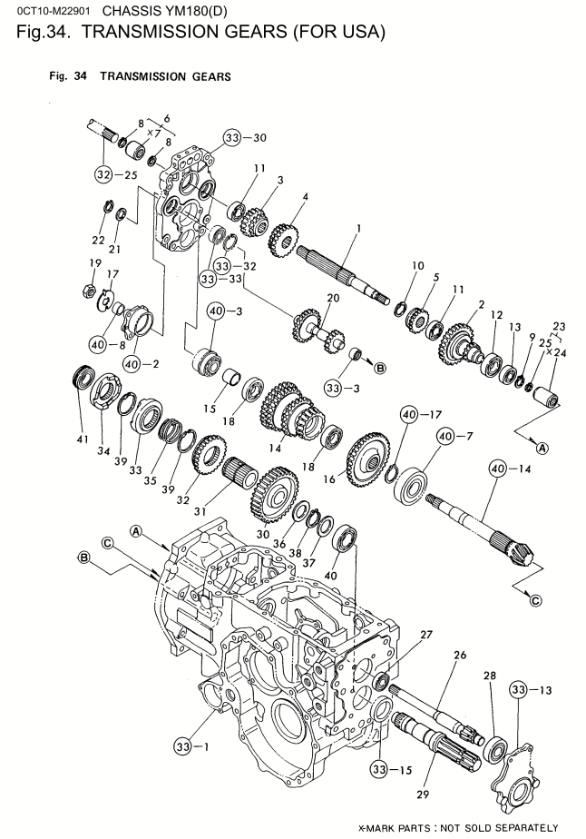

YTOG Parts manual
   / YM180D transmission stuck in reverse!
okee-dok! thanks for the diagrams ... but now to figure out; how and where, its stuck, bent or binding.
   / YM180D transmission stuck in reverse! #5
When shifting gears do they all feel like they are actually moving forks or just detents? I'm wondering if a roll pin could have sheared or fell out and left a fork stranded in gear. Or, better yet, if you an see the forks with the top plate off - move the sliders with a screwdriver or prybar and see if reverse fork actually moves.

checked yesterday under shift plate; dents are moving; roll pins in place on dents, feels like there moving forks but maybe not; note, 1st / reverse dent seemed to have more play side to side and I could twist it and there was a larger gap (Abt 1/4") ....

ok found the problem; 1st / reverse shift fork was broken in 1/2, :L
Fished that out of the bottom of the transmission case with a magnet stick at 5 pm today, so now ID-ed the stuck in reverse issue;

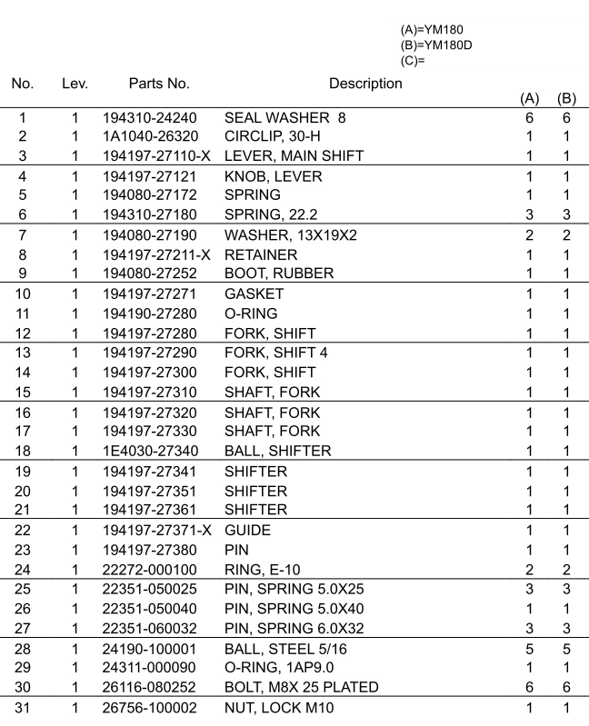

Compliments of the YTOG, see attached.
Areas of interest,
  • YANMAR YM180 PARTS MANUAL 0CT10-M22901.pdf
