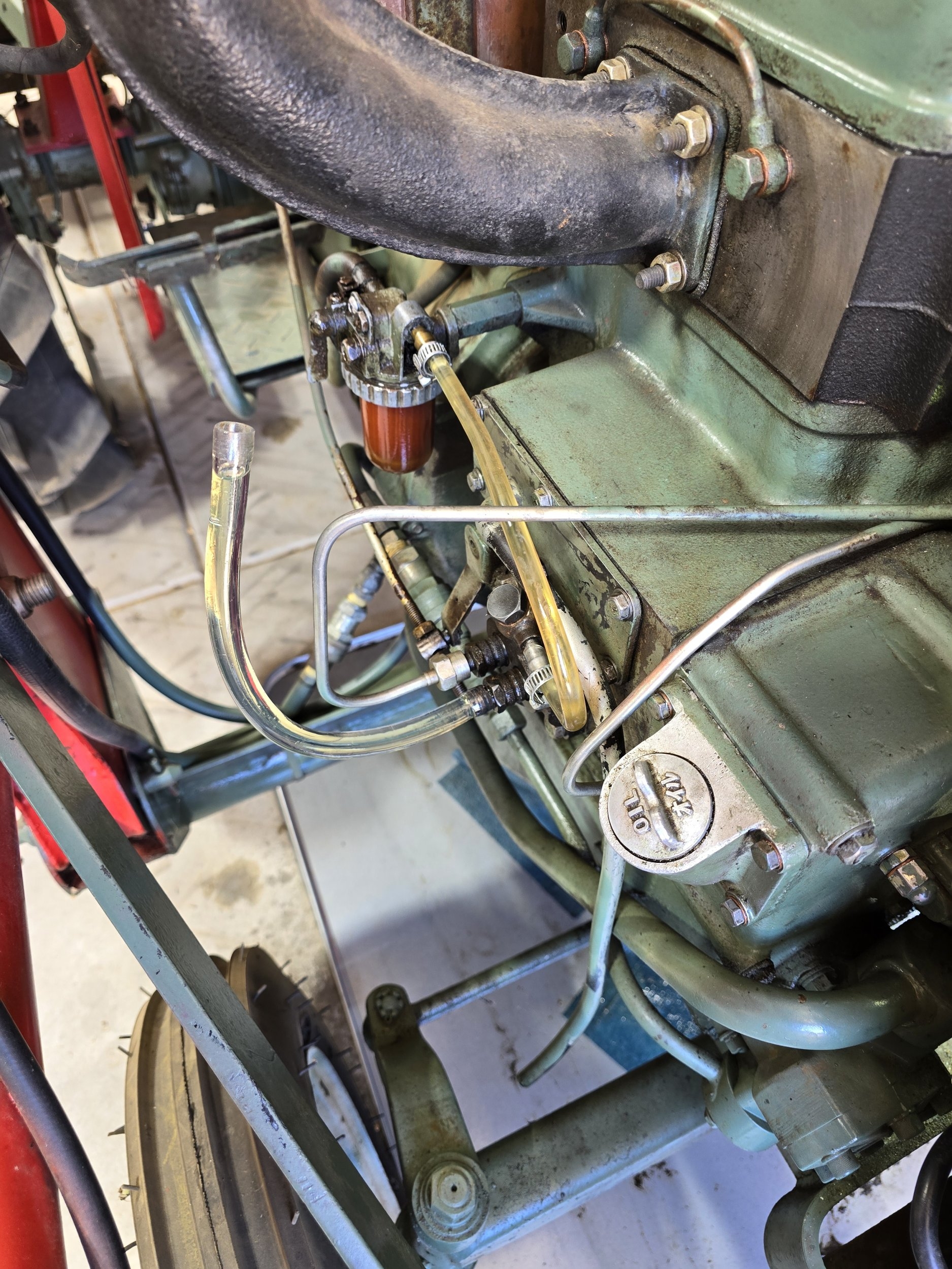

One thing I noticed with a clear tube between the fuel bowl and the injector pump is that after bleeding at the fuel bowl, pump, and injectors I could see there were no bubbles in the clear line. When I started up I saw a lot of bubbles filling that clear tube. I even saw a few small bubbles generated just while turning over to start. I hadn't put much fuel in the tank in case I needed to empty again for some reason. I looked in the fuel tank while the tractor was running and could see the fuel "fountaining' up from the tank drain. See around 10 s into this video. It seems like one way to avoid this would be to just have more fuel in the tank (which I'll try) but should this be happening?
Fuel fountain in fuel tank
Bubbles in tank and fuel line tank half full

So, the fuel bowl and o-ring are new? This condition has been seen before when a hair-line crack in the fuel bowl or the o-ring doesn't seat well. The fuel pump is pulling fuel and the suction is so much, air from the outside comes in thru the cracks, thus the bubbles.
Additionally, Does this machine have a thermo-start? The device at times is feed from the fuel tank and not a small reservoir. If there are leaks or bad lines there, then air is getting in.

Good video of the “problem”..
That is indeed odd..
Is there any way to reroute the return.??
Is that the fuel outlet, to the filter, directly under the return bubbles.??
Just as a test, grab a spatula, preferably off the grill, and see if u can block off the bubbles from the outlet..

The fuel bowl assembly is new. The tractor doesn't have a thermo-start.
The fuel jumping up in the tank in the video is directly over the outlet that runs to the fuel bowl. It almost seems like there is some back pressure into the tank at the outlet being viewed in the video but there is a net flow of fuel to the injector pump.
I may try an auxiliary tank directly to the injector pump to see if that bypasses the bubbles.
I like the idea of some sort of deflector above the gas tank fuel outlet too to see if that reduces the turbulence and bubbles.

Nice videos, but I suspect that this is a side issue, related to basically no fuel in the tank.
While it is possible that there is a leak in your bowl/fuel line that is letting some air in, I would retry this with a tank that is at least 1/4 full. You can get a lack of proper fuel flow if the fuel system has air in it, either issues in the injection pump, or fuel lines to/from it, or in the lines to the injectors, or the injectors themselves. Does the fuel tank weep fuel at all, possibly from the tubing adapter at the base? Once you have the whole fuel system primed, and free of air, I would see if the engine runs any better. If it doesn't, I would pull each injector one at a time and check for a reasonable spray pattern out of the engine.
Since this problem happened to your engine suddenly, I would be looking for a part that failed mechanically; cracked fitting, cracked tubing, broken injector, or an injector pump that had the linkage give out.
I had a problem on an overfueling Yanmar clone engine that turned out to be a minuscule crack fracture at the base of the inlet to the injection pump, making external bubbles of about a 1/16th-1/32nd of an inch in size. The tiny amount of air getting in was enough not to have the injection pump get up to enough pressure that the injector just dribbled fuel into the cylinder.

I tried an auxiliary tank sitting on the air cleaner bypassing the fuel bowl and filter. There were no bubbles and the tractor didn't stop on its own. It still is a bit difficult to start and is still smoky but progress. So I think I need to work on the fuel bowl and tank plumbing for the bubble issue.
In one of the earlier posts I mentioned that the tractor had run reasonably well for 20 years and then I couldn't start it. With only occasional windows of time to work on it over the last few years I replaced many parts so it really hasn't run normally since then. I'm optimistic it's getting close though. Thanks all for the feedback and suggestions.
Some posts back are some videos of the injectors firing but not sure that the atomization is what it should be or how much that would effect the current issues.

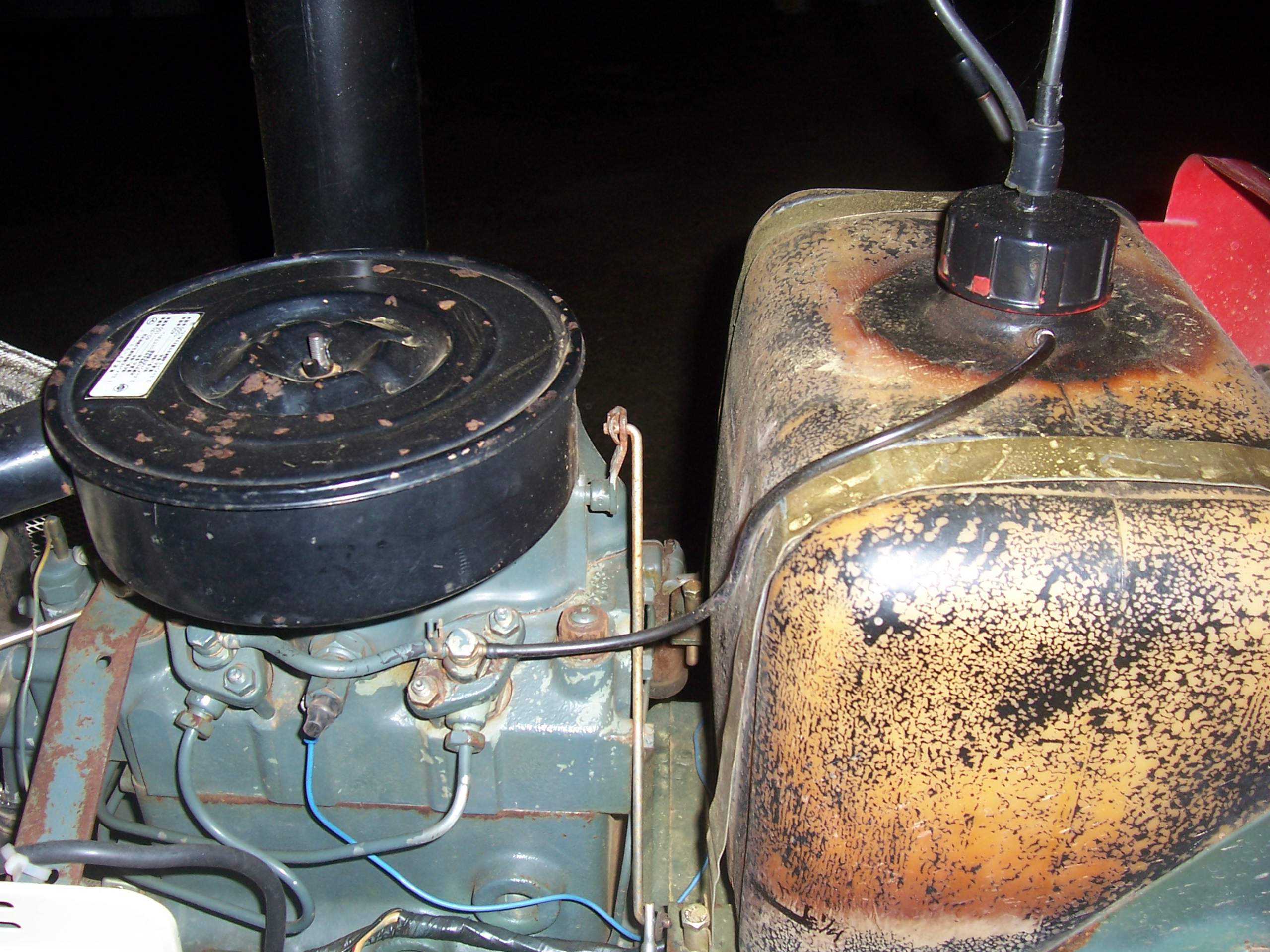

The low fuel and air bubbles needs to be taken care of. It's gravity fuel fed to the Inj. Pump. If or when the smallest amount of air hits the Inj. pump it looses prime. The bubbles in the tank are normal. Mines shows up with a low fuel level, But no air in the line that I could see. looking hard Esp. before the Inj. pump.
What problem I did have was my Fuel Tank would get Pressured up and I could actually see the air bubbles leaking at the Inj. return line. Were it inserts back into the tank. I would end up with Small Puddles of fuel on top of the tank. A small piece of rubber vacume line and ran the Hard plastic return fuel line through it to and seal up that one. I also vented it with a Filter through the cap. Just a 2 cycle fuel filter from inside the tank. Weedeater I believe. :rolleyes:
It's been many Yrs. So things are hard to remember but I keep thinking that There was a problem I noticed going through and cleaning repairing everything of the Fuel tank itself at the fuel line connection was pretty much clogged up. The cut off is on the Fuel Filter Assm. so I knew that wasn't good. Something tells me the oil ring around the fuel bowl basically disintegrated also and had to actually make one fit.
One reason I bought it was Org. and looked as if it just rolled of a boat from Japan! From a local Fredricks supplied dealer. Knowing I could get parts etc. from Fredricks now I'm still all org. with only basic repairs needed to make and keep it that way. Coming up on 1000 Tach Hrs. Mid 900's it's my lawn mower LOL... What I actually bought mainly to use it for.

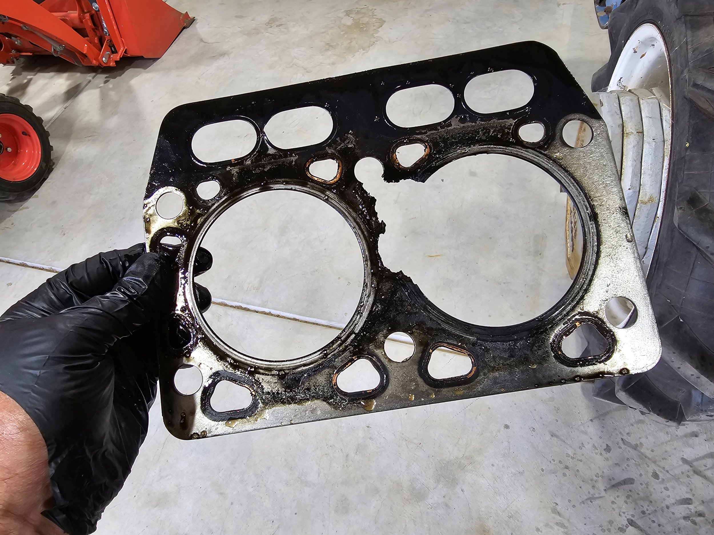

Update - I noticed a small puff of smoke coming from the bottom of the head when trying to start so pulled the head. The head gasket - which I had just installed a week ago - had a large piece missing. Going to clean the surfaces again and put a new gasket on.

Did you check your head for warpage?
When you put the head back on,
- never slide the head around atop the gasket.
- place all bolts in first as 'finger' tight.
- there is a bolt sequence and several torque down levels to run-down
- between each torque levels, pause for 15 to 30mins to let it take a set
- At final torque sequence, do not turn torque wrench fast, go SLOW.
NEVER use clicker torque wrench on the FINAL torquing. Clickers can exceed the max limits or fail to properly hit the values.
A Dial torque wrench is typical for engine head work.
As for the gasket, there are many CHEAP ones out there in material and quality. Not certain if the gasket was the problem.
Is it possible the piston or other item caught the gasket and ripped it?

Thanks for the suggestions. I will follow the installation instructions more carefully and also try the dial rather than click torque wrench. I also have a digital readout available.
There seems to be two kinds of gaskets that are available. All metal ones like the one I just pulled off and others that seem to be a sort of grey composite with copper rings for the seal areas. Sometimes I receive the composite and sometimes the metal gasket regardless of what the photo shows.
The head is new but I will check for flatness. I have checked the block before but not recently so I will look again.
Interestingly the forward pre combustion chamber nozzle holes for the front cylinder got enlarged but the rear one did not.
I don't see any indication that the piston somehow ripped this gasket but I was surprised by how damaged it is.
