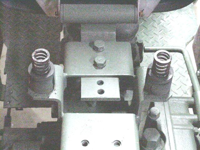

I replaced those rubber bumper thingies with military surplus springs I found locally. Sure helpd a lot. Most of the springy suspension seats are too wide to fit on the 1700.
I think I had posted some pics of my seat springs on here. I'll try to find them.
Edit.......here's one seat springs

I split a 1/4" fender washer and twisted it to match the spiral of the springs. Slipped it in and ran a 1/4" through it.

Finally got around to snapping a picture. They fit perfect into the existing rubber bushings. No tools required!! /forums/images/graemlins/grin.gif Now I've got a little bounce in the seat, and it's not leaning way back. Thanks again!

My biggest complaint was that the seat was leaning way back. I'm assuming because the little rubber things are worn, but maybe it's just designed that way. Anyway, adding the springs brought it right up where it's not leaning anymore, and it now has a little bounce to it, even with 220 pounds sitting on it /forums/images/graemlins/grin.gif
