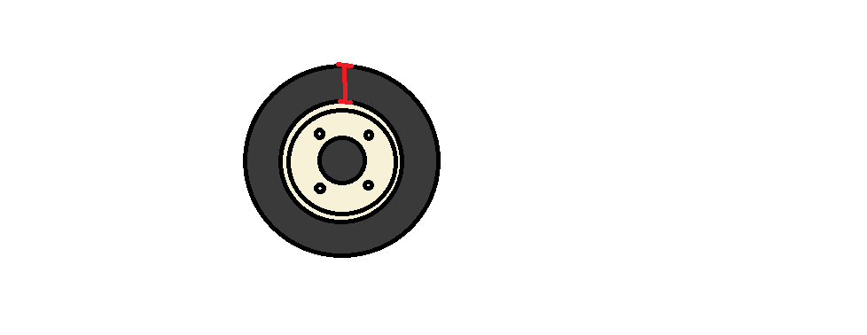

/ YM 155D #5
As far as the front tires go, mine are 6/12's. 155/165 I am assuming would me millimeters, They have to do with the depth of the tire. Check out this link, It converts millimeters to inches. Convert MM To Inches Conversion Tool I would look into getting another 1-155/12 or a 6/12 front tire to get the 4wd ratio back on track. With a 165 and a 155 on the front I would be uneasy using your 4wd because it will put a lot of stress on the components to one side which increases the risk of damage or failure.Sorry to get back to you so late, been pretty busy lately. :confused2: Happy to help though. :)
