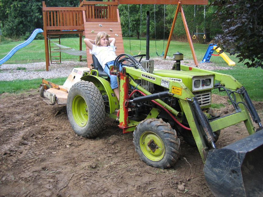

I also have (what I think is) the YFL-155 on my 155D with front pto mount pump. I am interested in what oil it takes. I have recently used the same hyd/tran fluid (JD303 equivalent) that is used in the transmission/3pt lift. Is this right? The pump seems a bit noisier than what I remember when I bought it used. When activating the loader it quiets right down.

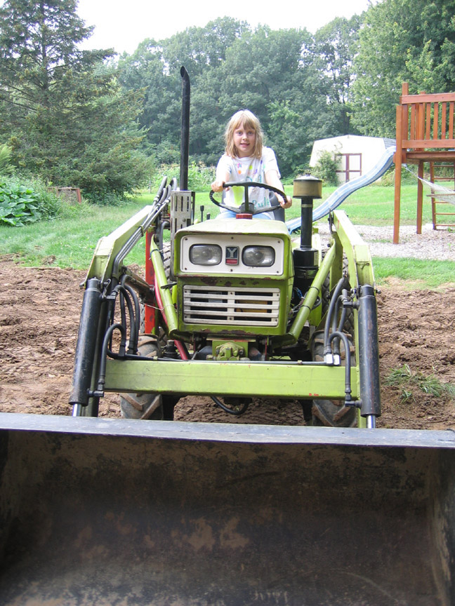

Does anyone know what hydraulic fluid the YFL-155 loader takes?

   / YFL-155 Loader Specs #7
Thanks Aaron,
Now I'm questioning whether I actually have the YFL-155 or a Johnson loader as mine has a seperate oil reservior in the right upright and a pump on the front pto but looks very similar to the diagram. I can't find any identifying markings anywhere except for "yanmar".
Sorry, I don't mean to hijack this thread, but my ears perked up because I always learn something from the collective knowledge of you all and I was hoping there was a simple answer as to why the pump is a little noisier since I put hyd/tran JD303 equivalent in it a few months ago.
It's a great little loader! Just my size.
Craig

I have a YFL-155 and it's fluid reservoir is in the loaders right arm. I used 46 weight hydraulic fluid. It is completly seperate from the 3point reservoir.

swedish-fish said:
Thanks Aaron,
Craig
You have the YFL-155 loader. My loader looks exactly the same. Green color same valve, ect.
Thanks for the info. I added 46 wt Hydraulic fluid into the loader res. It seems to work well I have had to clean the strainer twice since the loader was sludged up pretty bad. Looks pretty clean now. I have never heard of a loader with the res. Inside the arm of the loader but it seems to work well.
