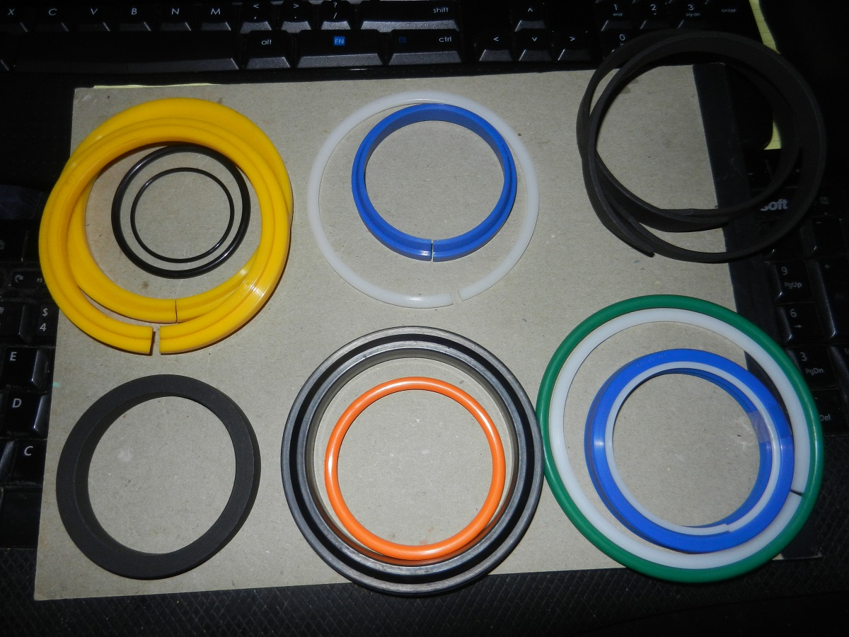

Another alternative is buy the seals online and do the rebuild yourself. This is all standard generic stuff, just take the cylinder apart and measure what you need. It's not rocket surgery.
I spent about $10 in parts and did the other loader curl cylinder, after the local hydraulics shop charged me $165 for the first one.

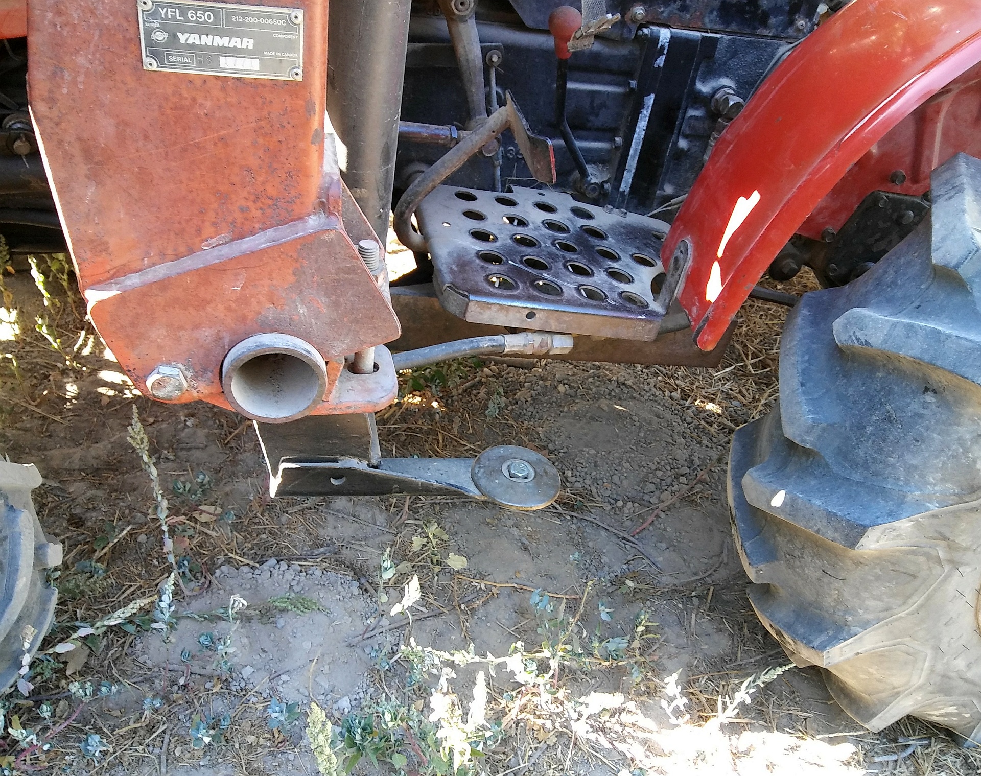

I think those YFL loaders were made in the US Canada! for dealer install, so not necessarily metric seals.
At any rate my local hydraulic shop just glanced at what I brought in and pulled the correct replacements from their back room.
Expand this. YFL650 (on YM186D) tag shows Made In Canada.

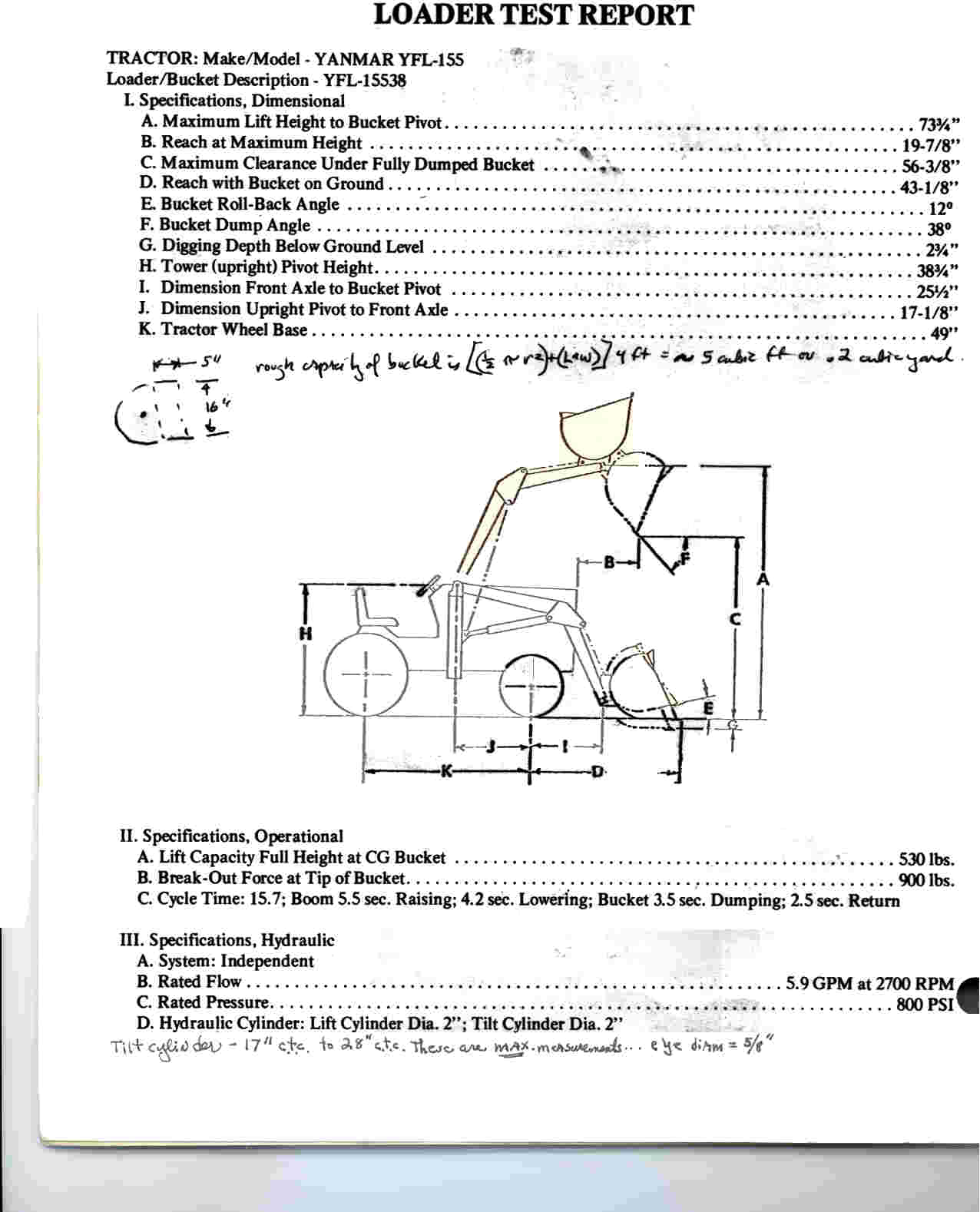

Here are the loader specs for the OEM YFL 155 loader:

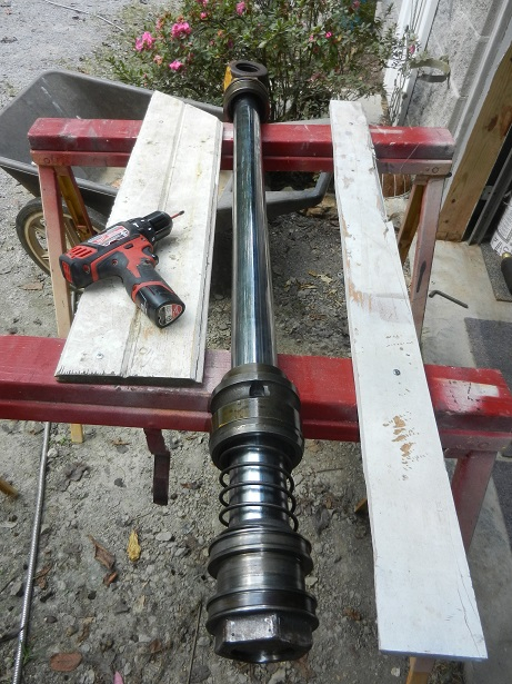

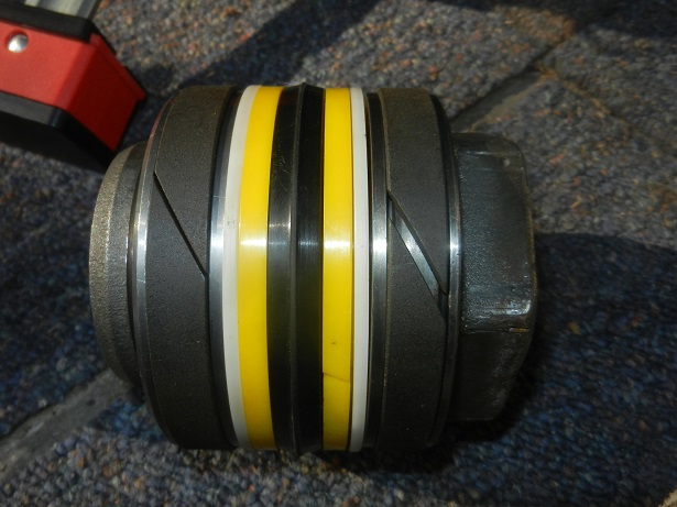

I totally agree. First time I had a cylinder redone (dipperstick on backhoe, the middle cylinder) They charged me OVER $1,000 and I was floored.... they finally dropped it down to $1,000 to "make me a happy customer". (this was the last time I've ever stepped into that place since)
Next time a cylinder needed redone, I knew it's not rocket science, as long as nothing is bent or deeply scored. Since then, I've redone my:
Dump cylinders on loader
Lift cylinders on loader
Boom cylinder (THAT was fun.....NOT, I had to have hoe at downward angle to wiggle it out but, I'm persistent)
Swing cylinders
Stabilizers
Now that I think of it, I've done every cylinder on here since that $1,000. I currently have the rod of the dipperstick in shop to get straightened a bit (they found it, it LOOKS straight) but more importantly, there is a deep nick that goes past seals and it's leaking so they're going to fill in that nick, I can't do that)
Otherwise, cuss like a sailor a couple times and have at it.

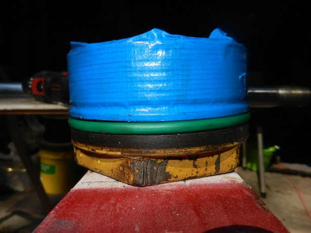

If you screw it up, THEN you can take it to the shop. Just be cautious on where the seals/gaskets go so you can put them back in their respective places. I put blue painters tape over the threads as I installed the O-ring to protect it.

I see "Independent Hydraulic system, 5.7gpm @ 2700, and 800 psi". So a separate pump off the front of the crankshaft?
Yes. When a loader was put onto the YM155, it was offered in basic form with a common "T" block diverter mounted on top of the transmission. I've still got one of those blocks around somewhere & have even seen them on ebay. Powered that way, the loader used the 3pt hydraulics for the basic pressure supply. That works because you normally don't use loader & 3pt at the same time.
Or if the customer wanted, for about an extra $400 - I think - Yanmar offered a separate hydraulic pump driven off the front of thefront crankshaft. Coupling to the front crankshaft was by a double row flex chain coupling. The separate pump also had its own separate hydraulic reservoir in the right side loader upright.
That separate hydraulic pump really made the loader jump. It was actually too powerful for the tractor, but since the YFL155 loader was mounted on its own full length subframe from the front bumper reaching all the way to the rear axle housing....there was no way it could damage the tractor by lifting too much.
