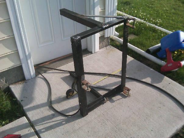

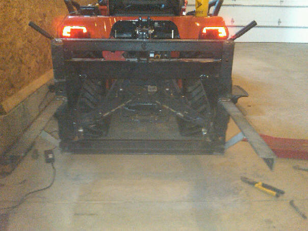

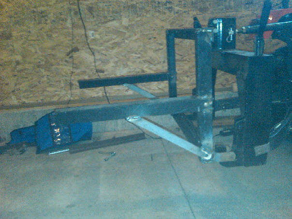

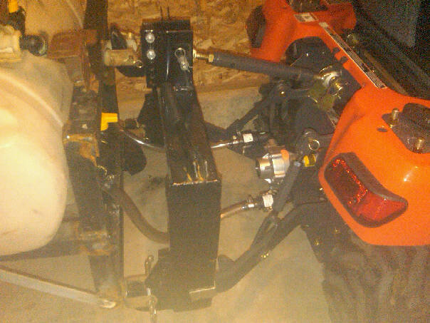

Just a little project of mine. Had some scrap lying around and decided to be constructive for a day instead of the opposite. All it needs now is to finish the plumbing and a good coat of paint. Hopefully the pictures worked.

Looks good so far, I've been wanting to make one of these some day too.
/ Yet Another 3pt Hitch Sprayer #3
Looks like the easy part is done. Keep us posted on the plumbing.
What pump do you plan to use?
What flow control valve are you going to use?

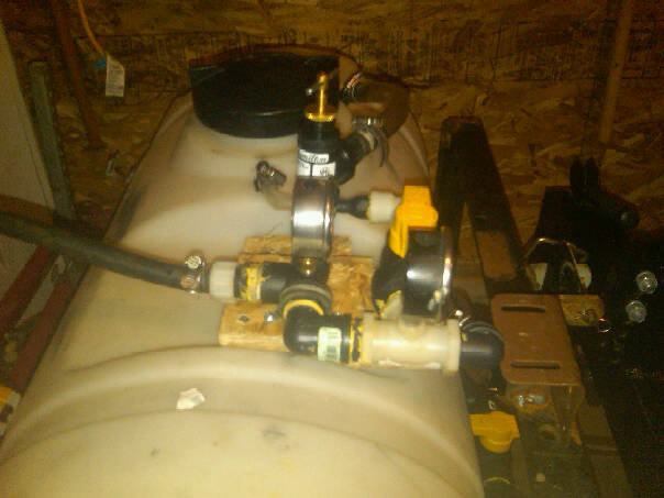

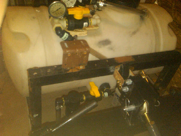

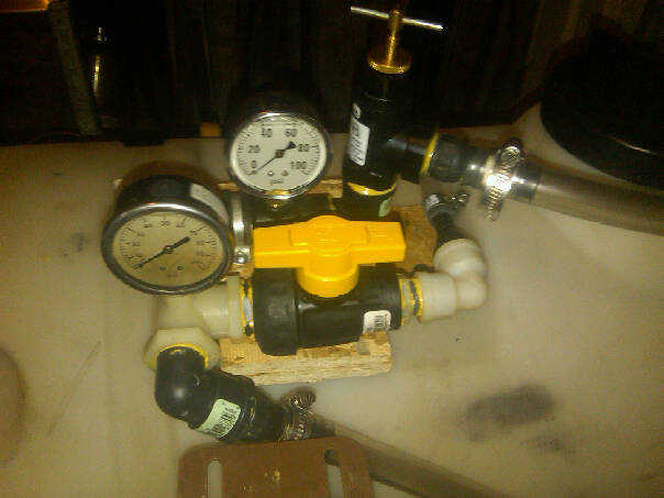

You're right. The easy part is done. There are so many different choices to make from here. I know I am not going to stick with the electric pump. I was thinking of using a 6 roller pump. Not sure about a flow control valve, I thought about making my own wilth ball valves. I know I could get away without using a relief valve but for safety I'm not going to cheap out. Any suggestions are welcome.
/ Yet Another 3pt Hitch Sprayer #5
Good job, but I am wondering does it park easily? What I mean is it looks like by the way it's made it won't sit level if you wanted to unhook it with a full load of material in the tank. Or, did I miss something?? Btw, evil looking black lab in that last picture!!! :)
Good point about parking it. I actually figured that out the hard way yesterday. I since have attached the boom and after spraying I can lower the boom and fold down a stand in the front to park it. The brackets for the boom extend about six inches lower than the nozzles so they are protected when detaching. Keep the good ideas comming. Also that is my great dane puppy. He's only seven months old and weighs about 150. He just had to get in on the picture as it was taking.

Some updates to the sprayer. I finally decided on the plumbing. I followed Tee Jets web site. They have a nice diagram explaining the placement of the pressure relief valve, throttle and the rest of the plumbing. I got the parts from Farm and Fleet and Tractor supply. I went with the 8 roller silver pump off ebay. It was about half the price of Farm and Fleet. I still need to get a hose reel for the wand so for now it's not in the pictures. Also I changed the plumbing a little from these pics. There's no longer 2 gauges and there is two outputs (1 for the boom and 1 for the wand) instead of just one in the pics. I only need to run the pump at 1/4 to 1/2 throttle to keep very sufficient pressure with a lot of agitation. Sorry for the poor quality phone pics. I will get the digital out when I get some more time to work on it.
