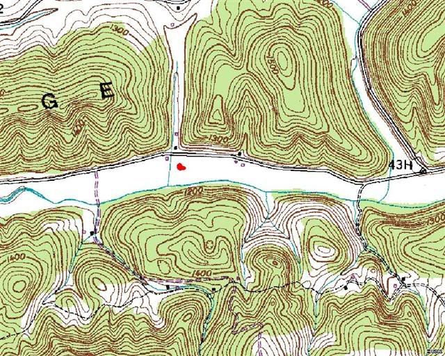

Oh, here is the topo, location of pond in red....gives a visual of the ridges/bottom lands.

From the topo map, it looks king of like a glacier path at one time. Maybe a small one.
The thing that I wonder about is if anything you do will be able to handle those worse case situations? The dam in front has some merrit to it if it's big enough, but then catching enough water to keep the pond full becomes an issue. The culvert idea has me wondering if that's feasable.
Does that creek run year round? How far down would you have to dig the pond to be able to get water from the creek if you installed pipe from the creek to the pond? A one inch pipe, running 24/7 would give you plenty of water, but a 2 inch pipe would give you something like five times as much water, maybe more.
Are you going to stock the pond for fishing? Another option might be to just stock it and expect to have to do so again if and when it floods. The fish are not really that expensive, you just have to wait a year or so for them to get big enough to be worth catching. We were catching one pound channel cats in our small pond in about six months, but we also fed them every day.

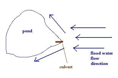

To clarify, the culvert would be on the leading edge of the levee & only be open during normal rainfall & closed to keep all water out during flood stages.

The pictures helps clarify your design, but it brings up another concern. How much rainfal do you get? how much watershed will you get? and most importantly, how much loss to evaporation will you have to deal with?
Both my ponds are filled 100% from runoff when it rains. I have moved thousands of yards of dirt to either create low areas to bring more water to my ponds, or built up road to divert water to my ponds. On a good hard, one inch rain, I can increase the water level in my big pond 3 inches. When I'm done with all my plans for diverting water to that pond, I expect that number to double. My small pond went from 2 inches when I first started doing this, to 6 inches.
Are you going to be able to catch all the rain water that comes down the valley to fill our pond and keep it full?
The deeper the pond, the more you can lose to evaporation. I lose close to a foot a month in the summer. Three months without rain, and it's looking pretty bad. Fortunately, I have 8 to 12 feet of depth, so the fish will be fine if I lose 4 to 6 feet of water. Any more and it's panic time!!!!

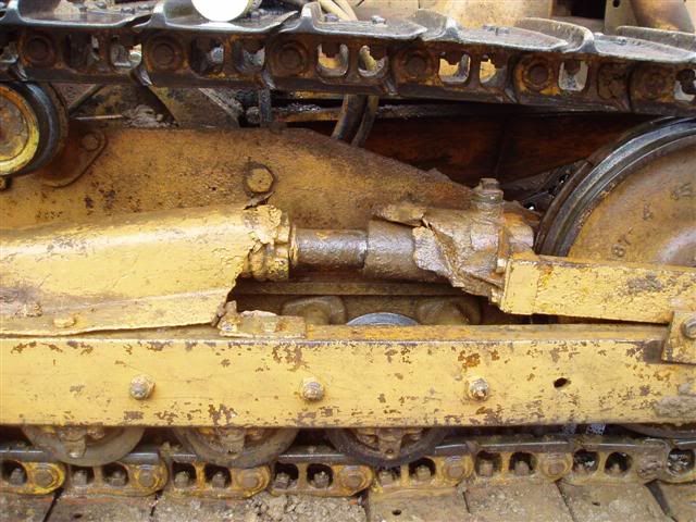

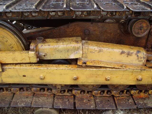

BTW, i got the track cleaned off & Meadow you were right, it is the RH tensioner, more specifically the tensioner housing that has a spring inside. The housing had rusted away allowing the tensioner to buckle which pushed the idler wheel sideways. The LH tensioner also needs some attention, but is not as bad. I called Case for a price on a new spring & housing........$700+ for one side...yikes! I might be able to save it, but the spring is broken, so i'll have to ponder it some. On a good note i only broke off 3 out of 4 bolts holding the housing on.........:)
LH side
RH side
Housing off:
