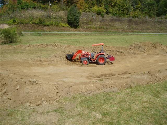

Meadow, you may be right. My area in east TN has a series of ridges 200-1000' tall running east-west. Ridge top to ridge top in some places(mine) are about a mile apart. The ridges are wooded but rocky, so in a steady hard rain that lasts for more than a day or so, the creeks at the bottom of these ridges swells rapidly & overflow their banks. My creek is 35' wide with 7' banks. The water then sheets out over the bottom land pastures that average 100yds wide from of ridge to bottom of ridge. These geographical conditions make for some very powerfull water. We have watched full sized trees roll down the pasture during flood conditions.
Anyway, i figure my options are: to put a levee around the pond, tall enough to prevent most floods from getting into it(kinda like New Orleans). I wanted the in-feed culvert because the pond lays in a natural low spot & i this would take advantage of normal amounts of rainfall. Closing off the culvert before a flood is an option(running out there in the middle of the night to do that may not be). However, since i am planning on a solar panel(s), a pump & float switch to pull water from the creek, i could delete the drainage catch & just levee the pond in isolating it from everything. From an aquaculture point of view i would guess that isolation is the way to go. Either way, the dyke/levee will have to be pretty stout on the flood side & angled to deflect oncomming water.
While i have been blah blah blahing, it has been raining, & my unfinished pond will get a partial "clay bottom water holding capacity test".......
RD

/ Yes, another pond started..... #23
From the topo map, it looks king of like a glacier path at one time. Maybe a small one.
The thing that I wonder about is if anything you do will be able to handle those worse case situations? The dam in front has some merrit to it if it's big enough, but then catching enough water to keep the pond full becomes an issue. The culvert idea has me wondering if that's feasable.
Does that creek run year round? How far down would you have to dig the pond to be able to get water from the creek if you installed pipe from the creek to the pond? A one inch pipe, running 24/7 would give you plenty of water, but a 2 inch pipe would give you something like five times as much water, maybe more.
Are you going to stock the pond for fishing? Another option might be to just stock it and expect to have to do so again if and when it floods. The fish are not really that expensive, you just have to wait a year or so for them to get big enough to be worth catching. We were catching one pound channel cats in our small pond in about six months, but we also fed them every day.

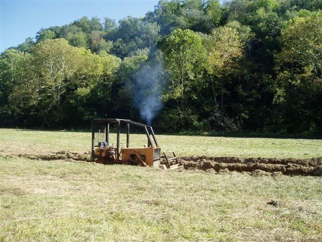

BTW, i got the track cleaned off & Meadow you were right, it is the RH tensioner, more specifically the tensioner housing that has a spring inside. The housing had rusted away allowing the tensioner to buckle which pushed the idler wheel sideways. The LH tensioner also needs some attention, but is not as bad. I called Case for a price on a new spring & housing........$700+ for one side...yikes! I might be able to save it, but the spring is broken, so i'll have to ponder it some. On a good note i only broke off 3 out of 4 bolts holding the housing on.........:)
LH side
RH side
Housing off:

/ Yes, another pond started..... #31
Seven,
What I want to know is how do you keep your dozer so clean? I'd hate for you to see pictures up close of my Case tracks...you wouldn't see much yellow but lots of dirt. :)
