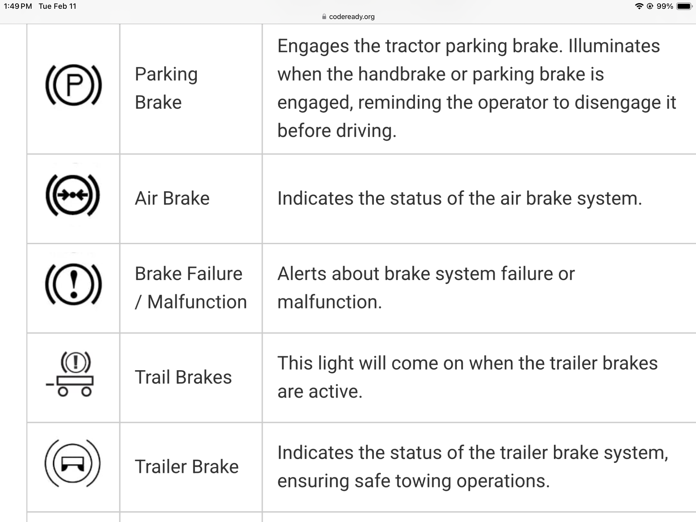

New Holland TN75
We have a New Holland TN75 tractor that is either a 1997 or 1998 . There is a yellow warning light that sometimes comes on when going up a hill. It is a blinking light and just started yesterday. It is a circle with an exclamation point inside with parathesis on the outside of the circle. Can you tell us what this light is for. We lost our manual in a fire in 2023. We just had a new clutch put in this tractor this past summer.

What i see is showing brake system failure. Weird, why when going up hill

No DPF on this tractor. Too old.
The symbol is for the brake fluid reservoir indicating that the fluid is low. It is probably on the cusp and going up/down a hill is causing it to flash.
Use NH brake oil, NOT brake fluid.
