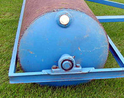

Bearings eh?
Nope, not on mine. I friend and I put it together in about 2 hours. I had a 40 gallon water tank that we cut all the fittings off of. Patched the holes with sheet metal and brazing rod. Welded a large nut to one end and then blew the center out with a torch to serve as a filler hole. We welded two pieces of 1" round bar, each about 8" long to each end of the tank. The towing frame was made out of old 1.5" tubing that was lying around. We welded to short lengths of 1" ID tubing to the ends to fit over the bar stock. Shot about 3 seconds worth of WD40 between the bar and the tube to eliminate squeaking.
Not the prettiest thing but we only see it once a year and it does indeed make the lawn more flat.

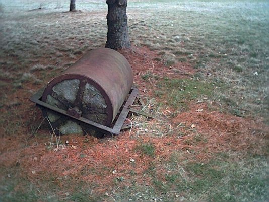

Paul,
That's real similar to the last one I saw made. They used a small steel drum (30 gallon?) and used a pice of 2" steel pipe the same length as the drum. This pipe was placed in the center of the drum and holes were made top and bottom for it. The drum was then filled with cement. A c-shaped arrangement was made of 1" pipe and it fit around the ends of the drum, with the ends of the c fitting into the open 2" pipe. This created a (loose and kinda sloppy) axle, and a handle attached to the center of the c allowed the whole unit to be pulled or pushed.

</font><font color="blue" class="small">( They used a small steel drum (30 gallon?) and used a pice of 2" steel pipe the same length as the drum. )</font>
Ok I have heard of people using the 30 and 55 gallon drums and even a culvert. But each of these items have the grooves in them. My thinking is that is ok, in fact the culvert might do the best job because of the grooves but was told that they don't work so good. Any comments for the groove department.
