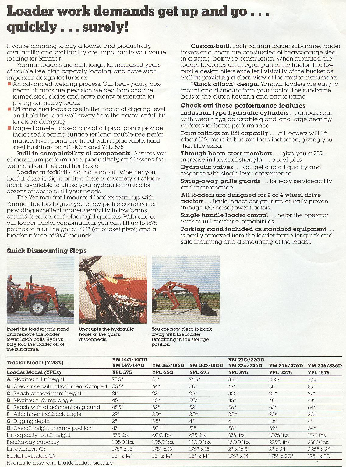

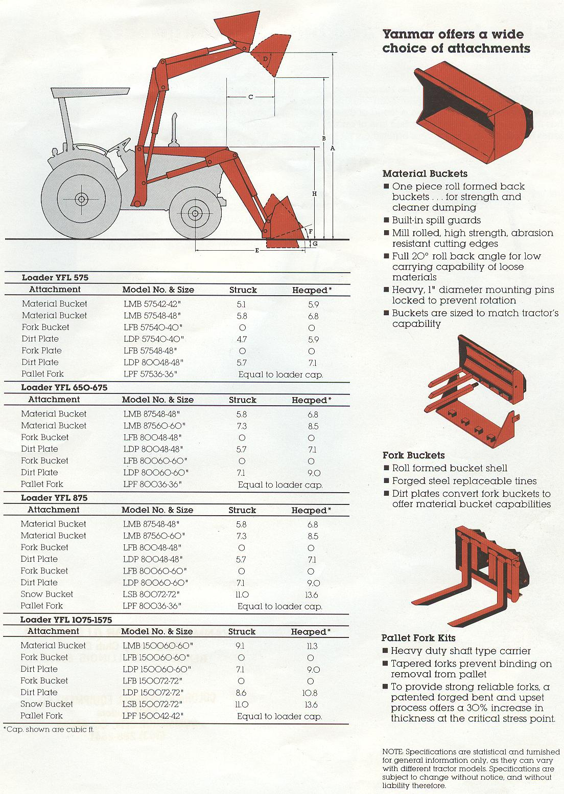

YFL1075 fits a YM276 tractor
Have you reached out to Yanmar USA Parts and Service?
I've attached all I know about these ....
