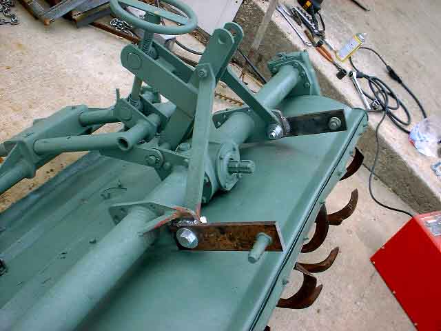

It isn't as simple as just moving the arms in. The hitch pins on the tiller are set back further on the tiller. Many times when you hook an American brand tractor to a grey market tiller the tires will rub the front of the tiller body. I usually remove the lift pins, install 6 inch extensions, and then replace the pins. See my attached picture.

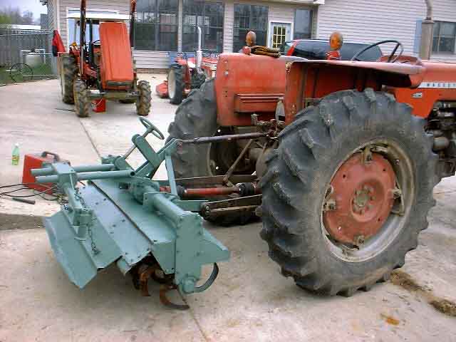

Here is another picture.

I Like thos big mf tractors... they were mf right?

I can attest to that problem. My yanmar is down for a head gasket and my neighbor tried to help me till my garden. He has a Ford 801 and the rear tires rubbed the tiller when he tried to lift it, Bre3tt's solution would have worked.

Yes that is a Massey. I think it was an MF150.
