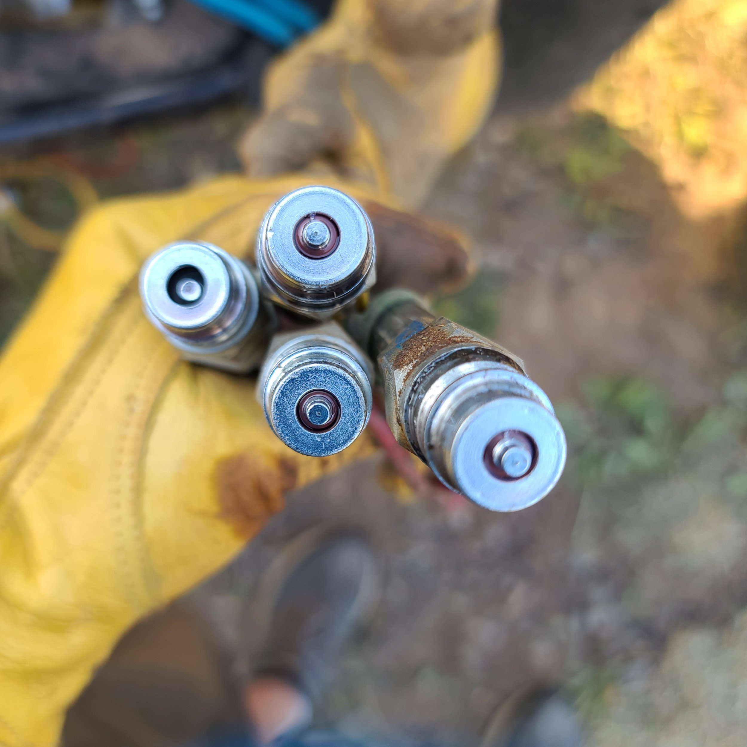

I had same problem today. Was working fine and suddenly wouldn't lift. First I checked the usual stuff, anything bent, broken, missing, leaking, crimped lines. No obvious problems. My mind went to valve body immediately. But bucket curl up and down worked fine, and loader goes down fine and lifts tractor front end off the ground. Loader was slow to lift to lower tractor front end back to ground. I had set parking brake and left it in gear. Once I placed it in neutral and released brake tractor would lift front loader and lower tractor back to the ground fast due to it's own weight. Engine bogs a little and you can hear pump strain when you try to raise front loader. This tells me everything is fine. Only thing left to check was quick disconnects. The blue one was visibly bad once disconnected but not before.
   / Yanmar loader won't lift ??? #12
I had same problem today. Was working fine and suddenly wouldn't lift. First I checked the usual stuff, anything bent, broken, missing, leaking, crimped lines. No obvious problems. My mind went to valve body immediately. But bucket curl up and down worked fine, and loader goes down fine and lifts tractor front end off the ground. Loader was slow to lift to lower tractor front end back to ground. I had set parking brake and left it in gear. Once I placed it in neutral and released brake tractor would lift front loader and lower tractor back to the ground fast due to it's own weight. Engine bogs a little and you can hear pump strain when you try to raise front loader. This tells me everything is fine. Only thing left to check was quick disconnects. The blue one was visibly bad once disconnected but not before.View attachment 699691
Meant to add troubleshooting guide in owner's manual is useless. No mention of quick disconnects at all.
