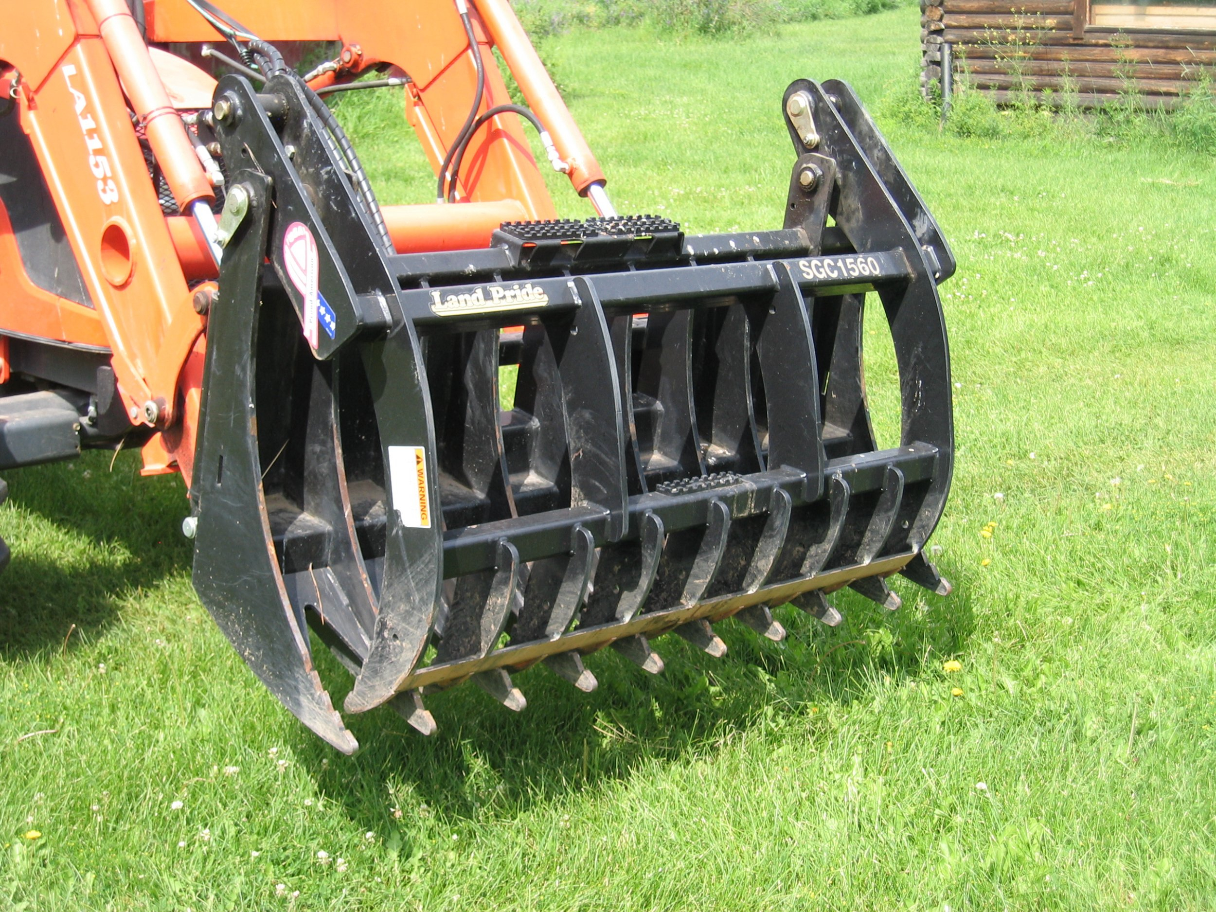

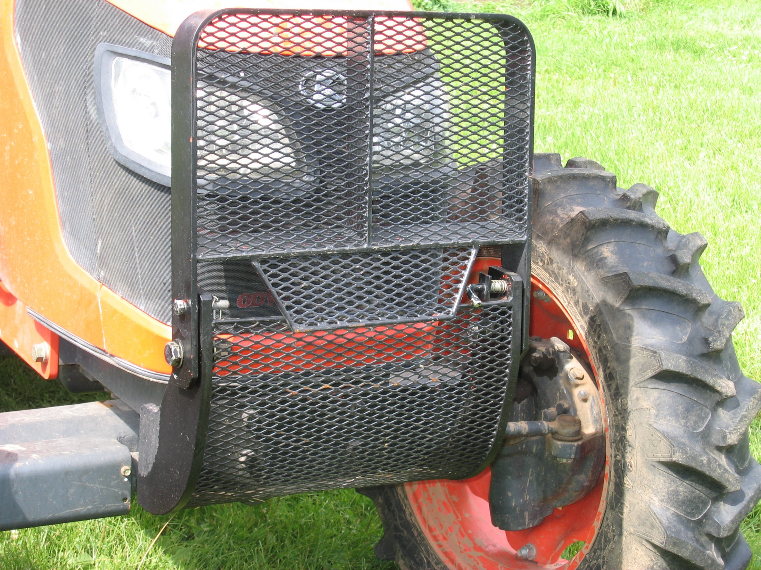

Welcome to TBN and the forum. If somebody doesn't come along - you will just have to call those that you like and ask about compatibility. Just to keep your heart pumping - this is what I have. Land Pride SGC 1560 grapple - WR Long 3rd function valve - modified OEM grill guard.

I've found that Land Pride makes consistently good products. And they will, usually, have a type and size to fit most any tractor. I had the local Kubota dealer instal the 3rd function and grapple - seven years ago.
The grapple has remained on the FEL and I've never had a reason to go back to the bucket.
