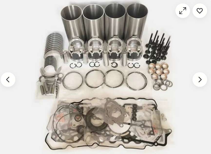

I did a search on the internet and there appears to be complete rebuild kits that you can purchase. It would include pistons, rings, wrist pins, cylinder liners, main and rod bearings, gaskets etc. It would probably be cheaper than sourcing individual John Deere parts, These parts are a matched set as far as the piston, rings, wrist pin and cylinder liner are concerned. How the rod and main bearing match up needs to be investigated.

Indeed go with a full rebuild kit. You will need to determine if oversize is needed.
If it did and the prior owner had aftermarket sleeves/liners placed in the engine, then yes, the OE rings would have an issue.
It is always best to buy a full matching rebuild kit. From a Yanmar reseller, you typically save 1/3 the cost vs going to Deere.
Overhaul Rebuild Kit for John Deere 4TNE84 Tractor 990 4500 4510 4600 4610 4020D

Thanks again to all for the replies. Again, these are all assumptions, but the overall condition of the tractor bordered on poor, so my assumption is that it came from some government entity. And I really doubt it had been apart. I am going to get a complete rebuild kit when I get it torn down. I was just stumped as to why the rings didn't fit.
