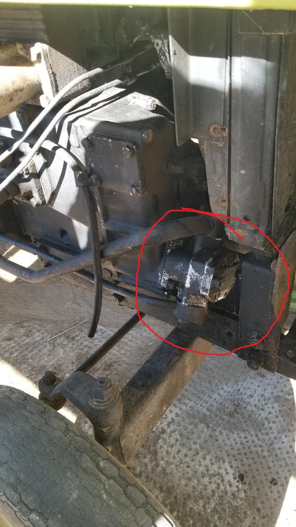

It is one of the hydraulic pumps. At least that's on my 240D what it is. Not that I want to burden you with teaching rScotty but I would be interested in knowing the difference in O rings between OEM and a USA replacement. If would never have occurred to me there would be one. Thanks but again, only if you have time and feel inclined to explain.
   / Yanmar 240 What is This? #12
Hmm....Which pump do you think it is? Engine oil or hydraulic fluid?

The cover with the 2 allen bolts are leaking. it is the part above front axel that is painted Gloss black with the paint coming off and some kind of rubber round boot on the bottom.View attachment 683343View attachment 683344
It looks like it going to be a tough one. All aftermarket pumps switch over to a different cover with 4 bolts.

I think that cover may have 6 bolts, 4 being recessed.
   / Yanmar 240 What is This? #15
Winston, that's what I was thinking too. That's what the exploded diagram that you posted seems to show. And there are 6 listed on the parts count.
Where did we get into aftermarket pumps and different bolts? This should be a straighforward fix. I'd say "easy", but nothing old ever is.

Thank you everyone! Now it just a question do I want to do It. you guys have made some good posts. It is a very slow drip.
   / Yanmar 240 What is This? #18
Dan0, Listen to the other guys more than me but if you didn't discern it when you check engine and hydraulic oil levels I'd keep an eye on it and the levels and leave things be. Sounds like it could be more seepage than leak. Sometimes getting into these things causes other problems.
