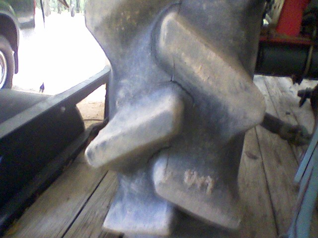

If the rear tires are cracking they will only going to get worse and then Tubes. I was able to get tire liners for mine. From Gempler. For a 2wd 2000.. I have the Org. Bridgestone which are Mud tires. With the High lugs I'll never were them out and I came within a few hundred Hrs. to rolling the Tach. over since I've owned it. You can see the Pic.. It's Gray as it can be also. A new filter would be almost a must to me. If you have a NAPA close here is the fuel Filter #3262. I also found the tire guard #9DR7 Tire reliner.

If the rear tires are cracking they will only going to get worse and then Tubes. I was able to get tire liners for mine. From Gempler. For a 2wd 2000.. I have the Org. Bridgestone which are Mud tires. With the High lugs I'll never were them out and I came within a few hundred Hrs. to rolling the Tach. over since I've owned it. You can see the Pic.. It's Gray as it can be also. A new filter would be almost a must to me. If you have a NAPA close here is the Filter #3262.
