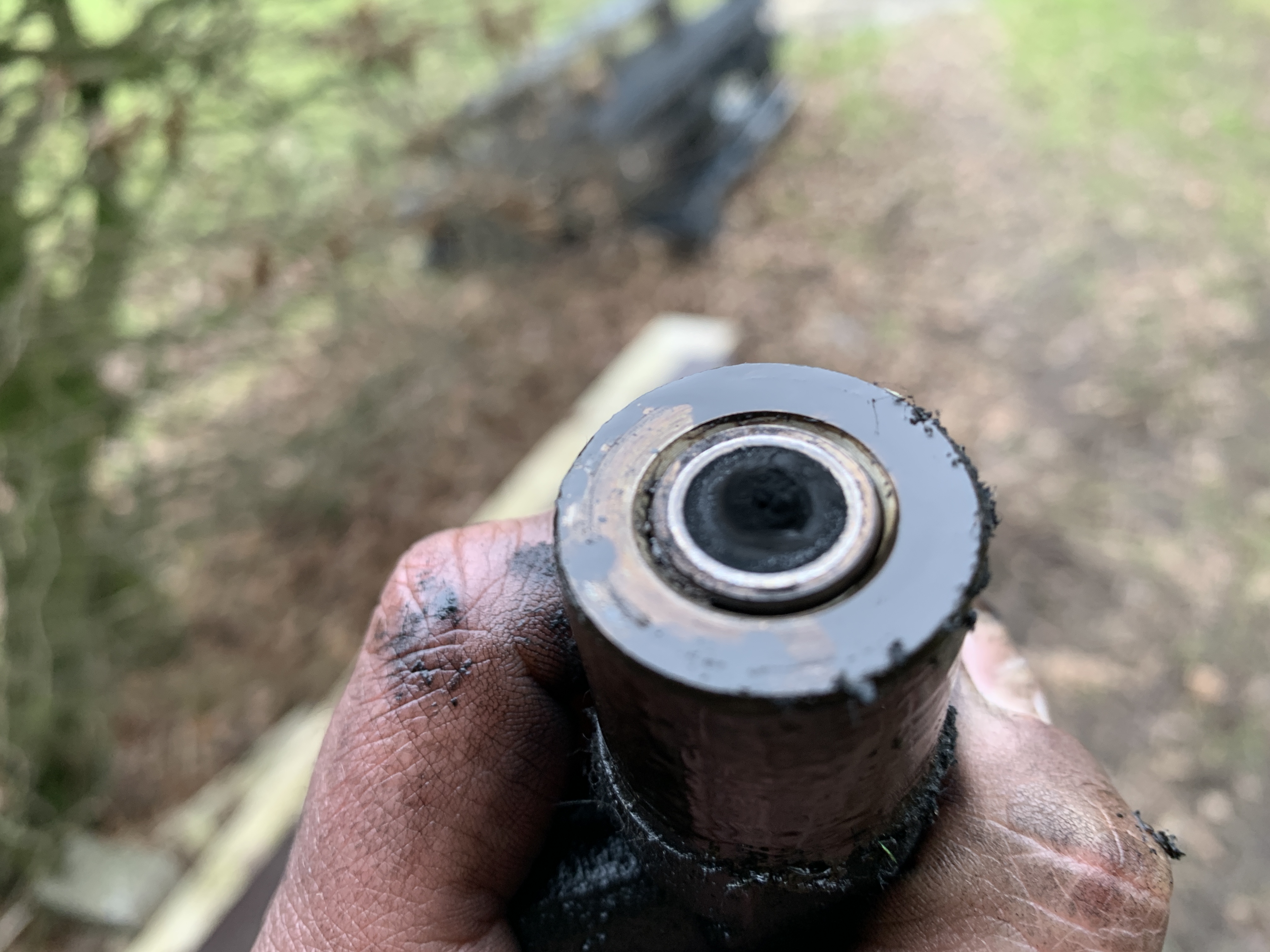

Today checked the valves, two of them had way more space compared to 0.20 as specified, adjusted them.
Also got all the injectors out, very easy, so I guess Im mister lucky here :)
One of the bolts was already loose...hmm....not good :(
The hardest part was to move the second fuel line out of the injector since there is a little too less space if you want to leave the air intake manifold on.
They all look like this:
What do you guys think, dirty, very dirty or ..... :) :)
Also checked the spray patterns, the way the diesel sprayed out, oh boy you cannot call that a pattern at all :)
Because the tractor is in use these days I put them back and will clean them later.
However the tractor started much better already, so I guess the loose injector made a compression leak.
Any tips on cleaning the injectors?

How much more than 0.2mm? Generally, it can be twice that and still no problems with starting or low speed running. A little too much valve stem clearance just retards the injection timing a bit which tends to make them run a bit sooty.
The injectors don't look bad to me, but not sure what you can tell by looking. I've never rebuilt a set and always wanted to. I've heard there are kits available but would be very careful and maybe just use wood to scrape. The needle valve part has to be delicate. I wonder if marine Yanmar engines use the same injectors?
Only other hint is to be careful when doing a spray pattern. Several thousand PSI spray WILL penetrate skin, and can blind you. The infection that follows high pressure injection through the skin - even in the hands - has reportedly killed people.

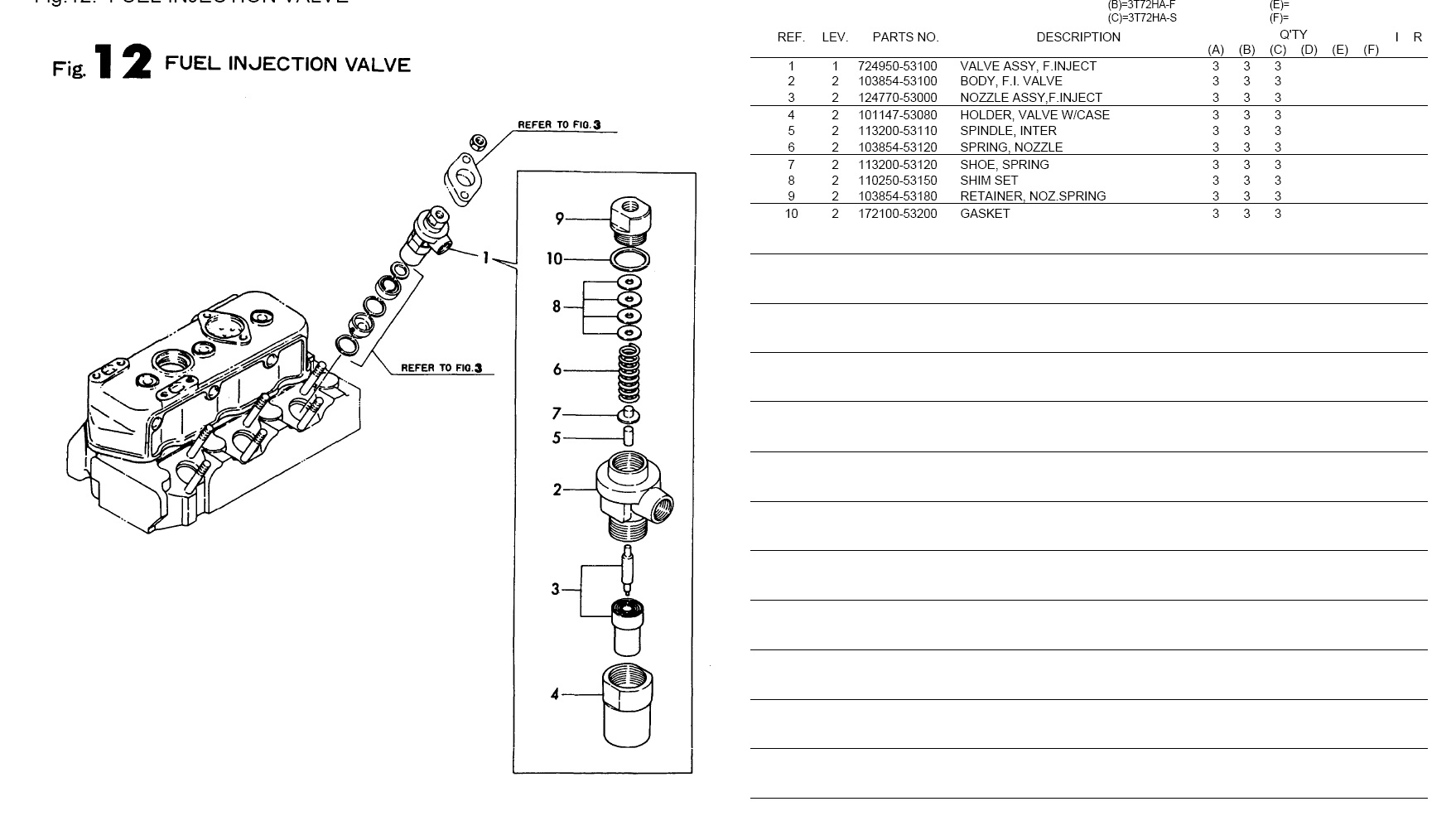

With the metal parts, an ultrasonic parts cleaner and Seafoam is how I've done it for years. Seafoam works well on diesel and as a cleaner for the fuel system. I've let the parts sit in for 15~20 mins at a time. IF it still looked nasty, more time was needed. When doing this, ideally outside and fresh air is best. An open garage or on the front porch has worked for me. Just keep away from the pets.
From the YM186 Parts Manual on pg 33, it shows a nice exploded diagram view of how it goes together. Wish it mentioned the torque requirements to put it all back together.
