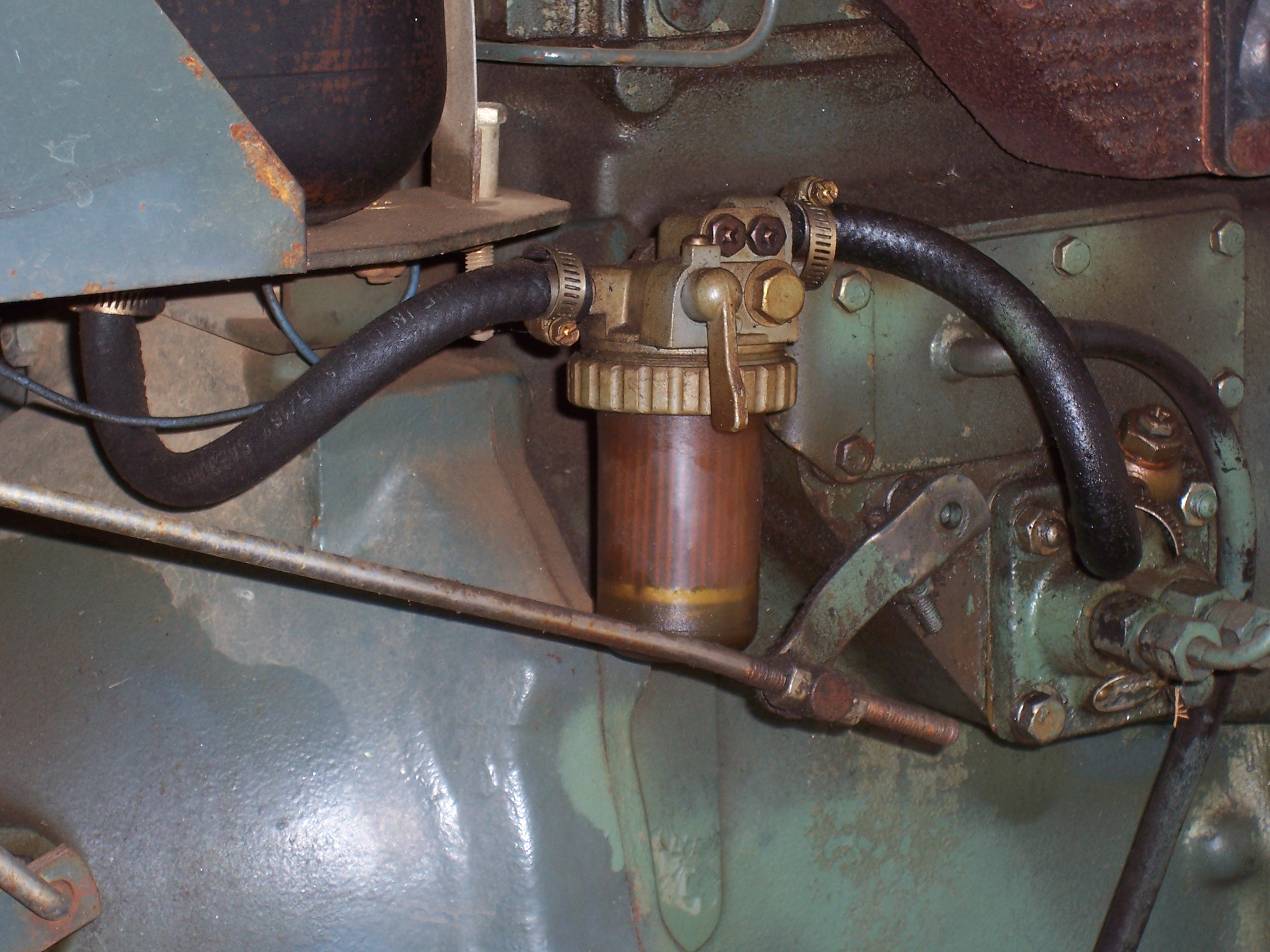

Have you had the injector pump apart?
Yes because when i bought the tractor was stuck , the rack wasn't moving, i took it out and fix the problem and now its pumping both sides also when i move the throttle level rpms go high or low meaning its working. At first try i put the plungers upside down and the tractor was very high on idle and the governor wasn't doing nothing. I took it apart again flip the plungers and then now a can regulate the idle but keep smoking. I will record a video to show you.

That is the way it's supposed to work. So your regulating fuel to the Inj's. and Cylinders. Compression, Overheating, Bad fuel ? I did notice how much Idle is being used on the Throttle shaft Adj. compared to mine. Mines 1/4 on the AdJ. and your all the way open. That's a indication how much fuel it's taking to just keep it running. just looking at the Pic..
Can you take a picture to see what are you talking about?
   / Yanmar 1700 smoking and loss of power #18
Your throttle arm Adj.. Your set at the Max. adj.. Your pumping fuel and getting to a Cylinder since it's running. Low compression? The Injector Spray? Bad fuel? Check those potential problems and move you Throttle arm Adj. back. My guess is Your set at Full throttle and possibly moving the Throttle arm to far forward causing a problem. I'm only going by the pics. so I could be wrong. Check the position of the set pin. I can't see your set Pin on the Throttle shaft. If it's even There ? look hard on mine and your see the pin through the shaft
