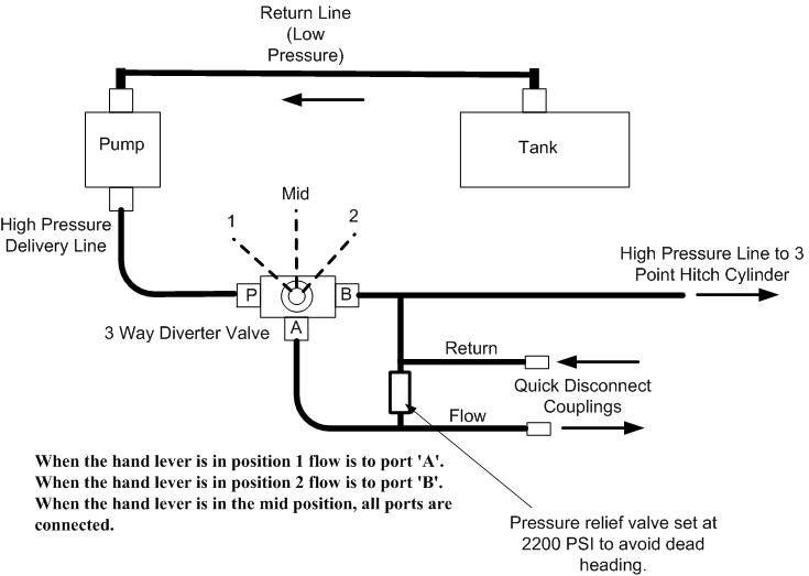

Just had another brainwave (dangerous I know) irrespective if the log splitter is a goer or not I am going to plumb in the hydraulic lines to a pair of quick release couplings, Ive attached a schematic of an idea to use a 3 way diverter valve instead of a spool valve, I'm hoping the T connection into the high pressure line to the 3 point hitch will not cause any flow/turbulence issues and the pressure relief valve is in the right place.
If any hydraulic wizards can take a view I would be much obliged.
I reckon it will work but here is a couple of things to consider. If you switch to position 1 with nothing hooked up to quick disconnects your relief valve is going to have to take care of all pump flow. Also, if you are in the mid position and your 3 point handle is in the down position you will get no pressure on your quick disconnects. Also, in position 3 you will be pressuring up the return side of the quick disconnects when using 3 point lift. Won't hurt anything, just an observation. I'm not a hydraulic wizard so my thinking may be wrong, that is just what I see.
I don't know about the pump rpm either but here are some numbers to ponder. Based on assumption the pump is a 1:1 ratio running at 2400rpm you would put out 2.54 gpms. To get 3gpms you would have to run 2840 rpm.

Sounds like you are over-analyzing this thing. If this is the splitter in question, (open center), I would just plumb it the way Hoye shows and be done with it.

All good points Winston and it looks like the spool valve is favorite, I'm just so tight I like to think I saved some cash, any idea's as to which manufacturers valves are the most cost effective? Horrendous prices in Europe though I have noted that nearly all the UK ebay sales for hydraulics are from the US with corresponding high freight charges.
