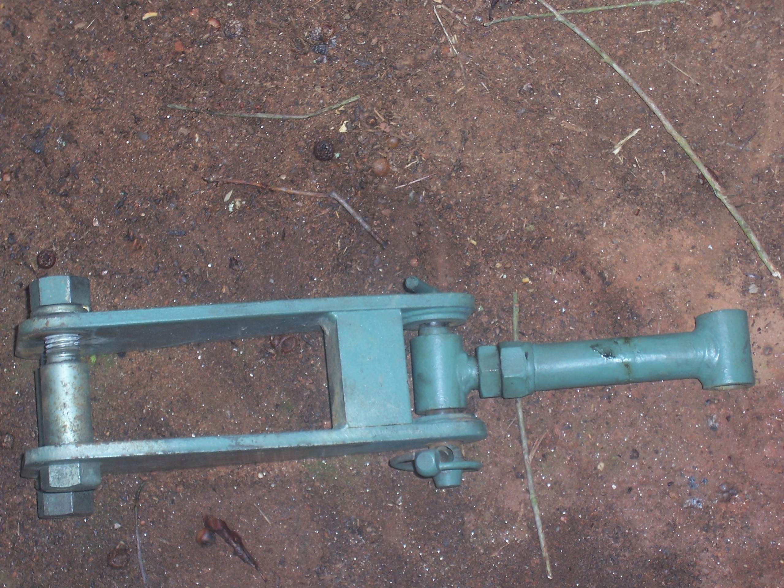

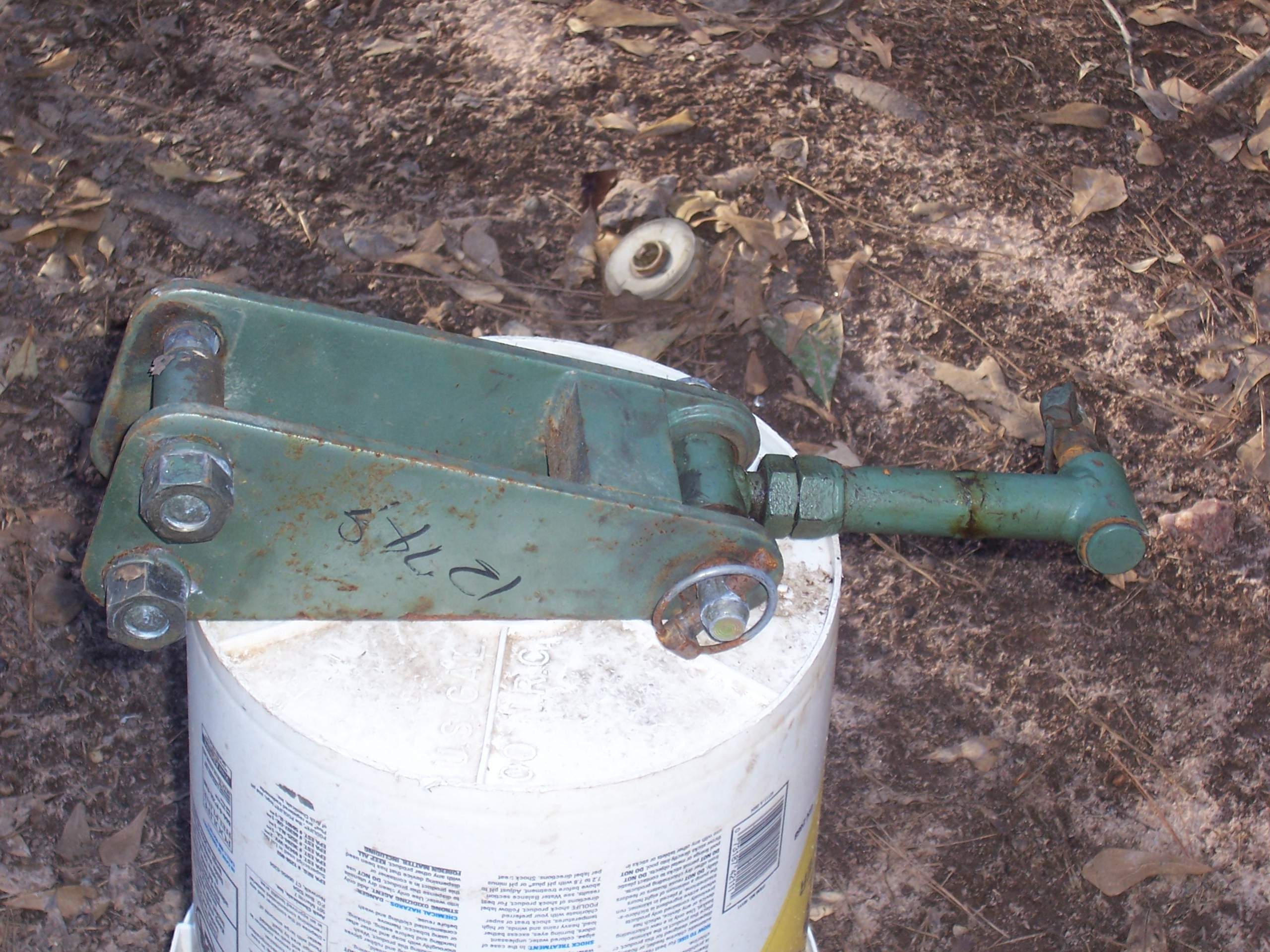

Worst case you can make it. Not that much to it. I had these pics. out not that long ago I had trouble myself Cal. finding them again. Dang Half Timers getting better though;)
These are for my 1400 I use on a 2000

Thanks Carey the pictures are helpful in case I need to find one of these. I printed one out to take with me just in case the guy remembers seeing it.

Carey I just learned something looking at your picture. My upper link came with standard 3-point pins to attach to the tractor. The attachment goes on with some slack that I assumed could cause wear. I see bolts and spacers with yours. I'm sure now that is how it should be attached, to avoid wear. I'll do mine that way next time I use it.
Rmully the lack of that link isn't a deal-stopper. Depending on your tire size, there might not be any conflict. Or you can fabricate some kind of workaround. Possibly, (I haven't tried this!), a Quick Hitch plus a PTO extender ($20) or slip clutch ($70??) would move the tiller back far enough to solve the tire interference.
I don't think you can simply lengthen a standard upper link because the tractor and tiller's pto shafts need to be parallel (not straight line, just parallel) when you are pushing the full 20 horsepower to the tiller. When the shafts aren't parallel, I think the tiller is forced to run faster/slower with each revolution of the shaft which is obviously a big and unnecessary increase of stress.
Mine has the bolts and spacers too Cali. I think that was the intended attachment. Whoever had yours before you probably just took the faster way out of mounting it.

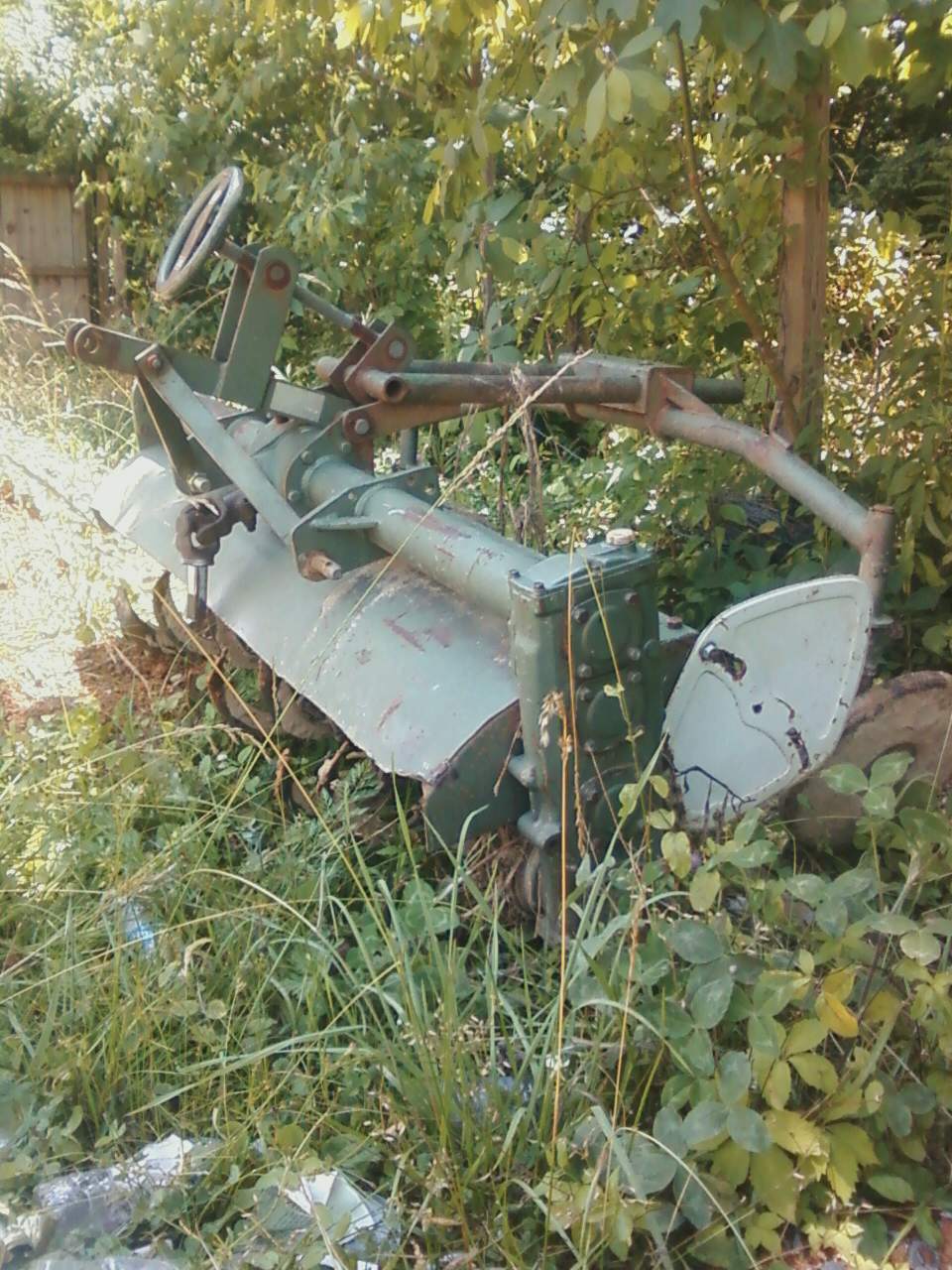

Here are a few pictures of the beast.

Mine came with those also. I believe I said TALKING ABOUT CHEAP and didn't like the setup either Pos. falling out or care for the movement either. Easy fix just ran into the Nut and Bolt box and had it all in my Junk. Some things you learn to keep around you never know when you will need it and with the lock washers I felt alot better about it :cool:
Oops! Based on this thread I just now went out in the barn and discovered those bolt/spacer components in my toolbox of miscellaneous spare 3-point parts. I've had them all along but didn't use them for my first trial run of the tiller (shown in this old post) so they got mis-filed. I learn something new all the time reading these threads. Thanks Inspector!
Rmully I see yours includes the 'trainer wheels' for the back. If you don't want those I'll buy then from you. :D
I've been told this was one of the last models to have those wheels and they aren't essential, so most of the tillers shipped over with the VN 'rebuilts' arrived without them. I've been looking for a pair. That is just what I need to control depth if I use the tiller with my smaller tractor, which can't really till full depth on the first pass.
Does anybody have those RS1400 wheels and is willing to sell them?
