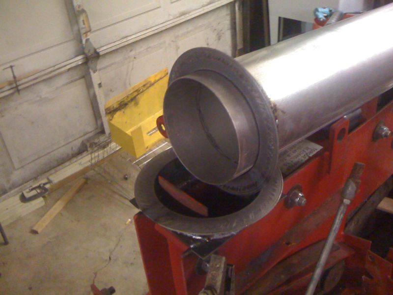

I will be interested to see if the Jinma makes enough air to clear the chips out of a six inch chute, that is a lot more cross-sectional area than the OEM chute.
Yup ... that was a concern I had when making the decision about what size tube to use.
I elected to go with 6" tube and flanges because it completely contained/captured/enclosed the outlet area of the disc housing ...
If I had gone with 5" tube immediately, it would have introduced a restriction into the chip discharge path, as the diagonal measurement of the outlet on the disc housing was over 5 1/2" IIRC ...
I did notice while I was down Cross Truck that they had some 6" to 5" reducers in stock ... so modifying this setup to drop to 5" immediately after the flanges would be pretty easy.
Personally, I don't think it's going to be an issue ... but I certainly could be wrong. I can dimly recall getting into the chip path close to the end of the discharge chute while they were coming out and it seems to me - IIRC - it was rather uncomfortable (pain) ... more like the chips were being thrown with considerable force ... rather than blown ... although I'm sure that air/blowing plays a part.
One thing I have some attention on is the transition from the 6" round tube down into the original stock rectangular discharge chute. I want to make sure that it is pretty smooth ... with no rough edges that might catch chips or slow them down. That transition will probably have to occur over a fairly short distance because I can only reach down into the tube so far and still work effectively.

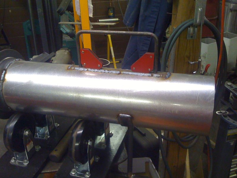

Got another 2" of 3 x 2 tube welded in on the top link mount so it should be fully quick-hitch compatible. Then added some angle for a mounting frame for a storage basket:

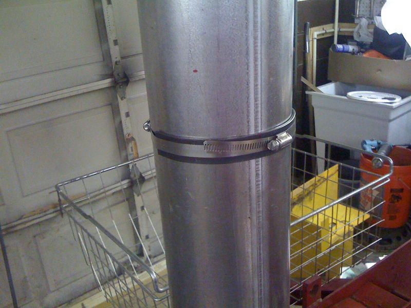

Basket was scavenged from an old upright freezer that gave up the ghost:

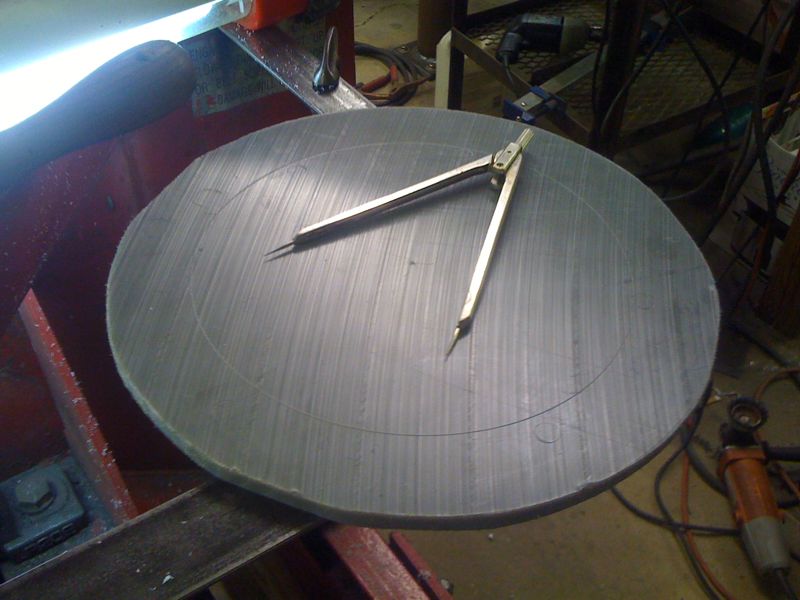

12' x 12" x 1/4" sheet of oil-filled UHMW polyethylene from McMaster for the chute rotation bearing ... it's got so much oil in it that when you touch it leaves a sheen on your fingers ... lol:

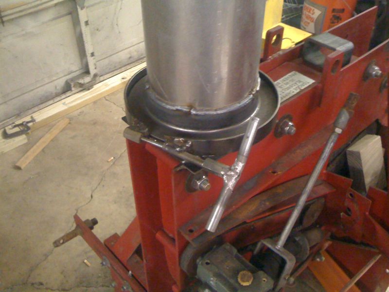

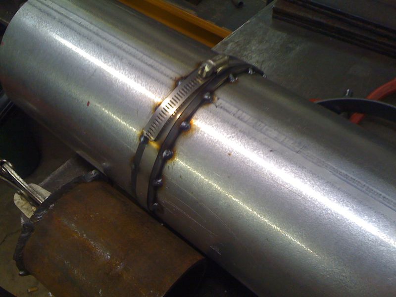

Drilled 2 holes in the basket mount angle for the basket clamps, also drilled a 3rd hole in the 3 x 2 tube. Since the 3 x 2 will capped, I went ahead and tapped that hole with a 1/4 coarse thread tap.
Took the side panels for the base and drilled 5 holes in each and then swapped the panels, mounting each on the opposite side so that the angle and the holes were outboard where they were accessible. Used the holes to run some 1/4" tapcons into the 4 x 6 x 48 skids to secure the skids to the chipper. The skids should eliminate the tendency for the chipper to tip over towards the back.

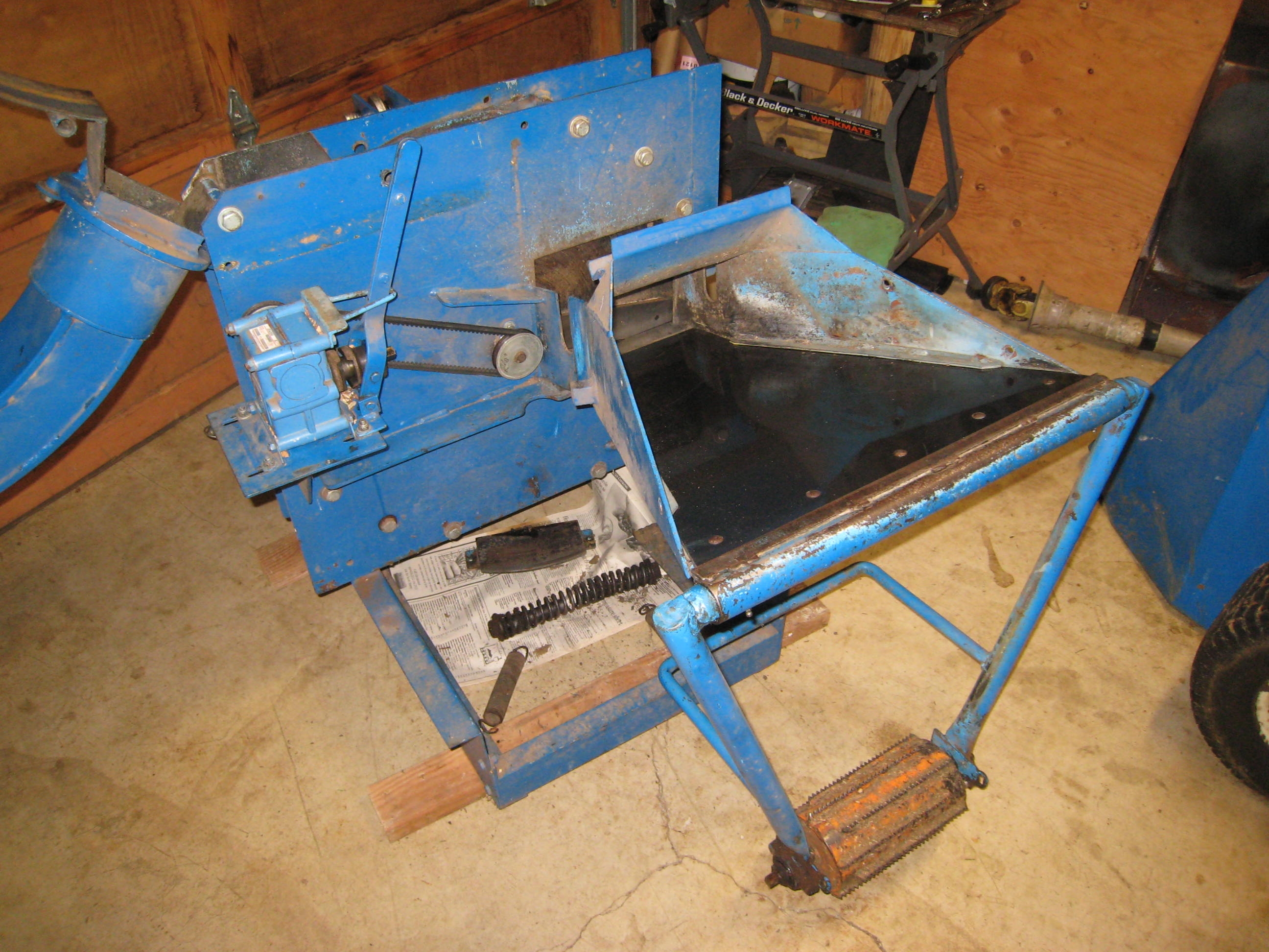

Got the feed roller lift/pivot converted over to foot-operated.
Cut two 10" pieces of (I think) 1" Schedule 80 pipe and welded them to the ends of the feed roller pivot arms @ a 45 degree angle. Then took the handle that I cut off of the forward portion of the feed roller pivot arms and used the O/A torch to heat it and bend it (in 4 places) to fit into the pipe I had welded on.
Also cut the rear portion of the feed chute apart and the modified the mounting tabs so that the rear side panels would be parallel to those on the front portion of the chute. This will require adding some additional metal to the bottom panel to accommodate the increased width:
Hopefully this last mod will allow the chipper to pull material in a little easier.

Cut out the plastic bearing for the rotating chute last night.
I measured the bottom flange and then scribed a line using a set of dividers, sizing the O.D. of the bearing slightly less than the OD of the flange, and the I.D. of the bearing slightly more than the I.D. of the flange:
/ YAJCMT: Yet Another Jinma Chipper Modification Thread
#33
Initially I tried cutting the oil-filled UHMW polyethylene with the Sawzall. This didn't work so well ... mainly because the teeth on the blade were facing the wrong direction, pulling the plastic upwards, leaving "fuzz" and obscuring the scribed line. And because it didn't take much to make the plastic ... smoke ... :eek:
So I tied a jig saw blade in a pair of Vise Grips (I don't own a jig saw ... but I do have some blades :D) ... not really workable since the blade wouldn't stay in without cocking ...
I finally settled on a fine tooth hacksaw blade, which I hand held. It didn't take too much of that torture on my index finger before I donned an old welding glove.
This was very time consuming (1/2 hour or more ?) to cut the O.D. ... but I was able to follow the scribe mark pretty closely and the kerf was small:

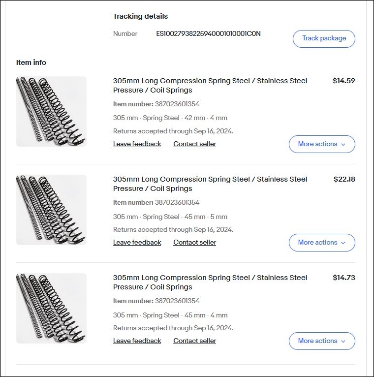

The feeder drive shaft spring finally broke on mine and I was able to buy very similar but little weaker spring on the eBay, however I am interested to ask little more details on how you repaired the feeder drive shaft in your Jinma chipper:
Did you reuse the rest of the original drive shaft and just refitted it with (welded on) new 1/2" impact universal joints?
Did you reuse the original spring?
Any help would be appreciated by you or anyone else who may have dealt with the same issue.

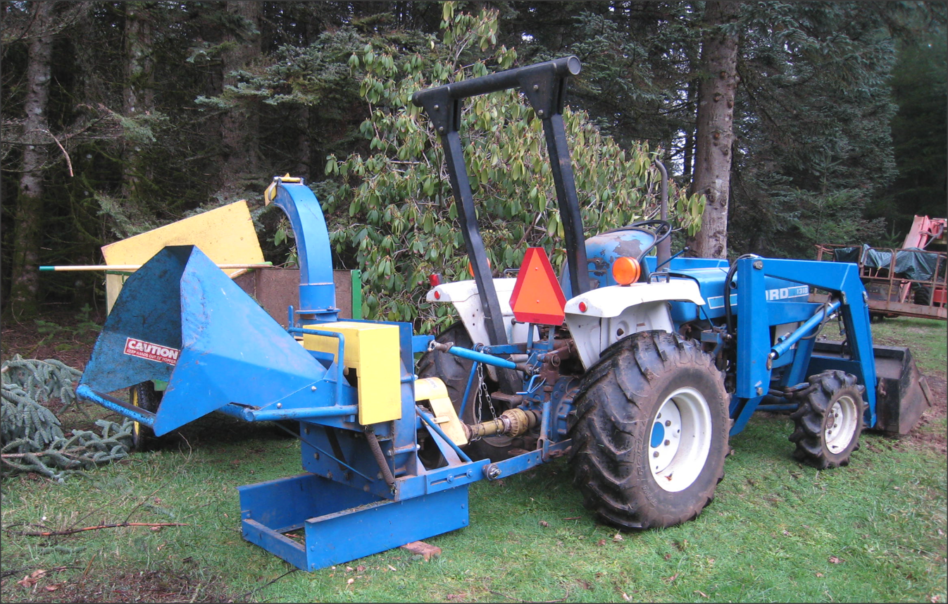

Here is my S&R chipper:
